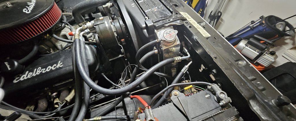

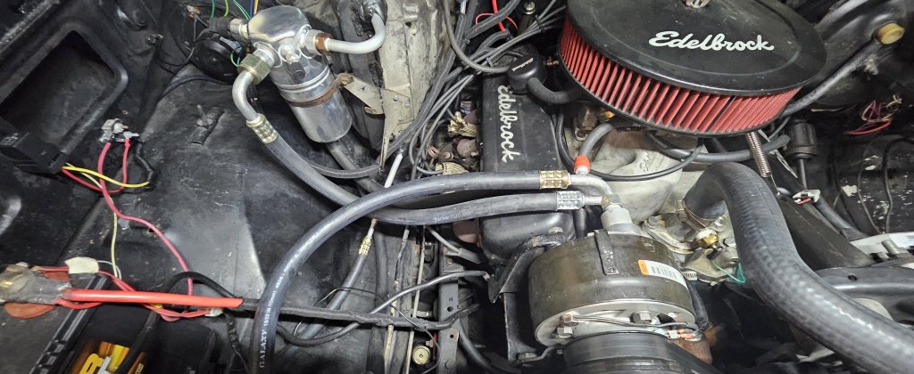

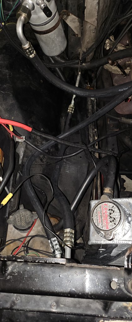

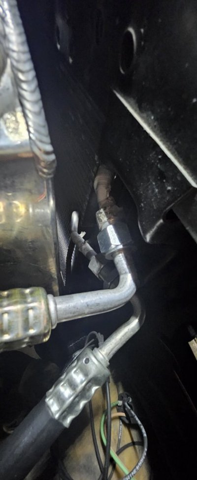

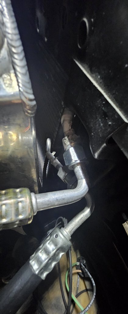

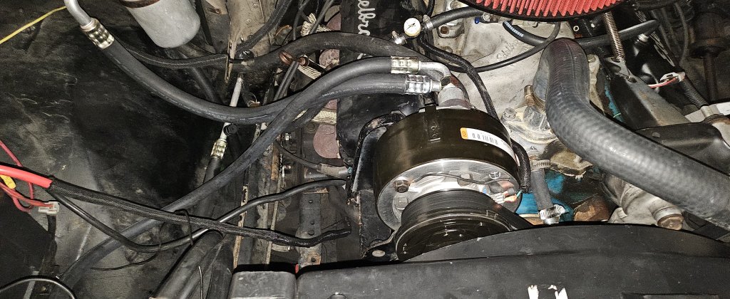

Also, pictures of the truck for your enjoyment and of my AC lines as well I made. I'm not much of a picture takes so please excuse my poor pictures.
If anyone can help, that would be awesome. Been working on this over the past couple weeks off and on and at this point, I'm out of my knowledge realm.

Did your truck originally have the large A6 compressor mounted on the driver's side? I had that on my '75 and they were infamous for internal failure and "Black Death" (actually granules of black material) that contaminated the entire system. IIRC, the R-12 charge for my original system with the A6 was 3 lbs, 12 oz, so about 60 oz. I assume that means the correct R134 charge would be around 45 oz.
I made a similar conversion (complete flush, Ford blue orifice, new accumulator, pag oil, etc.) for my '75, except I switched to a Vintage Air Sanden compressor and brackets. I flushed the evaporator and replaced the condenser with a new parallel flow. I had new lines made with the right threads and seals for the new condenser and Sanden compressor.
I charged with R134 at a level of about 75% (that was about 40-42 oz) of what was recommended for R-12, and then tried tweaking it by adding a little more from there. During my later troubleshooting I also found that the high pressure cutoff switch I had added was leaking. I didn't find that leak until I added a little UV dye. Keeping track of the pag oil amount was difficult because the new compressor was pre-lubed, and then I added a few oz for the evaporator, compressor and lines. My goal was 7-8 oz, but since the leaking cutoff switch also had oil residue around it I don't know how much I lost there.
I have the system working reasonably well right now, but it doesn't get ice cold. I'd like to try to make it colder, but I think I'd want to remove all the R134, check the orifice and hoses for contamination, and then vacuum and charge from scratch again. Since it's working good enough for now I haven't wanted to start taking it all apart. Last time I checked, the pressures were about 32/175 when the outside temp was in the low 80's. This seems to be too low for good cooling, and it may get better with more R134.

Oil shouldn't "plug" an orifice. If get a slug of oil, it will restrict it as it is much thicker than refrigerant, but shouldn't stop anything. Did you drain the oil out of the compressor before you began? They usually ship with some amount in them already, that might be an overcharge of oil if so. Too much oil will act like an overcharge, and 55/300 to me is more of an overcharge pressure vs a blocked orifice.
When you said it "stopped cycling" at 55/300, was the compressor continuing to run, just constant instead of cycling? Or it quit, but the pressure stayed where it was? What engine RPM was it? I might have missed it, what was the ambient temp, and what kind of condenser airflow do you have (looks like stock mechanical fan)? Blower on high? Is your condenser a tube/fin type, or parallel modern style?
Have you tried letting the system equalize when if gets that way and start it up again? If you have a slug to the orifice, it will restrict but should equalize after a while, 55/300 isn't terrible or harmful. When the system is all charged and running with a proper amount of oil, the oil is generally not sent as liquid anywhere, but rather sent as mist through the system, mixed with refrigerant. It will balance out with accumulated liquid in the various components when it has run enough, but it's possible you are getting too much unmixed oil hitting the valve for whatever reason. After it balances out, you can adjust things as needed.
Stupid question, but just checking. Are all of your hoses routed correctly? Compressor discharge to the top inlet of condenser, liquid out from condenser to expansion valve/orifice, to the evaporator, to the drier, back to the compressor?
Last thing, assuming it is running but at some off pressures, you can spray some water on the condenser (probably don't drench it immediately, spray a little on a portion and work your way up). You should see the high and low pressures go down, and vent temps should get colder. Removing water should bring both pressures back up.
