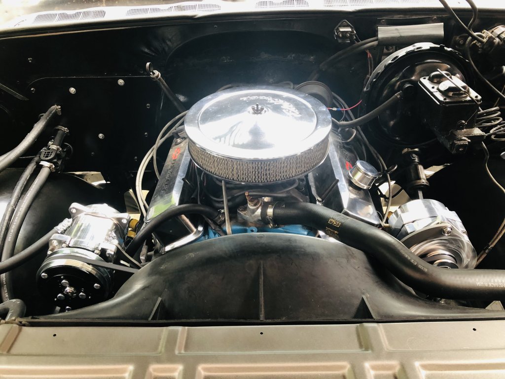

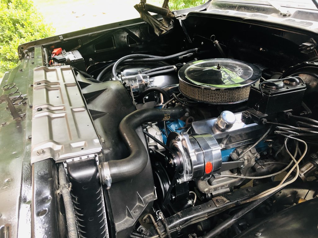

You will have an abreviated glove compartment. About half the size of original. The gain is clean firewall, which means easy access to engine. You also get electronic controls instead of vacuum. And hey, the appearance is worth it. I chose to relocate the ac to passenger side as it just looks better without hoses all over the engine. I buy thru Summit and get excellent support if needed.

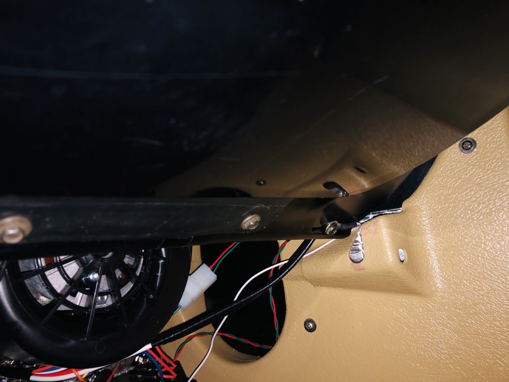

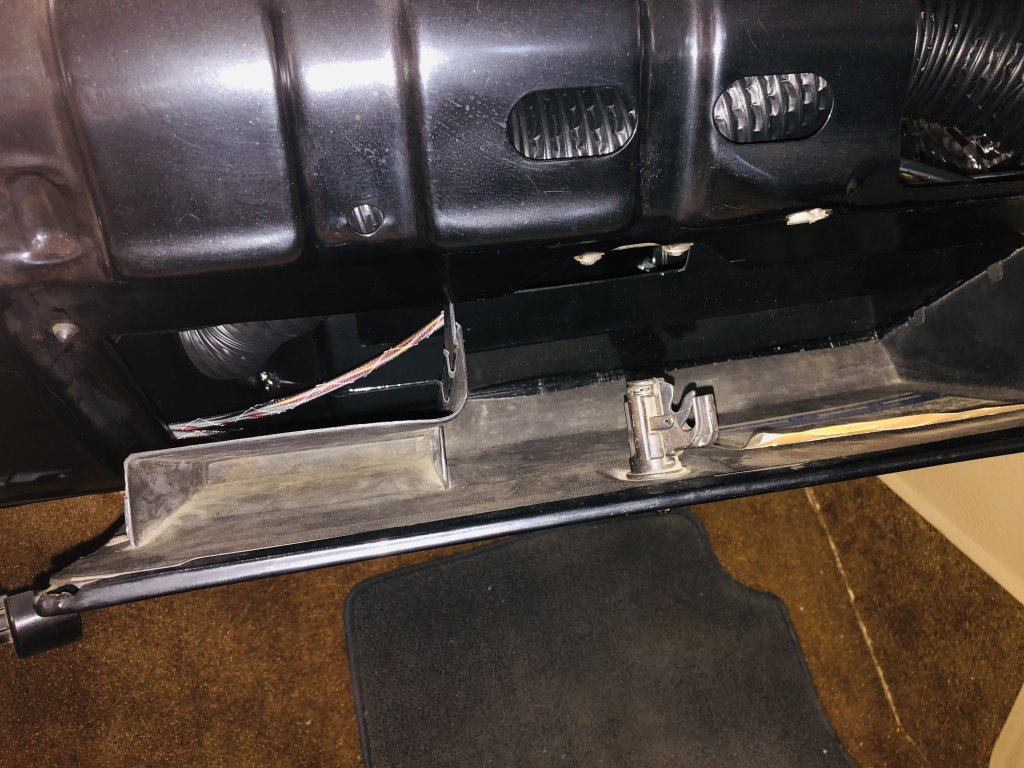

Pardon the missing dashpad.. waiting for new clips to complete the install. Plenty if room for the fresh air vent. My truck was prev. Factory air and no pull rod to open the door. I sealed it. But on my 69 without factory air plenty of room and i used the available rod to open the door. VA has the room; you need the mechanism.
Hope you can see my mini compartment. You cut it and “s” clip it back together. Plenty if room behind the seat.. and under too!

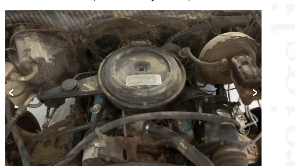

Btw.. here is what the factory air looked like a few weeks ago.

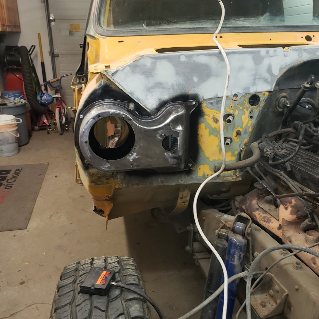

Just going on a whim here does anyone own a gmt400? I do like the look of a clean fire wall especially since I just bondo mine up and is ready for paint but I wonder if one of those heater ac boxes would fit in our trucks. I just know my wife would shoot me if I went and spent 1500 plus on a ac system. Lol.
I was trying to find some pictures of one last night but couldn't really get anything good. This is my fire wall now.
