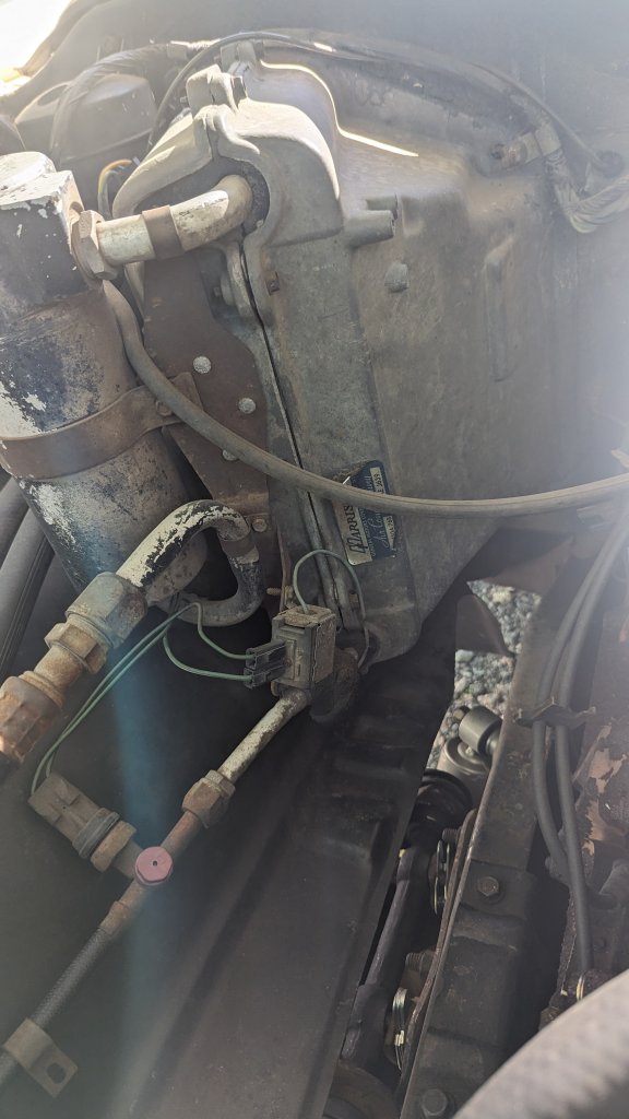

This is the switch I think is bad. I touched it and it can apart in 2 pieces. Still have to check with a test light or meter. Found it on Rock Auto under switches thanks
