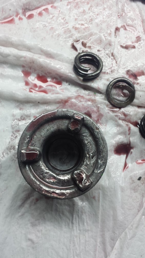

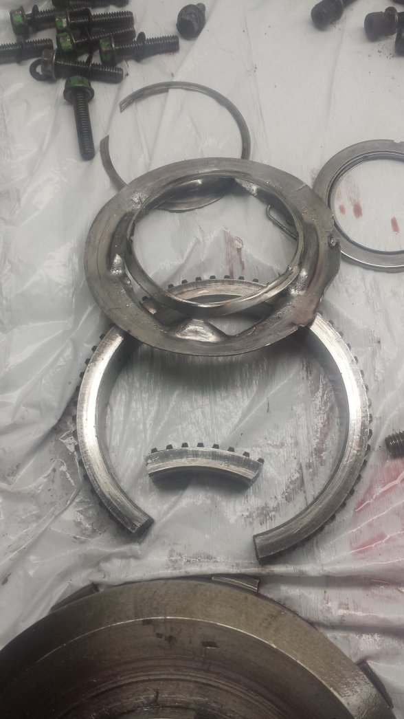

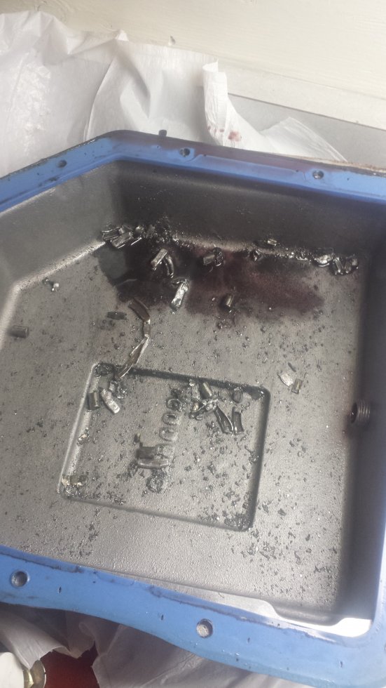

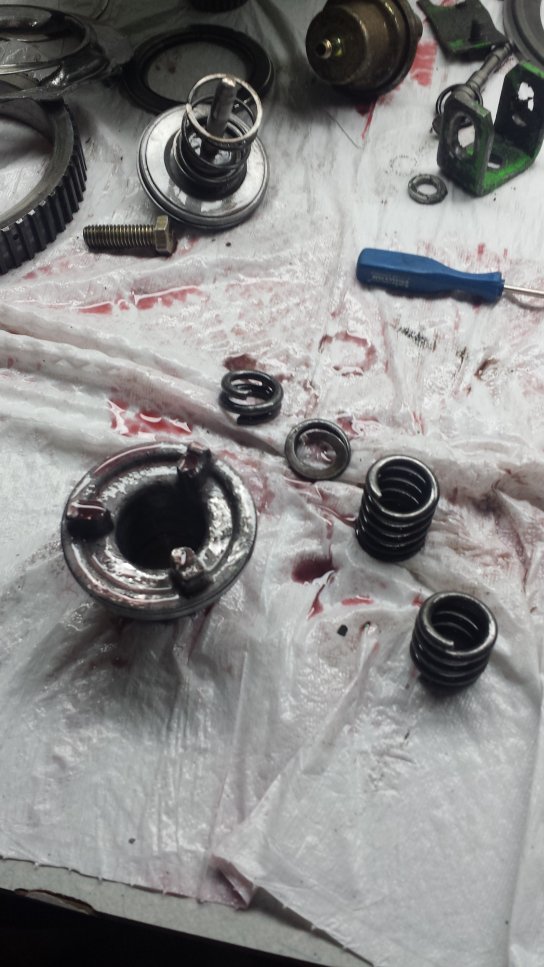

Ok, back story... so as you can see from the pictures, i decided to relocate my intermediate roller clutch/sprag into the pan, and that race wasnt happy being 1 piece. that was a TCI hardened race. the 1-2 accumulator spring broke and hammered the piss out of the accumulator piston, as well as the bore.
trans was a 76 case out of a 2wd something, i built it myself about 8 years ago(my first trans ever) i used a full tci rebuild kit, with trans scat shift kit, hardened outer race, trans worked fine until it didnt. it also had the direct clutch piston machined down to fit more frictions/steels
it has been driven hard along the way, twisted off the imput shaft, ripped the bolts out of the b&m converter and broke flexplate, destroyed another b&m converter. fixed witha hughes 2500 stall converter to match new cam that was swapped in, ATI input shaft and scat SFI flexplate, ran for about 5 years like that before the sprag let go. it sits behind a dart headed 10.5:1 383 with a full roller valvetrain with an erson 284/296(IIRC) cam with .548 lift, and a quick fuel tech. 750 double pumper.
ok, now for the problem at hand
the 1-2 accumulator bore is not looking so hot, i know there are sleeve kits available, but would like to avoid that. i kept the original th350 out of the truck from 1974, 29k miles on it, can still read borg warner on the frictions, case looks immaculate.

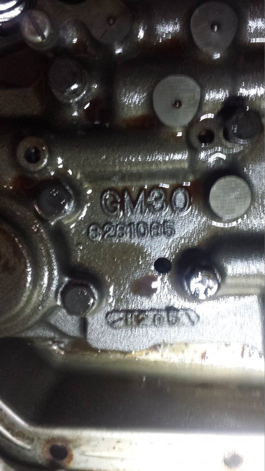

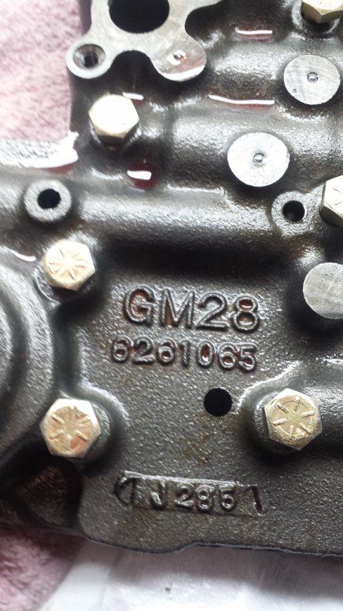

next thing is, my valve body i had in my failed trans has a different number stamped on it vs the one i got out of my core trans, the core one is out of a 1/2 ton and failed trans is a 3/4 ton

heres pictures of the 2 valve bodies in question, gm28 came out of the 73 3/4(failed unit) and the 30 out of the 74 1/2(core)

Talked to a local trans shop today, having him hot tank the cases, as well as look over some of the parts and replace some bushings as needed, also talked about double bushing the sun gear.
He also showed me a larger version of the low/reverse support? The one witb the rollers in it, the one he had was approx 1/3 wider than mine, said it would help out alot with strength.

I would dual-feed the direct clutch. That's what all the shift kits do, and can be done during the rebuild for the cost of a 3/8" set screw. It will more than double the holding power of 3rd gear.
I also machined the direct piston down and added another clutch and steel.
Also highly recommend the heavy duty sprag race, if anything. Yours broke.
I keep all the check balls, and keep the 1-2 accumulator, but I lock out the 2-3 accumulator so that it doesn't operate. With the separator plate drilled 1/8", it shifts firm, but not brutal.

that was a heavy duty sprag race. i upgraded to the TCI 36 element sprag with hardened race, came as a kit with drum and all

I didn't notice your transmission already had a kit in it. My bad.
If you installed a shift kit that came with its own large valve body separator plate, it probably blocks out the 2-3 accumulator feed. The B&M kit does this. Blocking out the accumulator firms up the shifts, whether it's by a blocked hole in the plate or "fixing" the accumulator so it doesn't move.
If your shift kit came with the extra wee gold separator plate (small, funny-shaped), it dual-feeds the direct clutch for you, and you don't need to make the changes internally. Pretty much all shift kits have this extra plate to dual-feed the direct clutch.
Removing the check balls (typical of B&M shift kit), and removing the 1-2 accumulator spring (typical of most shift kits) makes the transmission shift VERY hard, especially hard on the weak intermediate sprag (which you broke). Do consider putting all the check balls back in. The less violent shifts will make this transmission last longer.

ok, gotcha, yes mine does have the smaller seperator plate, i did not removed the 1-2 accumulator spring when built, but the spring did break, which im guessing cause my very hard 1-2 resulting in sprag failure.

alright, so putting this thing back together, had some issues, pump slipped from my hand, and broke the end of the stator, only fell about 3 inches.
putting it back together, i measured the 1-2 accumulator spring, it measured 3.112, book says it should be 3 3/16, i know people cay you can run with out them but risk damaging the intermediate roller clutch. i have a TCI 36 element intermediate drum with a hardened outer race, i am a little gun shy with this spring, as it broke into pieces on my last one, and ruined the case,i looked into sleeving it, but it didnt look like it was worth the time.
so what say you guys, spring out or replace with a new one?

When in doubt always go with new parts. If it fails later with the old one you'll be kicking yourself.

Yeah, makes sense. Local drivetrain dodnt have the 1-2 accumulator spring. Looks like ill have to order one, so i will probably run with out the spring until i get a new one, its winter, so i wont be too hard on the 1-2 shift, and ill only be driving it until my duramax is back on the road. The 74 usually just sits in the winter
