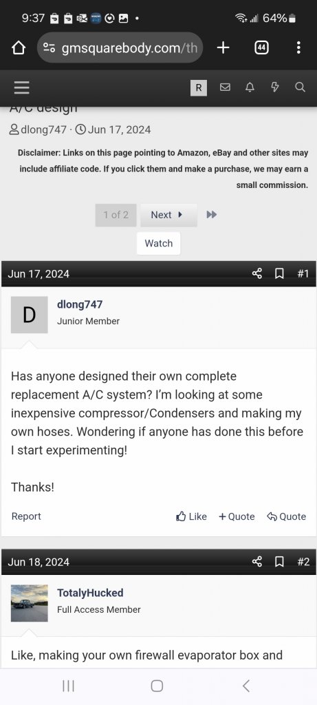

We got another one !!!!!
Let's get this straight. The car already had A/C you are just wanting to replace the compressor,condenser, and hoses? If that's all than this is easy. Need make year and model and engine( not joking). Post reply
