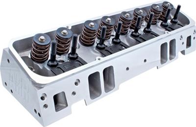

Excellent summary. I also would not go with Vortec heads again. I think the AFR 195's are shizz these days.
Alright, give me the run down on those. What's that system like? Decent with TBI? Is there a TBI intake for these heads? etc.

The AFR's are better than vortecs in every way. Cost is almost a wash. Intake manifold is cheaper. I don't know (anybody?) if TBI has the traditional 4150 mounting flange like the carbs and aftermarket TBI?
Do a search on YouTube for the AFR vs Vortec heads. There are literally tons of demonstrations.
