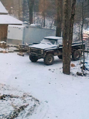

hey everyone I have a 86 k20 lifted 4 inches with 38s stuffed under it im looking at upgrading to a 12" lift spring in front and 8" 52 springs with shackle flip in rear. I know its going to ride terrible trucks just a mud truck so want to go big, my questions are what do I need driveshaft wise and anything else that I need to do besides longer shafts?

Longer brake lines and vent tube

You'll also have to correct your steering setup for the lift.

Yeah haven't figured out how I'm going to go about that yet
