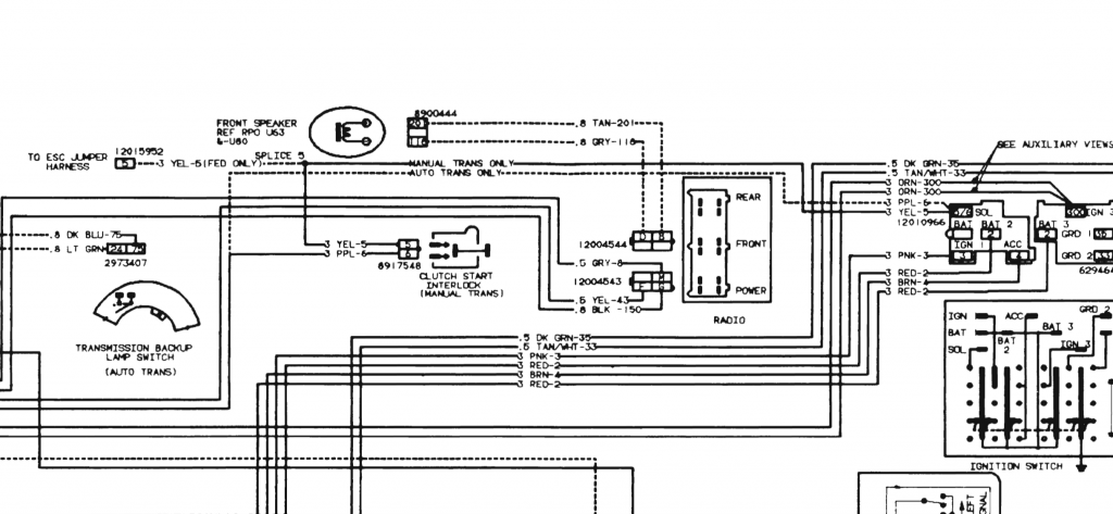

86- automatic-the neutral safety is mechanical- did away with the switch mid 84. If it is manual- like mentioned above- could be a bad clutch start interlock. Definitely make sure the purple wire on starter is making good contact. Follow Ricko1966 instructions above.
