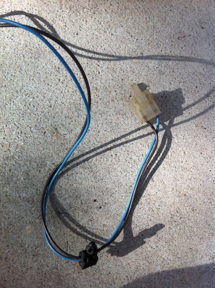

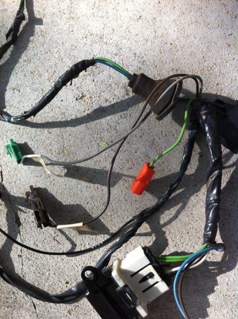

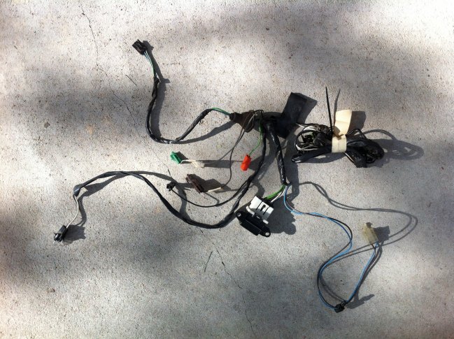

Turns out I have the harness, here are some pics.
1st pic.
Top Left is the blue/blue/green wire. On my harness it shows the green wire with orange connector on the inside of the firewall, not in the engine compartment.
Green connector and brown connector plug into the fuse block.
2nd pic.

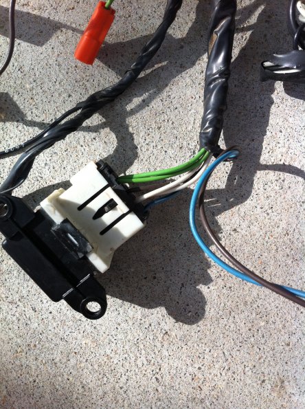

Closer view of the relay. Relay is part number 14014515, google comes up with various transmission relays.
3rd pic.
Gray/Blue wires were connected to an adapter on the brake pedal assembly. That same adapter had a black hose that ran through the firewall into the engine compartment so this might be for cruise control?
4th pic.
Shows the whole harness. The part of the harness that is in a zip tie runs into the transfer case.
