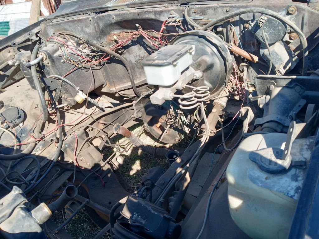

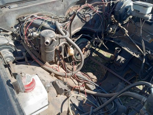

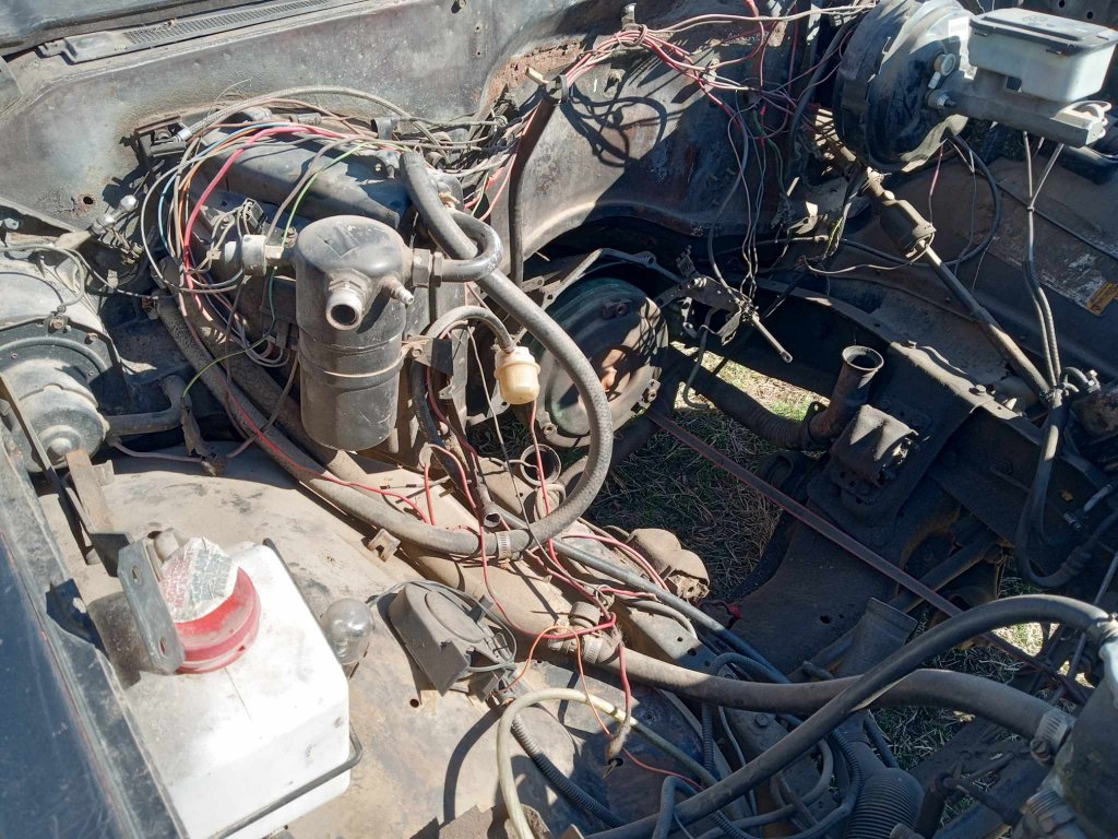

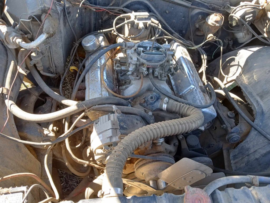

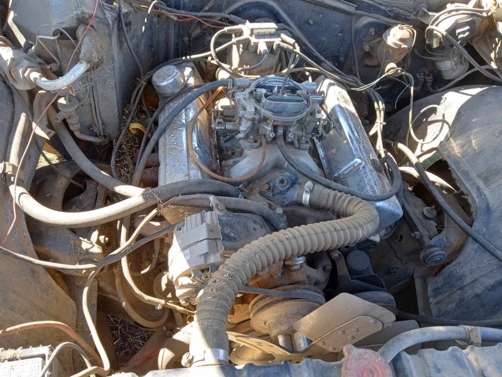

+the 65 impala has the 350(14093638) and I'm putting it in the 86 c10 and has 16 bolts on tranny which is a 700r4...

Does your truck have its original engine in it?..or just an empty engine bay?
Being it's a Silverado it probably came with a/c, p/s, etc.
Bracketry will be needed to retain those factory options.
Water outlet, may be facing a different direction, requiring a different upper radiator hose.
If you still have the original engine in truck, of course those things can be transferred over.
+it is empty engine bay... +thanks for input...

Welcome to the forum. That 350 didn't begin it's life in a 1965 Impala, so you might want to make note of the numbers on the rear driver side of the block and on the passenger front below the head. This will be a good reference for you when figuring out the type and flow of the heads and what sort of block you have, as well as when ordering parts. As far as the installation, it won't matter what size or year of sbc, they will all just about fall in and bolt up by themselves.
+i know, it had a 283 and i took it out and put 350(14093638) in about 10 years ago... +thank you so much...
