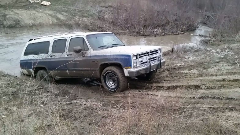

I'm 19 turning 20 this summer. Last year I bought a 1986 chevy suburban from a guy down my road, been sitting for 15 years. Half barned half on driveway. I rebuilt a bunch of it and made it my daily driver while I gave me sister my 97 Burban for here daily driver. I use this truck to get to school, work, and to play in the mud. So far every other weekend me and my buddies go off-roading and the truck holds up pretty good. Its currently sitting on stock suspension with 285/75/R16 BFG Mud Terrains. Where I go offloading it favours short wheelbase. So I keep on running into the problem of my hitch in the back bottoming out as well as the gas tank skid plate. Gets me stuck sometimes. As well as the rear bumper bottoming out and bending here and there. So I would like to lift it to fit 35 inch tires. I know a 4 inch lift will fit 35s but would a 6 inch be better for offloading since my wheelbase is so long. I prefer not to run bigger then 35s since it sees pavement a lot as well I don't have the funds to beef up axles or swap ring and pinions. So I want to keep it nice and simple, plus with a 6 inch lift would I have to use a T-case drop for driveshafts or is that not needed. Prefer to install myself to save some money, less complications better. As well is a double steering stabilizer necessary for 35s or is the stock single good enough?
Thanks any help appreciated.
