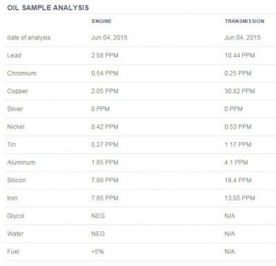

Another question for you guys, there is and engine and trans oil analysis available for the vehicle, but I have no clue what normal levels should be. Could someone point me somewhere that shows an analysis on a 6.2 with normal levels?
Picture of analysis attached

When I was driving long haul, we were encouraged to consider oil analysis. What I heard was that the analysis was a benchmark for that specific engine. You use the first one to compare against the future ones for that engine. That isn't to say that there aren't numbers that would jump out at you but the idea is that you compare your engines numbers against your engine. You don't even compare them against your buddies engine that left the assembly line 5 minutes after yours.

So you don't think the 30.82 ppm for Copper or 18.4 ppm Silicon in transmission is cause for alarm?

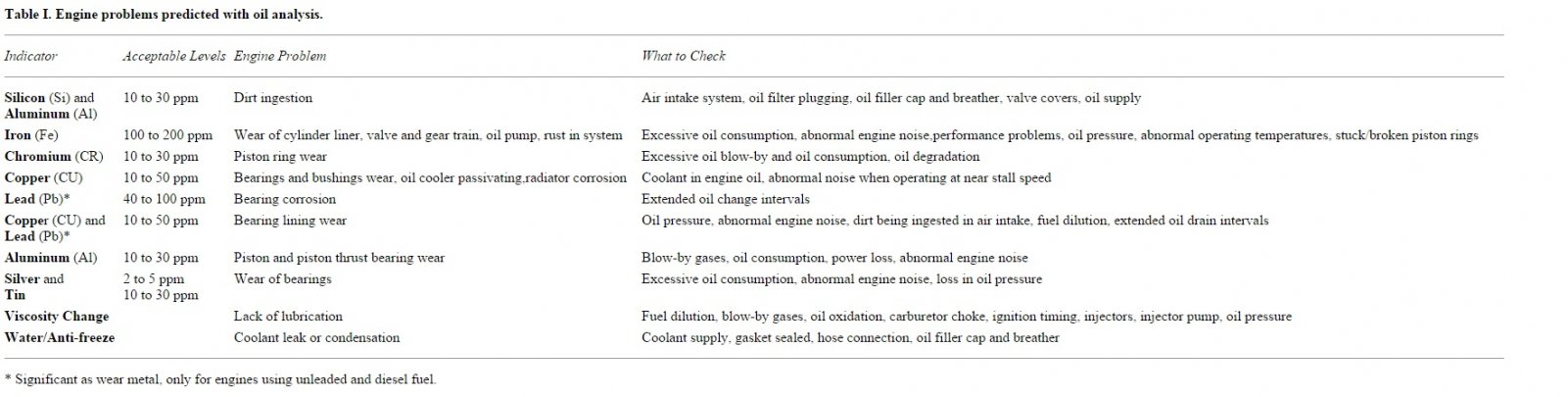

Although I now understand it is just a testing reference, I came across a table with indications(kind of like a general guideline). Please let me know if it's a good general guideline to go by, even though I have no previous oil analysis to compare to. I just want trust that I can drive the thing home if I get the bid. (The inspection said it runs, and it sounded good in the short video clip).

They may be cause for concern or not. The only way oil analysis is really effective for an engine or transmission is through regular analysis so you can track how things change. The numbers you were concerned about were in the expected range for oil, but I don't know if those numbers are supposed to translate over to transmission fluid. Both the numbers you mentioned were right in the middle of the expected range and I probably would not worry about them at this point. If you had a previous report that showed copper at 22 PPM then I would be concerned because there is a big change in wear.
I don't know if you can use the same table for expected wear from an engine as you would for a transmission. They are two different animals with different wear components and materials and lubricants. If you want to do that for your transmission you need a guide that shows you what to expect for your transmission.
I may be wrong on this as it has been a long time since I even thought about oil analysis, but I beleive I have the basics correct. If your numbers giving you pause are for your engine, I'd say you are probably ok based on the table you attached. If those numbers are for your transmission, I have no clue as you haven't included anything to compare to a transmission.
I hope that helps you out, @gmTrent.
