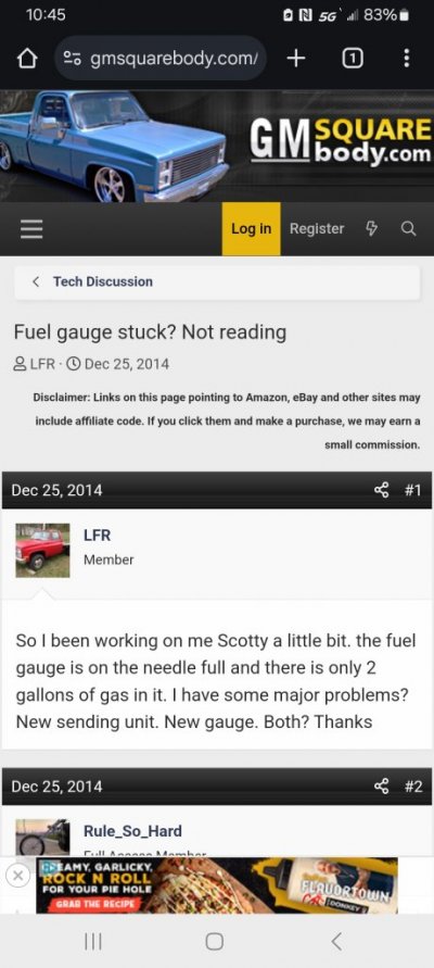

This is the initial forum I been looking at but I can't find it again to reply on it
