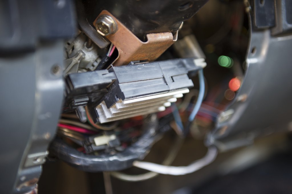

TPISly-C10
Apr 1, 2019
615
896
Boucherville QC Canada
Sly
C-10 shortbox
LQ4 6.0L
don't know if this module is good or not? pulse not working correctly
