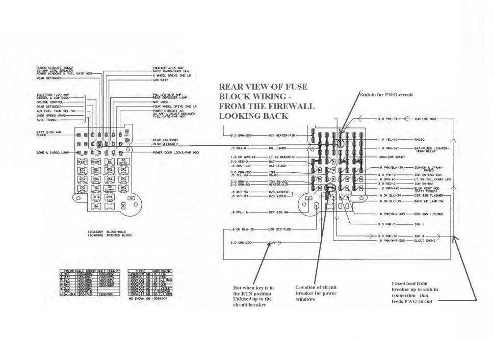

I need a diagram of the fuse box underneath the dash on the drivers side.

Chilton Manuel has it all

Found this one. Is it similar to yours?
