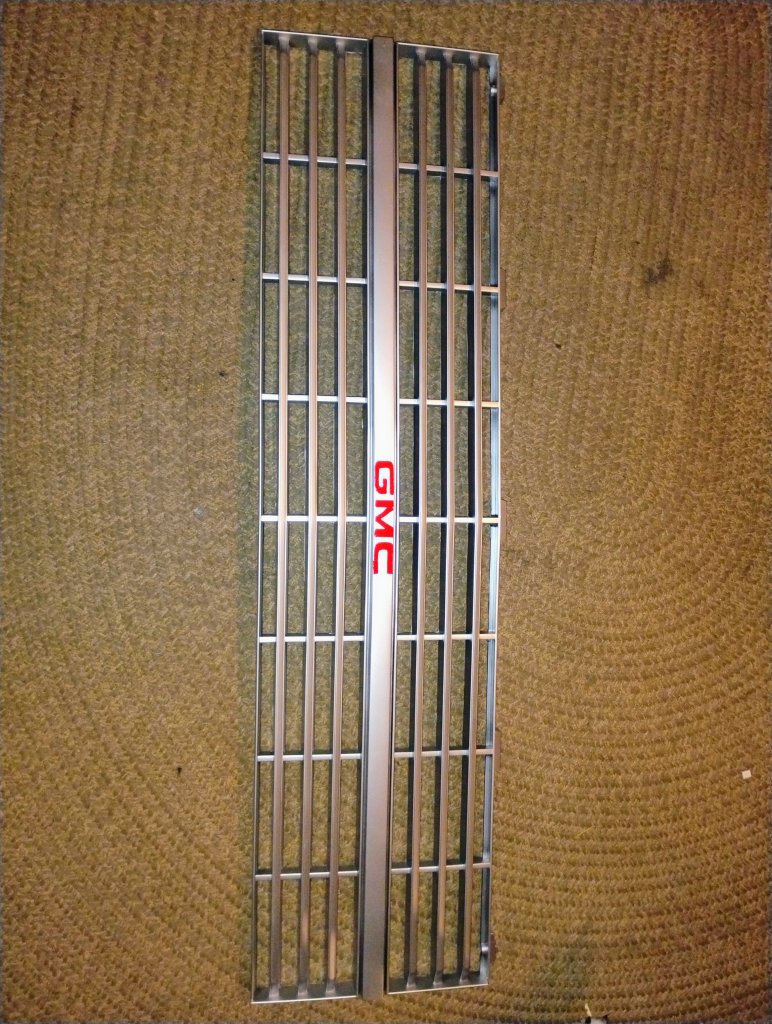

I just went and looked to see the differences- thought I’d post this for others in case we see one in the wild. I’ll keep my eye out, every once in a blue moon I’ll see a GMC grille locally (but I think mostly the 85-87).
