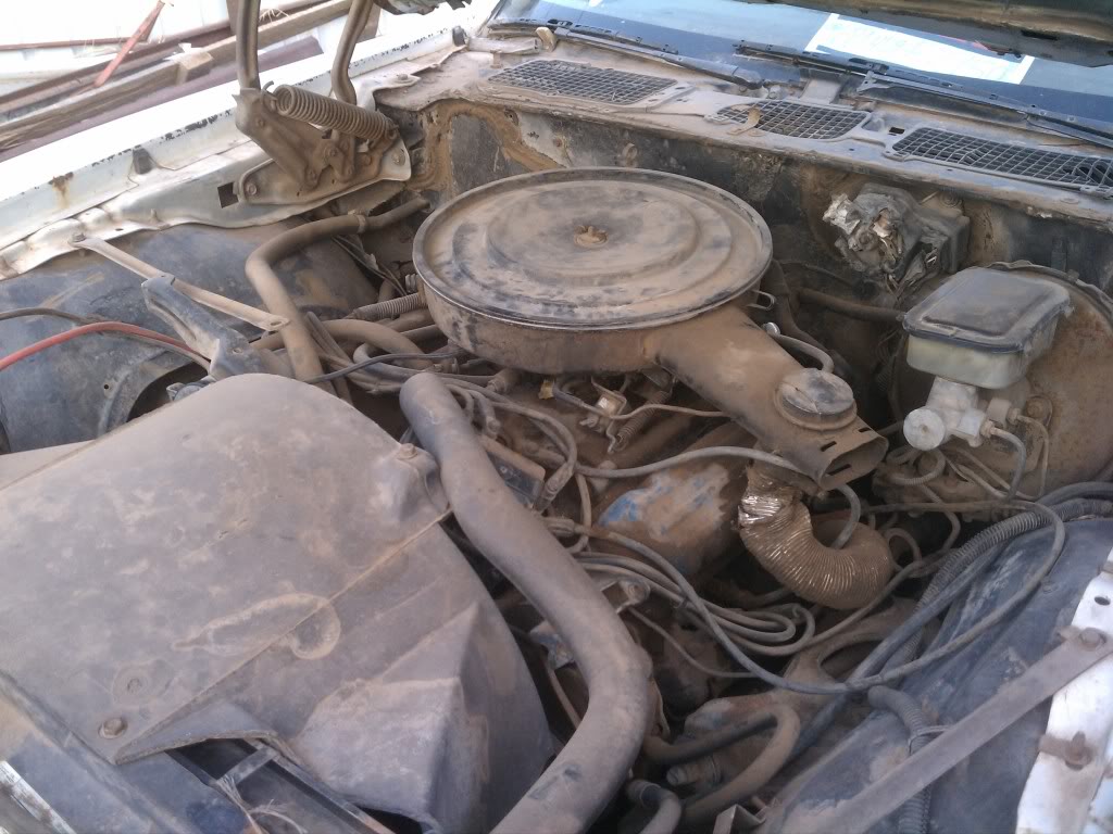

Looked at an 81 Firebird tonight :jester:

I'm guessing the 81 is a driver right now?

If it had tires I'm sure I could have driven it :roflbow:
Guy stuck a battery in it and fired it right up. Held idle
Being an 81 and that it didn't have a turbo I'm going to guess it was the 4.3L V8
But then again it have a front distributor. So Buick motor perhaps?
28,638
10,051
4.3 V8?? :think: I wasn't aware such a thing existed....
http://en.wikipedia.org/wiki/Chevrolet_small-block_engine
The 1975–1976 262 was a 262 cu in (4.3 L) 90° pushrod V8 with an iron block and heads. Bore and stroke were 3.67 in (93 mm) by 3.10 in (78.7 mm). Power output for 1975 was 110 hp (82 kW) and 195 lb·ft (264 N·m) at 3600 rpm. The 262 was replaced by the 305 for the 1977 model year.
This was Chevrolet's second 4.3 L-displacement powerplant; three other Chevrolet engines displaced 4.3 L: the Vortec 4300 (a V6 based on the Chevrolet 350, with two cylinders removed), the original 265 V8 in 1955, and a derivative of the GenerationII LT engines known as the L99 (using the 305's 3.736-inch bore, 5.94-inch connecting rods, and a 3-inch crankshaft stroke).
This engine was used in the following cars:
1975–1976 Chevrolet Monza
1975 Chevrolet Nova
Early 1977 Pontiac Ventura
