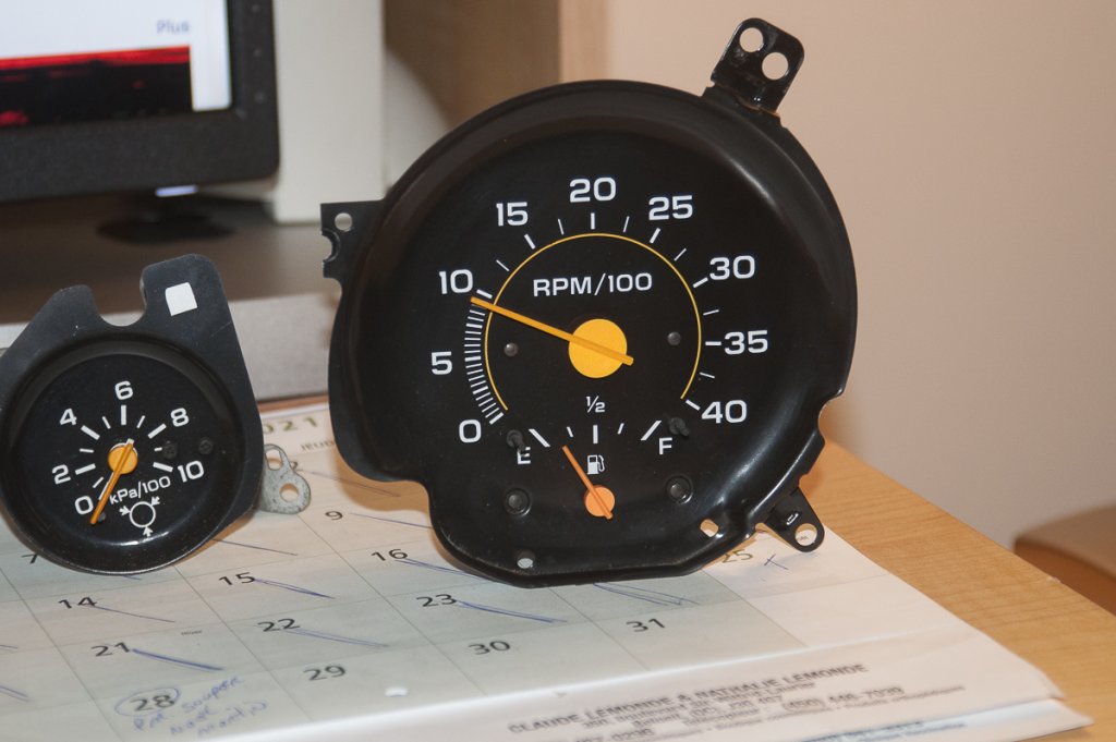

since i have a clock i chose this tach and don't care about the 4k limit! :)
Be careful with that, most of those are for a diesel engine and will not work on a gas engine. The use different inputs.

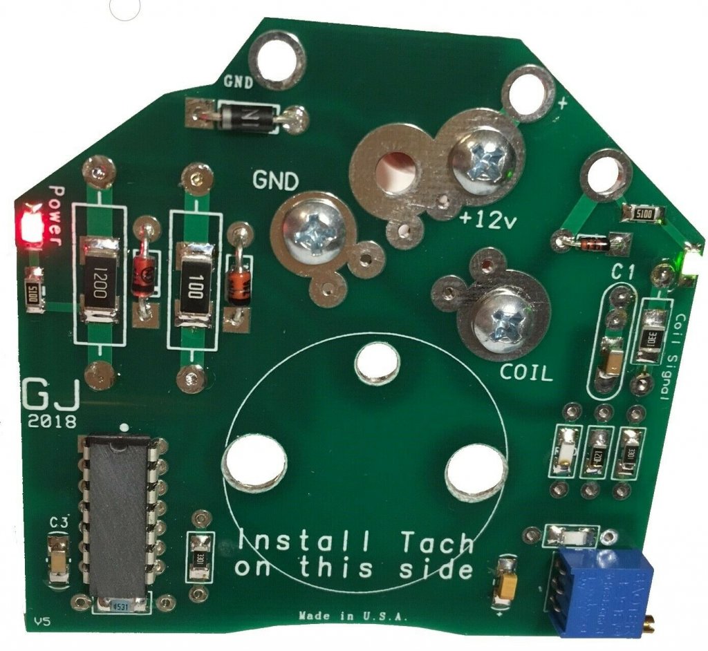

i know been there...new and improve board is on the way....no more bouncing diesel needle! :)
