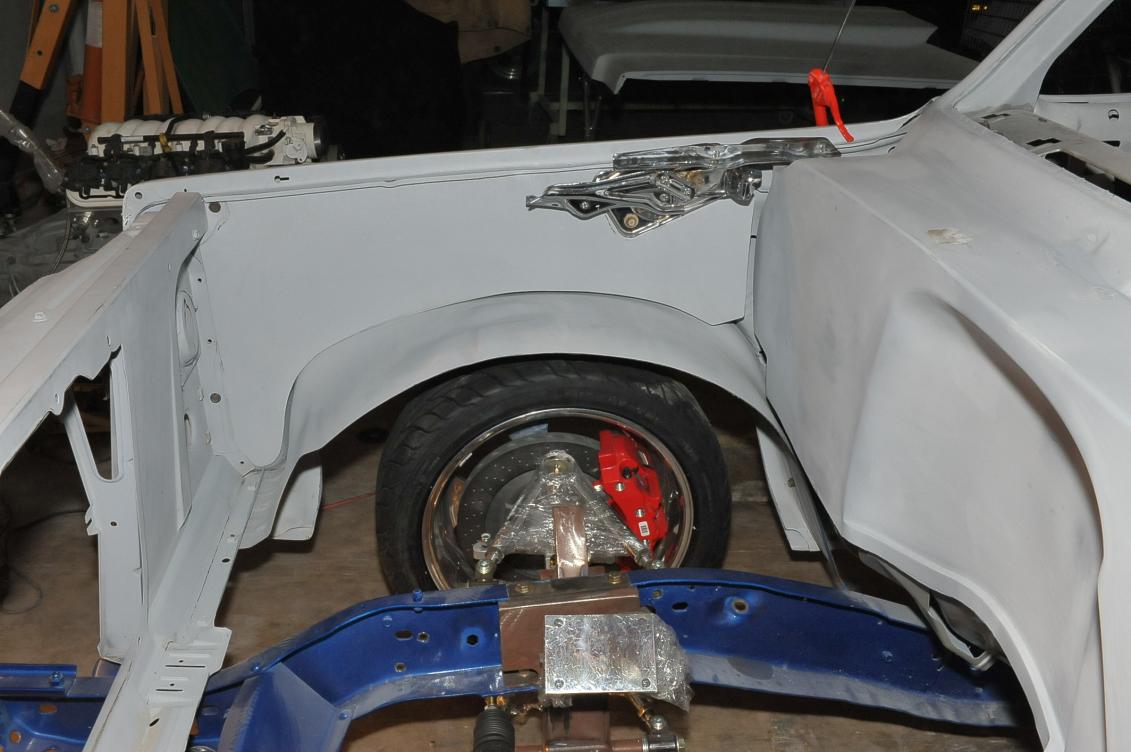

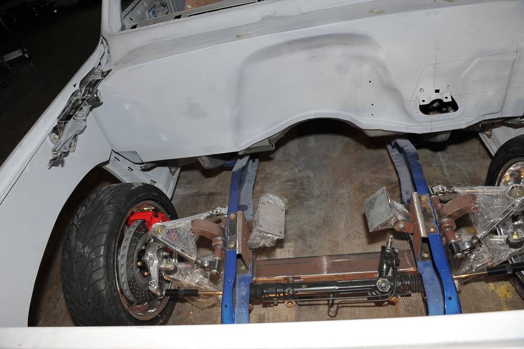

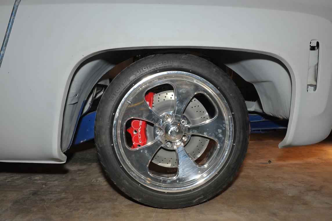

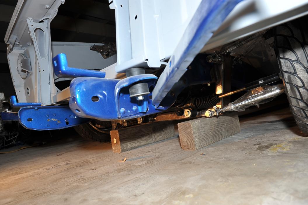

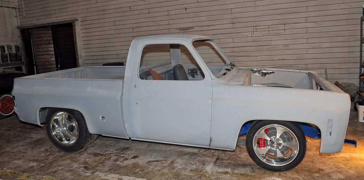

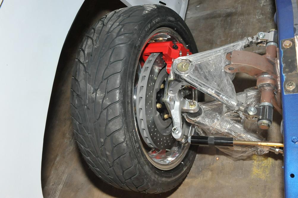

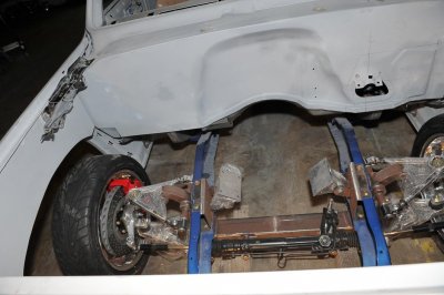

Been busy but anyways I have the front components installed I am still waiting on my steering column then after thats in I will figure what I need foe u joints. I still need toorder the front coilovers but the ride height is what you see in the pics its like 4'' off the ground from the k member. I would have been done with this but I complelety shifted the to do list. I have been fitting some new billet hinges off a 72. I liked the billet hinges and no one offered them for the 73 so i had to chop it up.

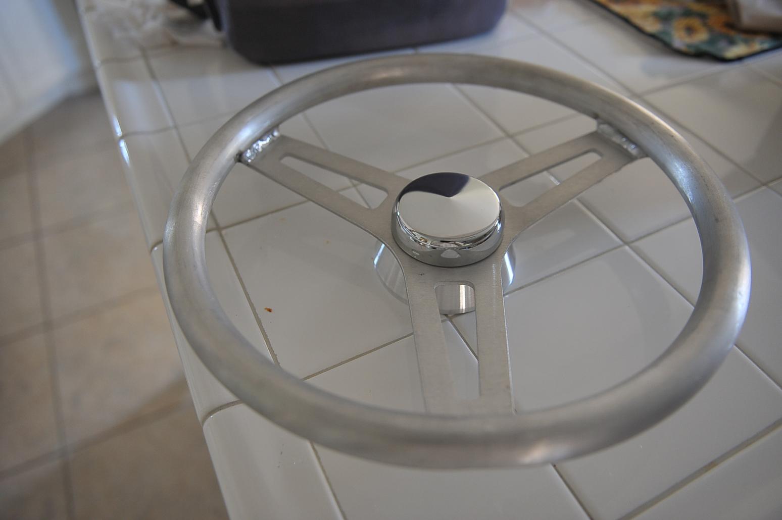

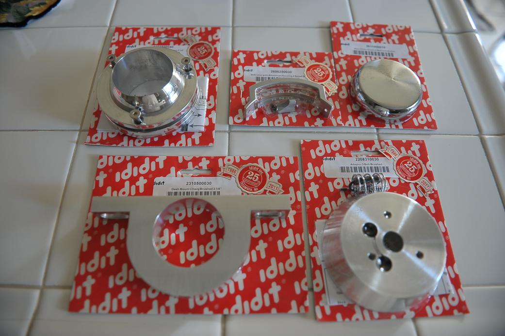

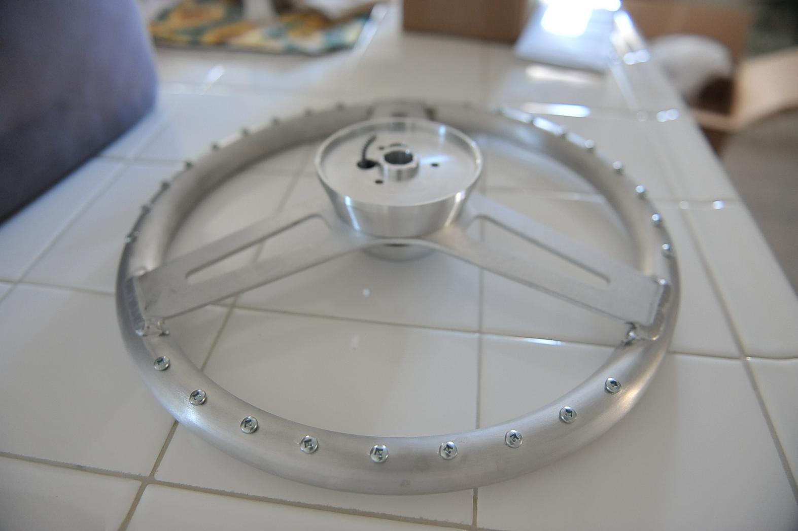

I am still waiting on the steering column its been 3 weeks wtf. it was a custom order 3 bolt gm steering wheel and on the shaft it was a ford splined 3/4

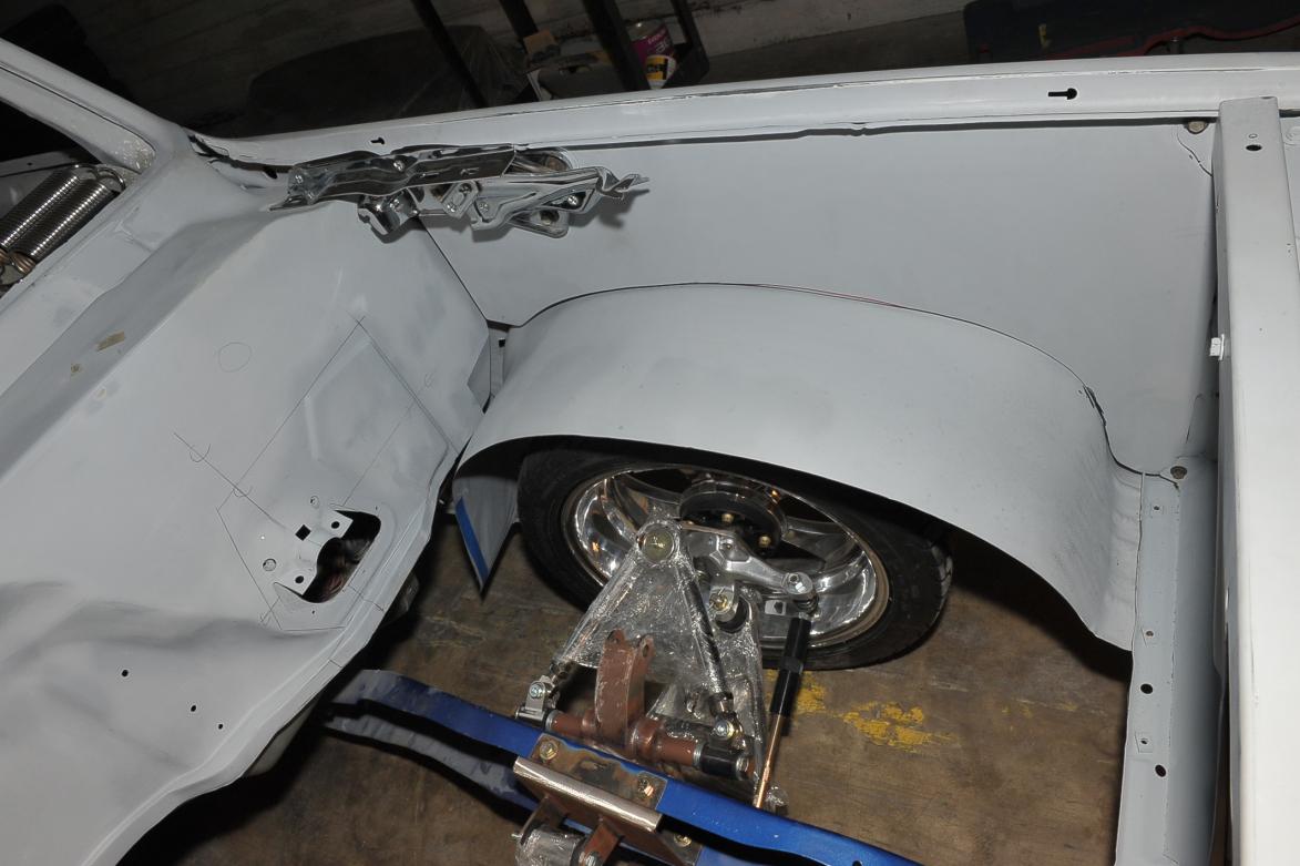

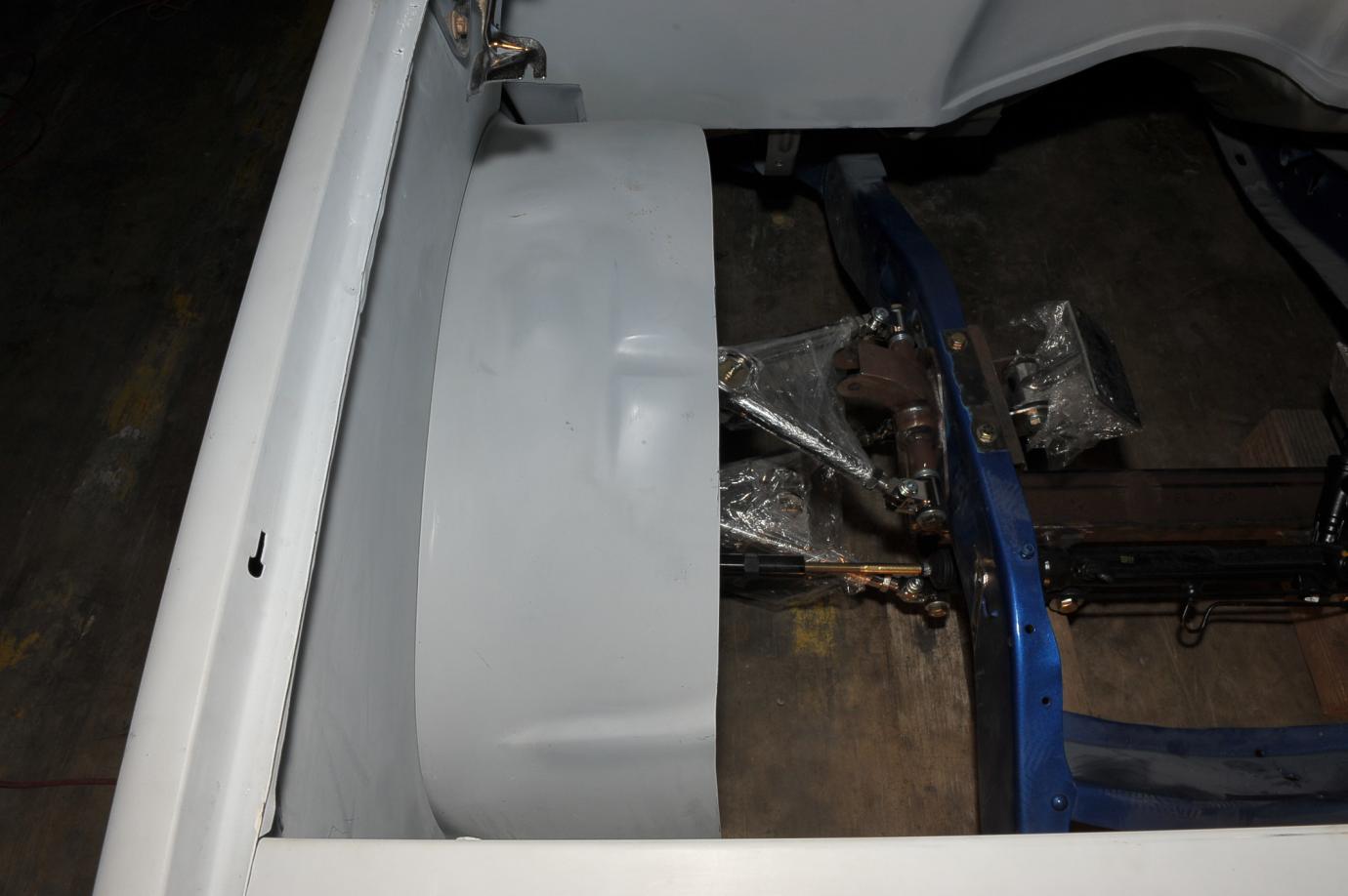

so after installing the parts i realized that the inner tubs were hiding all the candy so i choppd them up to expose the candy while still having the protection of the tubs. the top of the tubs will be painted and the bottoms rhino lined

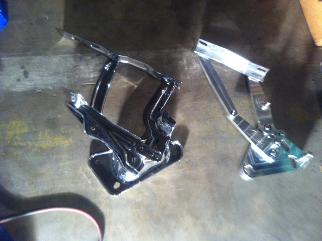

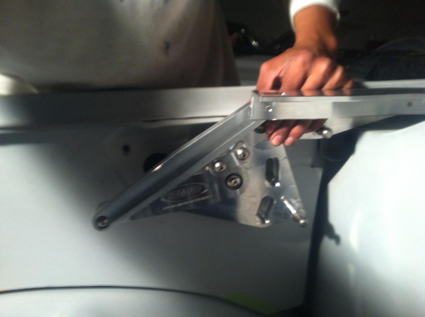

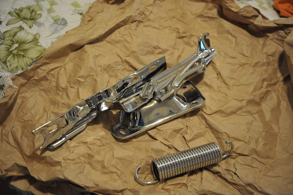

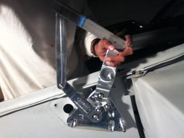

here are a few pics of my ongoin battle with these billet hinges. I have to report that i have 3 failld attempts but i am getting closer, not much room for error or the geometry will not work like when opened the bottom of the hood hits the fire wall insufficient heigt clearance but if i raise the hinge when closed its not level with fenders .... goes on

these are up for sale hit me up if you are interested I used vernes chrome plating
