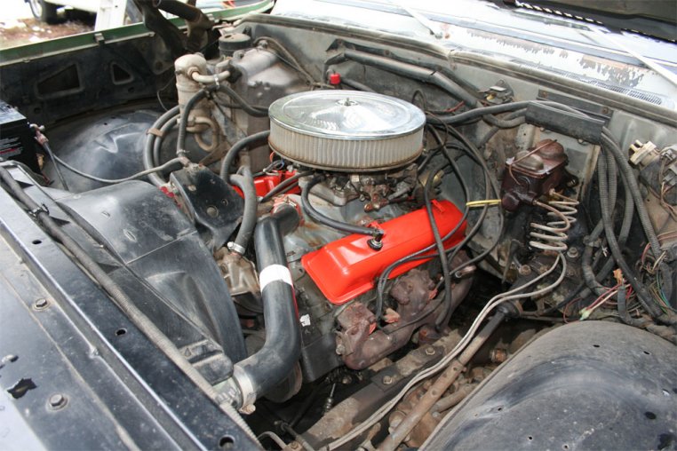

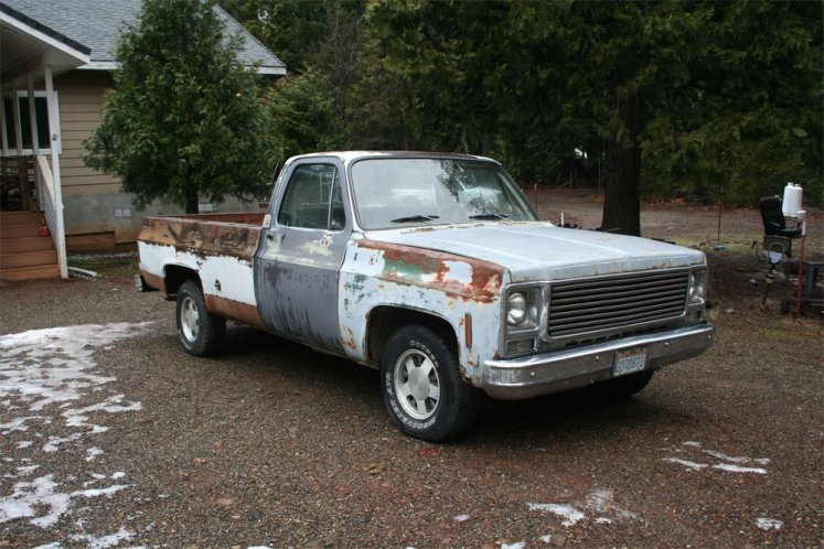

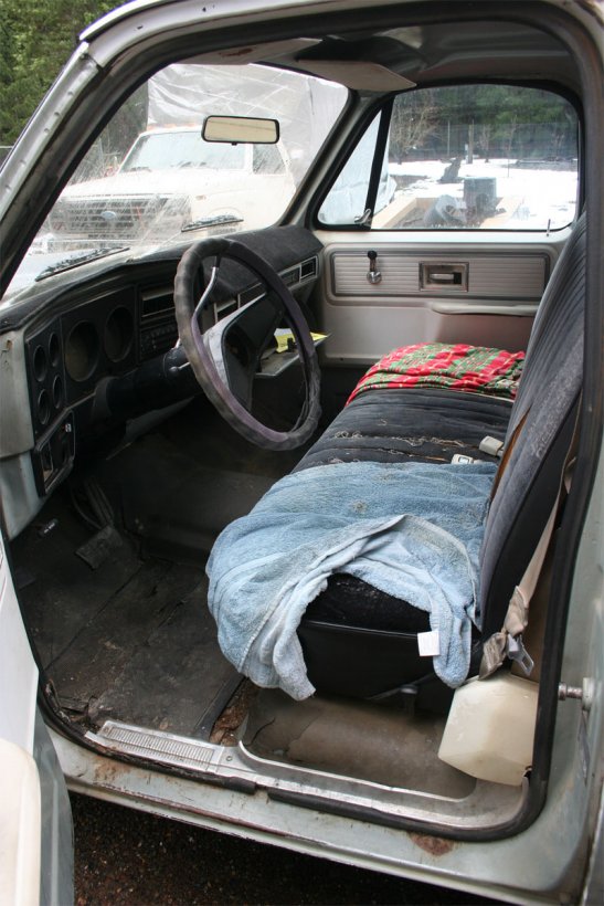

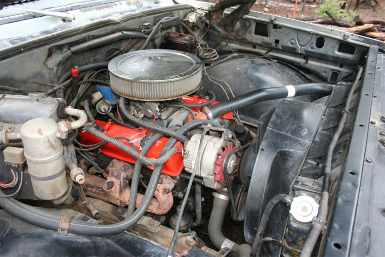

Just bought a 73 C10 long bed (327ci), and it has some issues...
Need to make into reliable transpo ASAP, and then will continue fixing it up from there...
When I bought it, it had no lights.. one turn indicator was working intermittently, now not at all..
Thing runs and rolls great though.. Aftermarket stereo works, but nothing else.. no dash lights, no cab light, no heater fan, nada...
My plan was to just get the lights working, and then go from there on everything else.. Driver side door needs adjusting, probably need to replace window regulators and all weatherstripping..
But as I started digging into everything, I found that the fuse box connector (on the firewall in the engine compartment) is fried.. Lots of black wires where they connect, some melted plastic... It's toast..
I was able to take it off and separate it into three separate harnesses.. Virtually every wire on all three harnesses are affected.. Fuse Box side itself doesn't appear too bad...
I was already suspecting the truck might need a rewire, but now my hand appears to be forced... Fortunately, I got the truck at a great price, so even after a rewire, I'll still be ahead..
I'm just glad to be working on something that is pre smog.. Thoroughly sick of the ridiculously over the top hassle of CA smog laws...
AND SO IT BEGINS.. :cheers:
