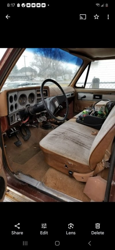

3500 camper special

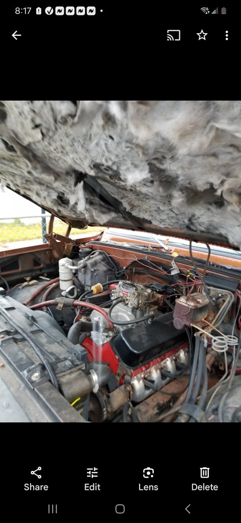

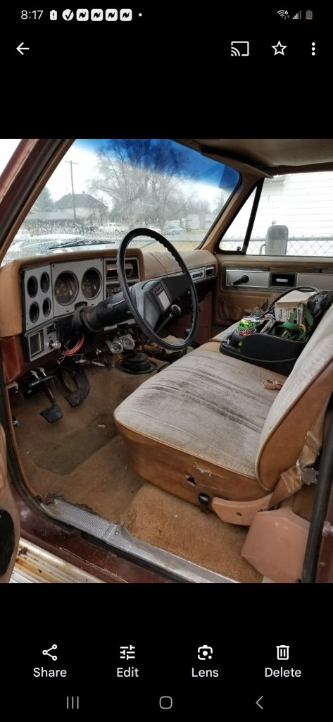

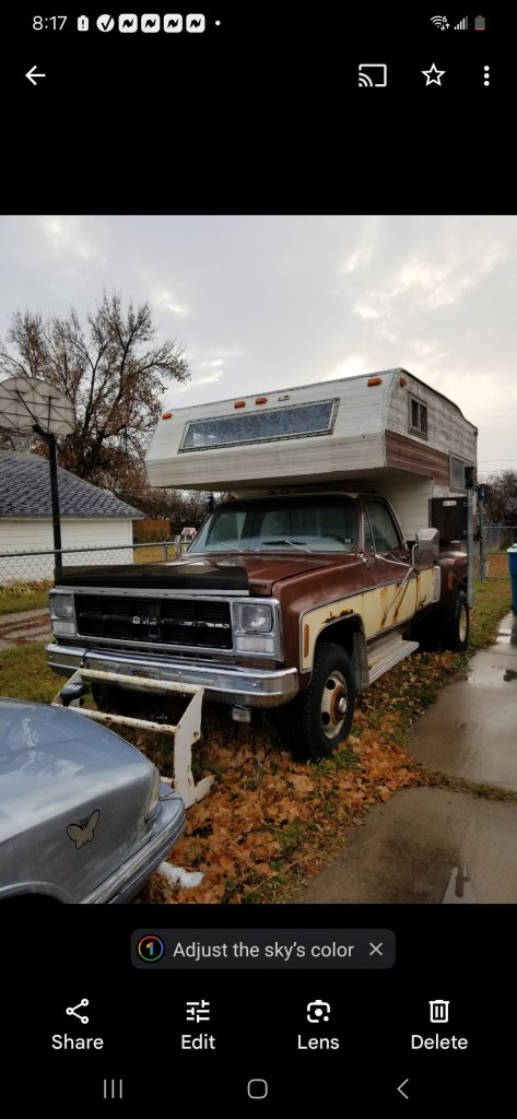

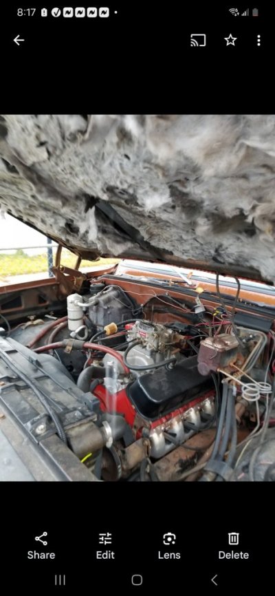

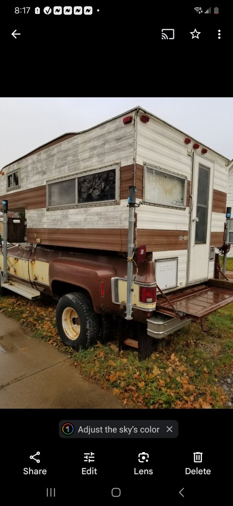

Here's some pictures

11,989
19,066
700r4 will grenade under that truck. 4L80E is what you want for an auto trans. I stand by my previous post, swap gears and be done with it. Cheaper and better.

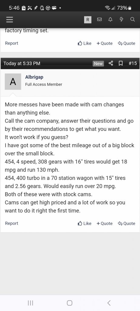

@fnny6770 look what popped up on another thread.
