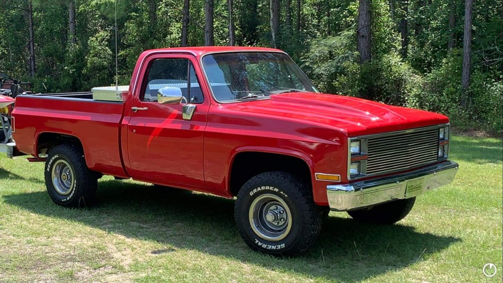

Pic of truck for no reason at all

Nice truck!
