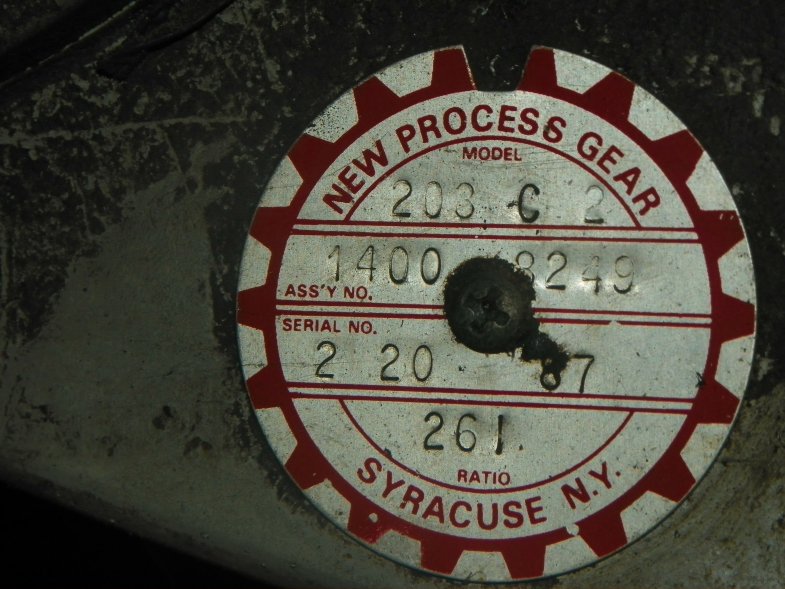

this is the tag on the transfer case

that is a 208 looks like the 8 stamped funny
I would think shift fork issue the fork spreads and does not engage the gears right so you might be in neutral and that might be why the no go
Do you have a pic of the whole transfer case ? cause im willing to bet that is a 208 not a 203. The 208s were not bad I have 2 of them that have never let me down.
Yep sounds about right. Easy fix!
ill try and get a picture of it tomorrow after work in the day light. after zooming in on the tag on my computer I think you are right and it looks like a faded 8 and not a 3

The thing is the case doesn't look like a 203 and the stamp says it was an 87'. 203s were not made in 87

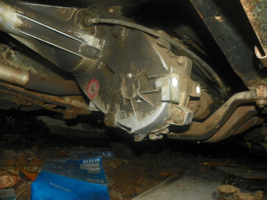

the previous owner said the trans was from a 91 so I just assumed they used the tcase from the same truck. this is the best pic I can get right now

it is a 1987 np 208 no need for pictures that tag says it all
there was no 203 t case in a 87
and the 203 will not bolt directly to a 700r4 it can be done but not really a fast easy swap that some would do
check the linkage like suggested pull it off the shifter and see if you can get it to go into gear by push or pulling it. but I would bet its the shift fork
