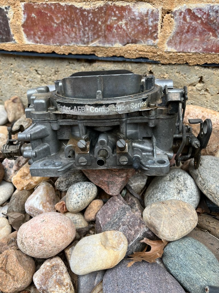

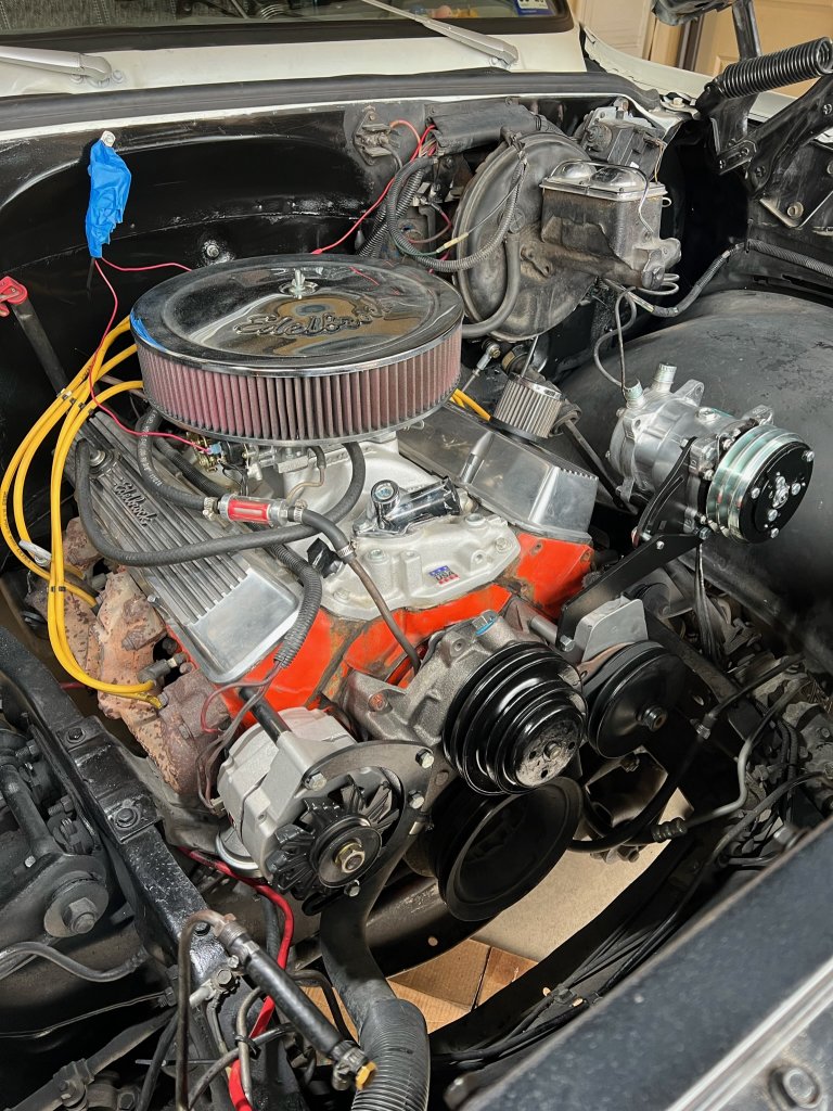

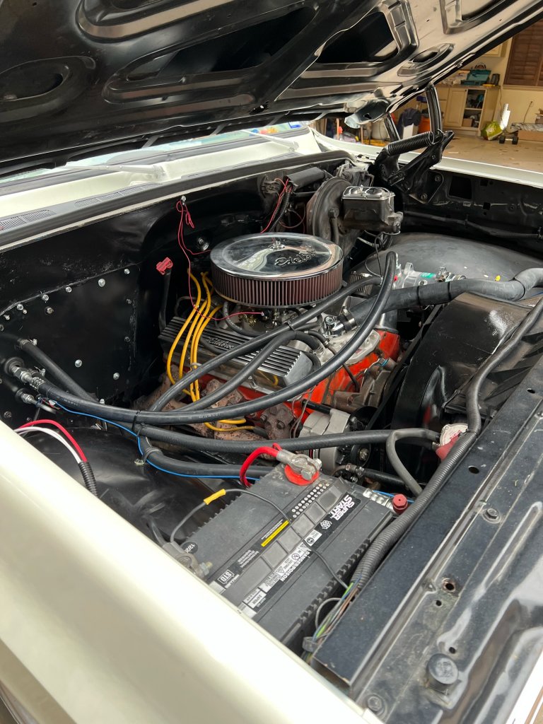

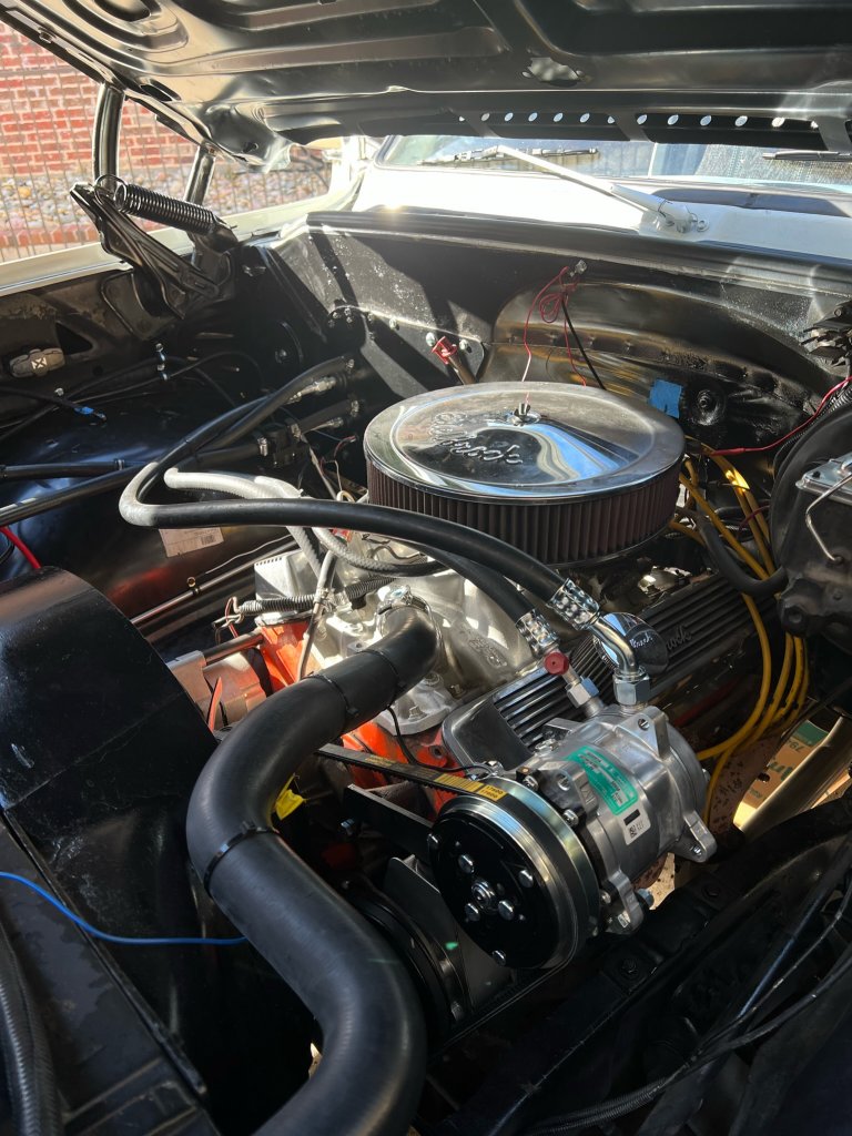

…… the quiet guys in the group will take all that and keep things simple as she came. New edelbrock performer intake, and carb (finally with electric choke) and an HEI ignition…
Learn more by listening on here for sure! Great weekend y'all
