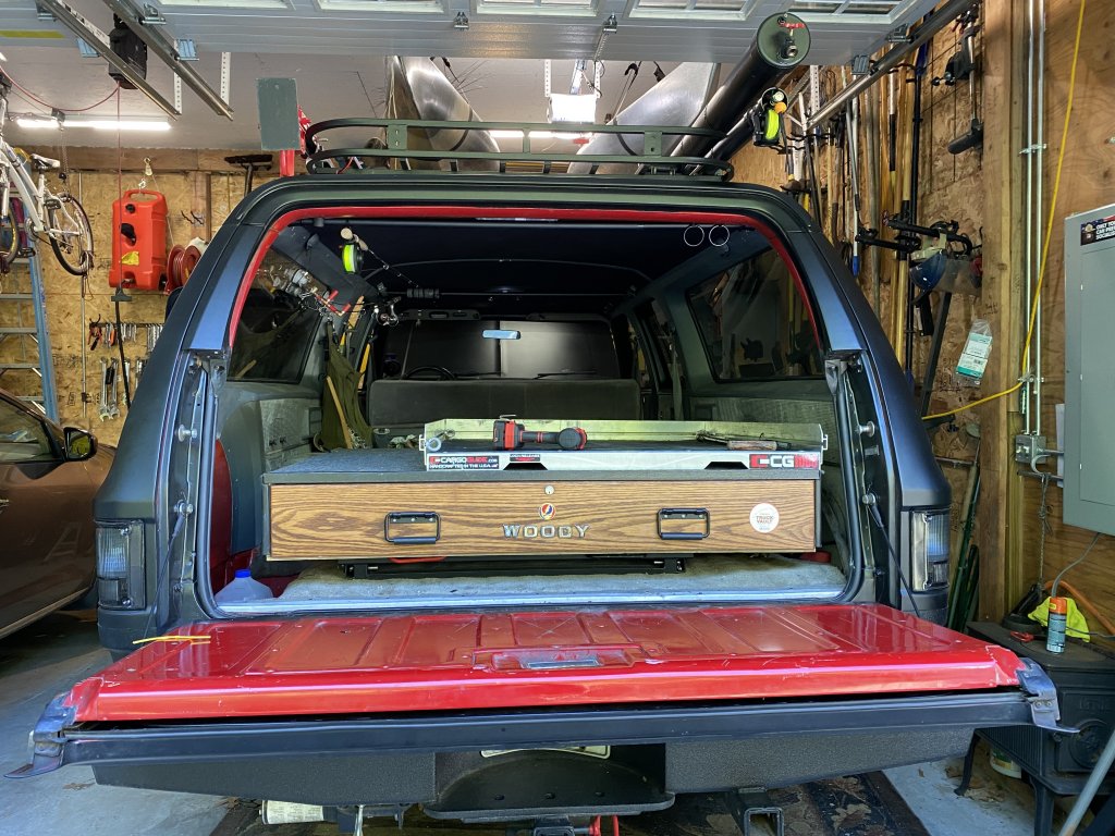

Thanks guys, I’ve had it with repairs, spoke to the wife, new truck $70K plus. Probably gonna have a great local mechanic drop an LS in with a new trani this summer. For now have him order a 700R4 new and drop it in tune with pressure gauges, not the (lawn mower throttle control TV Cable). I would love to go Standard 5spd, anyone seen a good thread on this?
