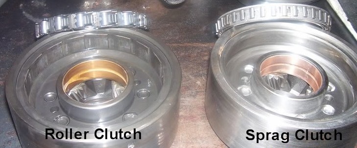

Here's a pic of a Turbo 400 difference. Same part, but 2 different styles. One is a roller clutch, notice the rollers, and one is a sprag, notice the dogbone shaped wedges Those wedges don't spin or roll. They slip one direction and bind up in the other, why it's aka one way sprag and the roller clutch works the same way. It rolls one way, but locks up in the other.

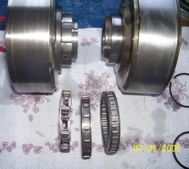

That pic above is of a Turbo 400 Low/Reverse Roller Clutch or One Way Sprag. This pic is of the intermediate Roller Clutch or Sprag which is needed for 2nd gear on a Turbo 400. Again, same part, just a different style. The true sprag is always going to be stronger. It has more holding strength and less likely to slip.

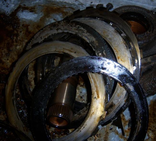

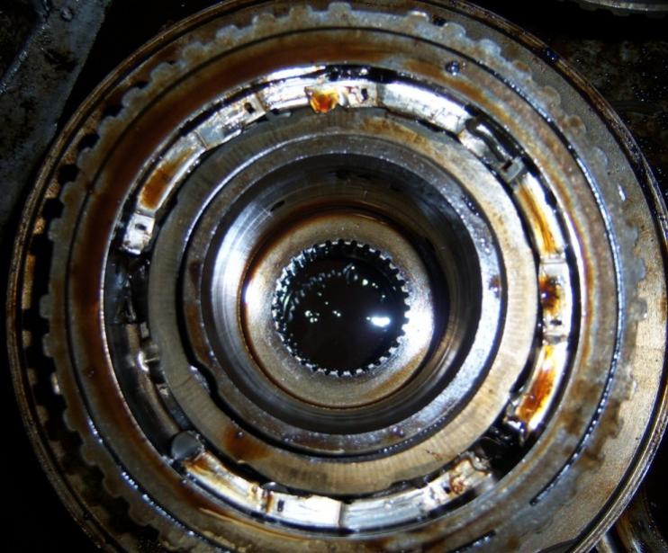

Here is a top view or a roller clutch that slipped when it shouldn't have. You see the result. Now that outer race that has teeth on it, that's where the intermediate clutch ride. So what happened to this trans, as that roller clutch came apart, it locked up in both direction and couldn't spin free one direction and hold tight in the other. So now the trans goes into 3rd gear, but yet it's still got a clutch pack holding that shouldn't be, kinda like trying to be in 2 gears at the same time, and it cooked this bitch to no end. This was the trans that came out of the 84C20 that was bad when I bought the truck for $100. The guy was towing a tandelm axle enclosed trailer loaded to hell, and the bed of the truck loaded to hell and was driving from Little Rock, AR to Abilene, TX on a trans that had over 150,000 miles on it, and with 3.21 ***** gears. Cooked it !! Light's out, all done !!! He did make it within 5 or 6 miles of his destination though.
attachment.php
Here is the intermediate clutches and steels that were riding on that intermediate race. A bit toasty !!!
attachment.php

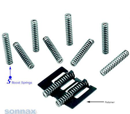

And I'm still not finding the Sonnax release springs but I have a pic.
attachment.php
NOw you why I haven't built it yet. Gonna take some funds, but the bitch will take some abuse and I have all of intentions of trying to tear it up. I'm going to flat ass abuse the hell out of the thing. Tear it up, find out what failed and back to the drawing board. Also why I might even go with a NP205.

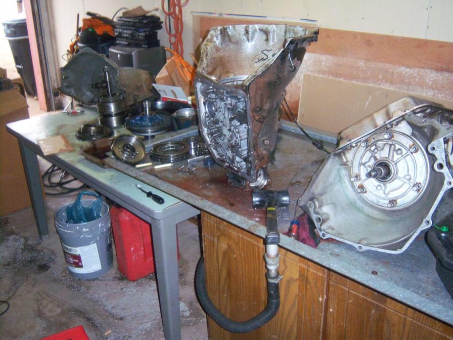

Right there's the baby. 1990 K case 700r4 just begging to be built at the end of that table.
attachment.php
And if I break that case, then I have this 87 K case as a back up, and I'll build that ****** and blow it to smitherines too. Cores are cheap and most of those parts I listed, can go from one trans to another. Alot of those parts aren't wear type parts. Can't be to afraid to play hard and if you are, then you need to sit on the porch and watch. That's always been my motto, and I"m not going down any different either.
