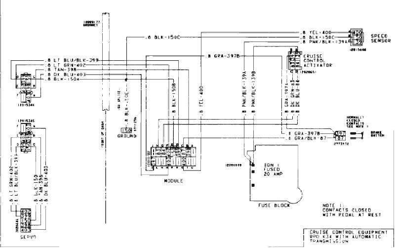

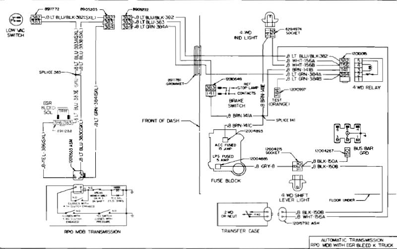

After studying the wiring diagrams all day (at work :LOL:) I am wondering if things are plugged in wrong.
this pic shows the LT BLU and BROWN wiring on the same switch with the brakes. This pic is in a thread on this forum. That clear plug is on the other switch with the red plunger in my truck.
Wiring diagrams show LT BLU and BROWN to brake switch with reference to stop lamp. It shows 2 GRAY and 1 GRAY/BLK to "brake switch". I assume that this means the release switch with the red plunger and not the black switch since the diagram says REF STOP LAMP for the LT BLUE and BROWN.
Do you think it will make a difference if I switch them around. Could I have switched them around when I tried to take off the cruise or maybe it got messed up when PO made the engine swap?
