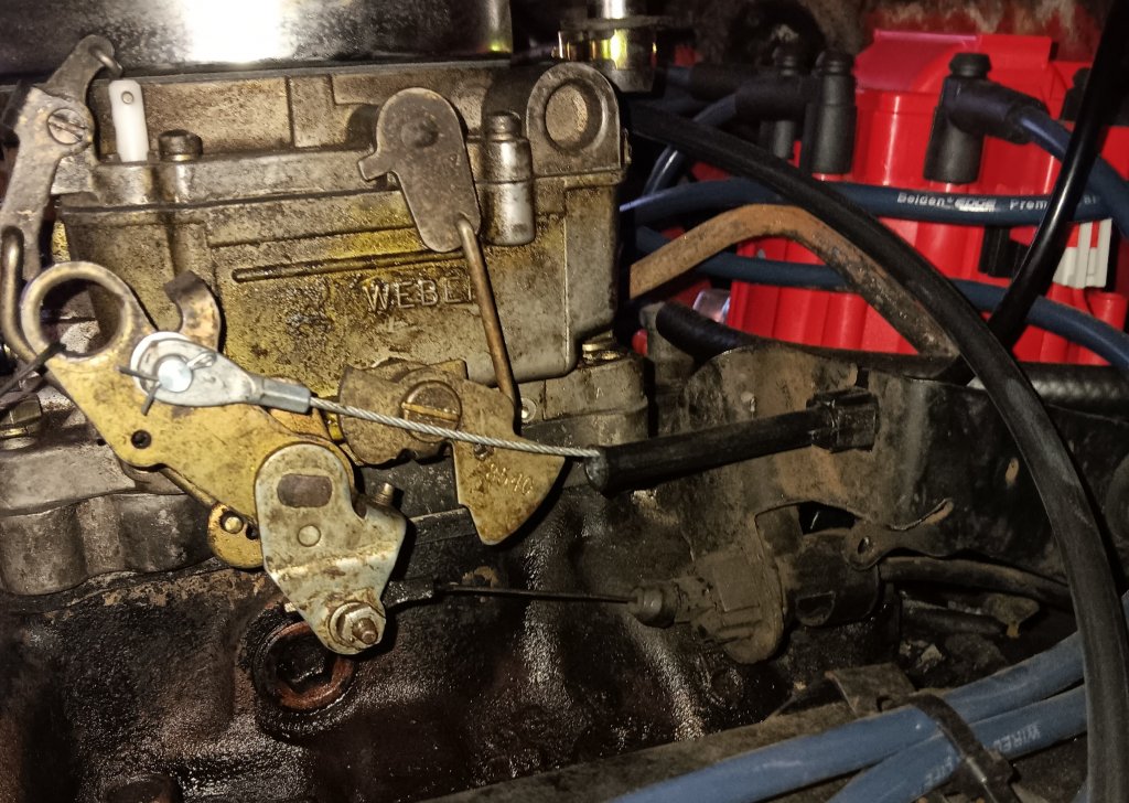

My 1983 GMC c1500 has the original 305 and 700r4,
but a prior owner installed an Edelbrock 600 on an adapter and it wants to shift earlier than I would like.

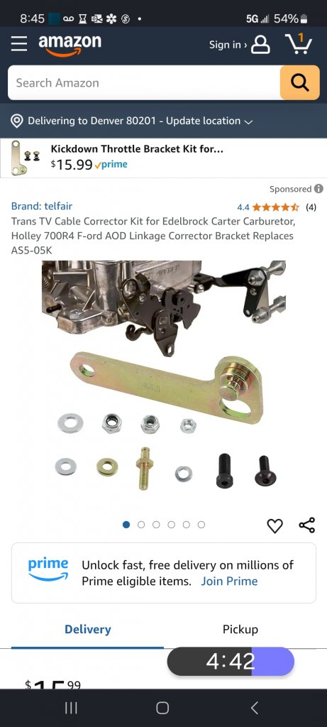

Searching the internet I see some cheaper ($15-50) corrector kits that only have an adapter for the carburetor arm,
or more expensive ($120-150)kits that have a new bracket that attaches to the manifold also.
Has anyone on here been in my situation and know what I need to adjust it right?
Attached pic of my current set up.

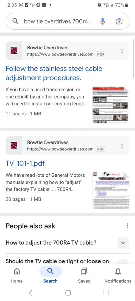

Go to bow tie overdrives 2nd link in my screenshot, download the pdf read it and study it, hopefully it explains things in a way that you will be able to set your car up correctly.

the bracket, as long as your engine was originally 4 barrel, is fine, but if your truck was a 2 barrel(305...? no qjet in sight... smells like it was a 2 barrel to me )the bracket isnt in the correct spot.
@PartsMan79 do like Ricko says and research the setup instructions on bowtie overdrives website. I'm using their TV Made Ez system to control the 200-4R under an Edlebrock carb in my Camaro. It's well worth the price if your not confident in the system you currently have. I had nothing for that car since I replaced a TH350. I'm not affiliated, but I've been enjoying the overdrive trans they sold me for almost 20 years.

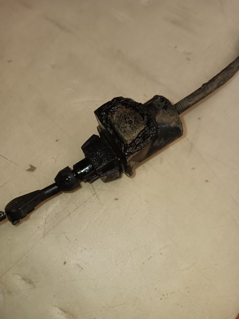

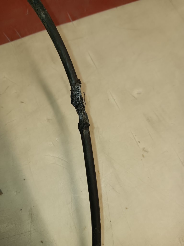

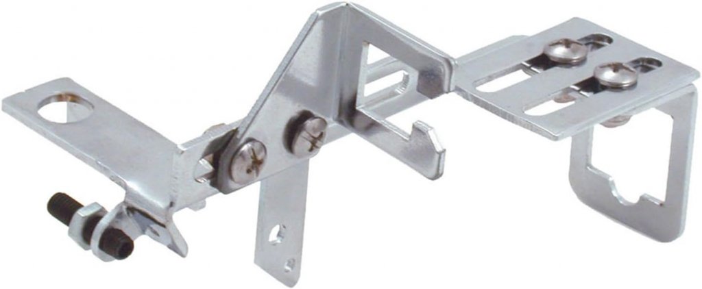

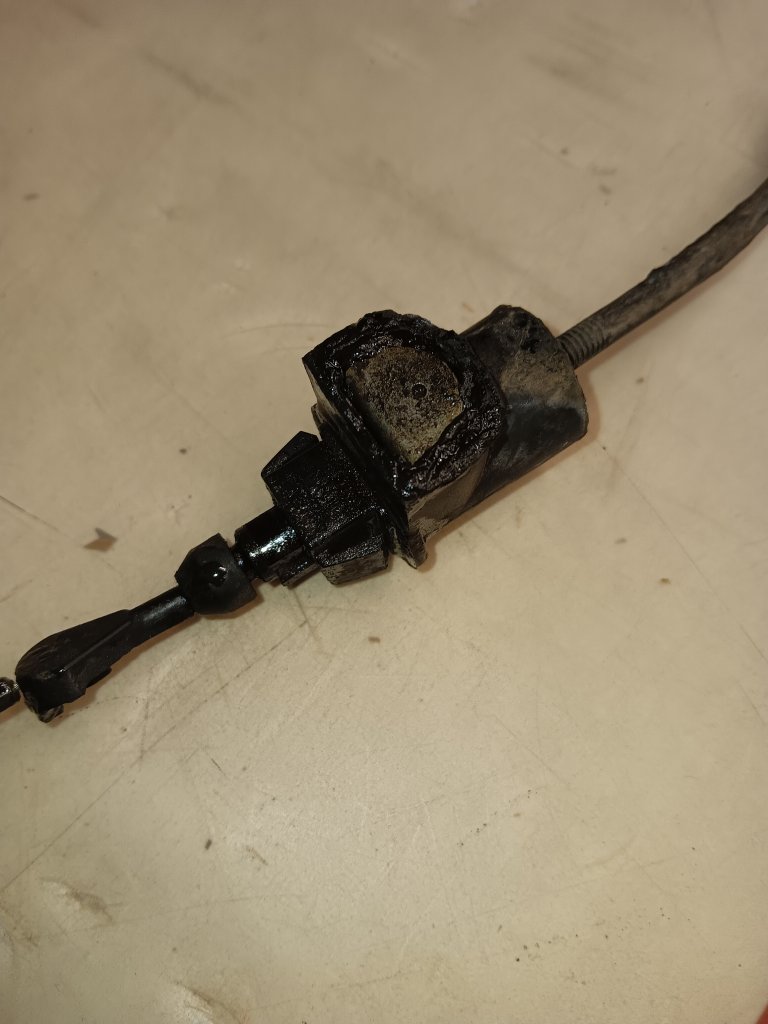

Sorry for the lack of updates. Life, weather, and a wrong cable have slowed this project down.
I found the real problem. My TV cable was damaged in a small fire I had last year and cannot be adjusted.
I now have the right cable stabbed in the transmission and a adjustable bracket waiting to be put on.
