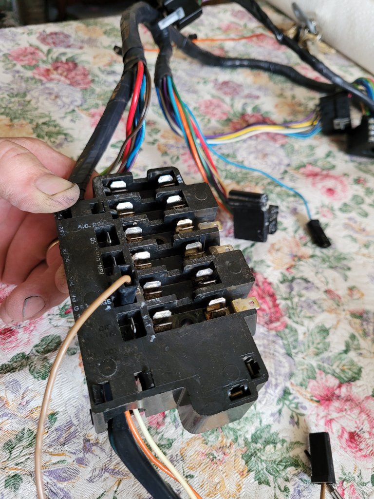

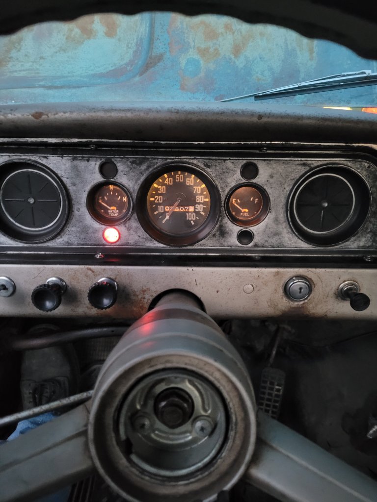

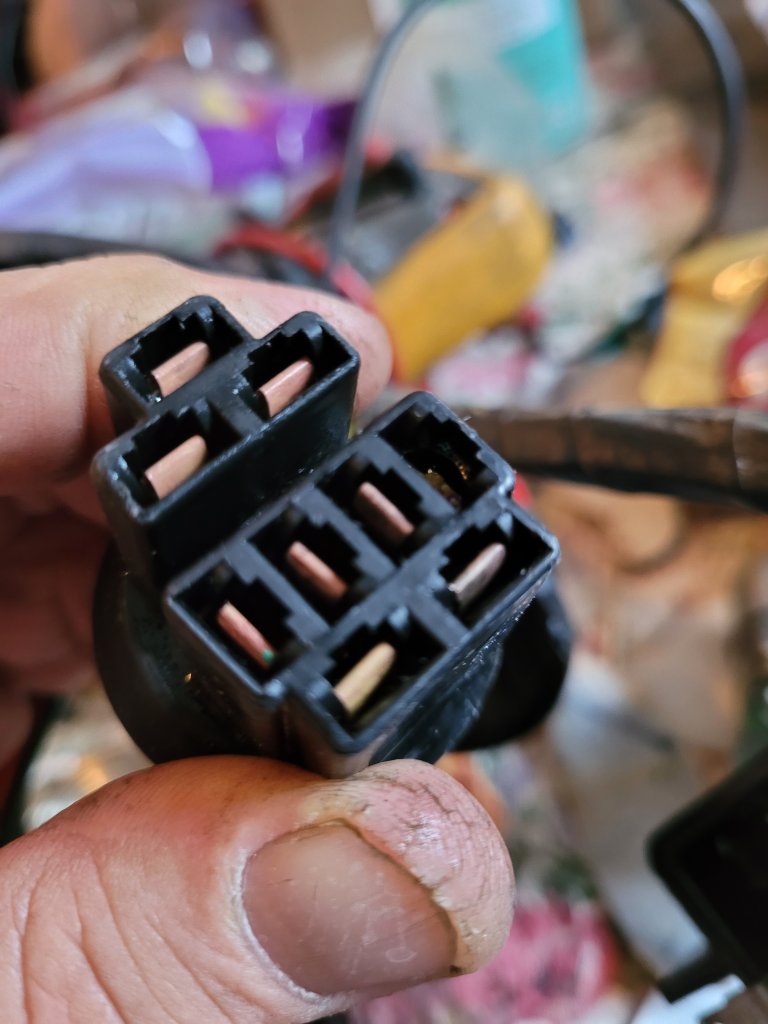

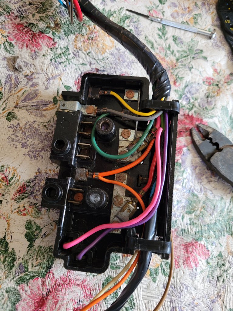

After.
A vinegar soak does wonders on nasty connectors. Had to replace some parts. The printed circuit was fried. Probably from when someone hooked the temp sender wire to the coil hot post...
Dash all works now except the fuel gage.
