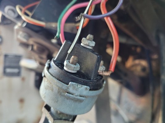

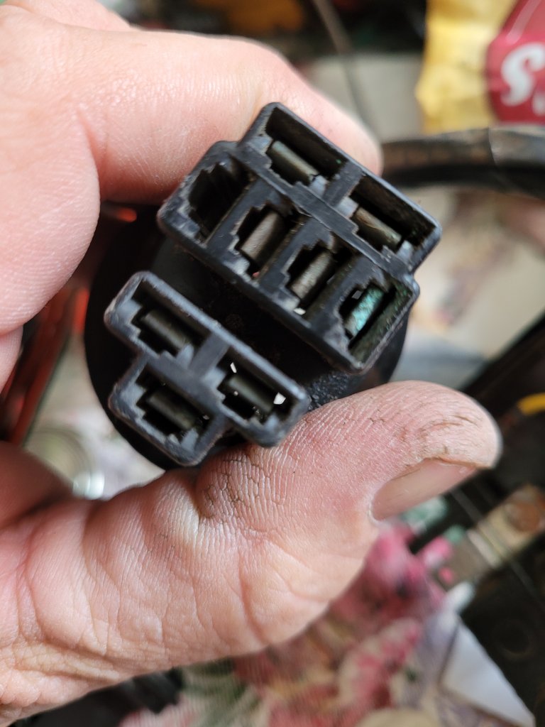

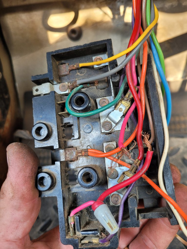

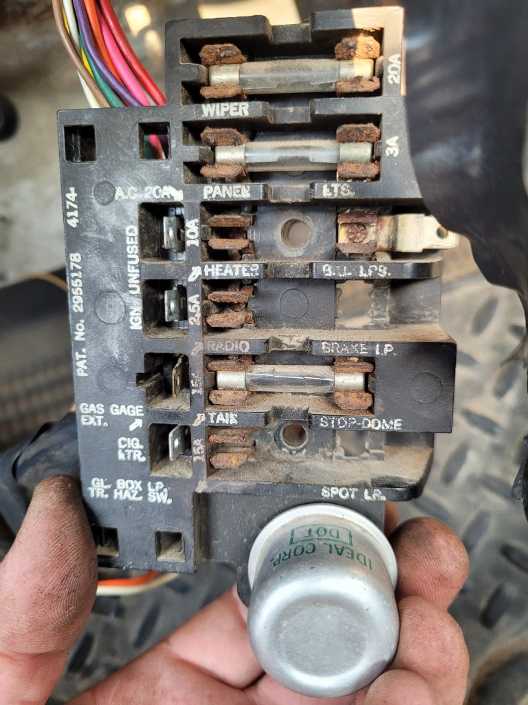

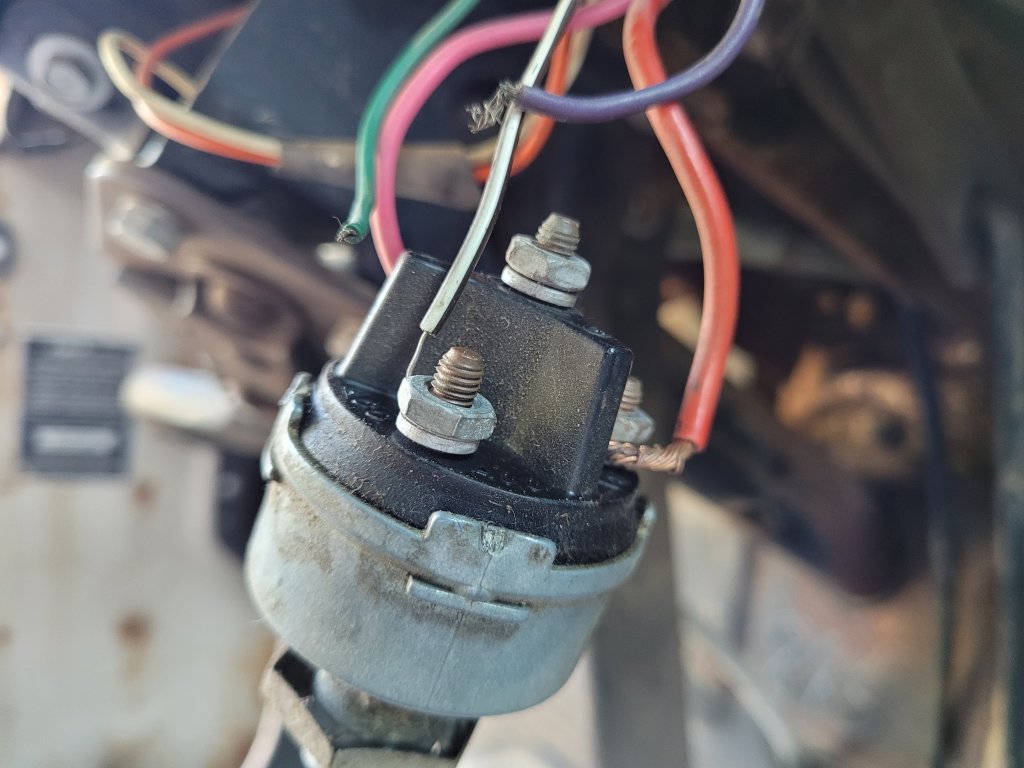

At this point it was the beginning of September. I had been driving the truck some. In the daytime. Not too far. Remember, no dash but the speedo.
I had bought a box of stuff from LMC and was fixing little things. Door lock was one.
The ignition switch was wonky and I thought I'd fix that one day real quick. Just replace the Ace Hardware one for a stock style. Easy peasy. Nope.
When I pulled the switch out of the dash most of the wires just fell off. I had no idea where they went. Finding the right diagram was a challenge until a guy on the 64-66 GMC club forum hooked me up.
By then I had traced back pretty far up the harness and found a whole slew of issues. Ended up pretty much rewiring the whole cab. Tried to keep it as stock as possible. Used parts of 3 harnesses.
