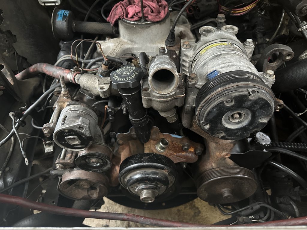

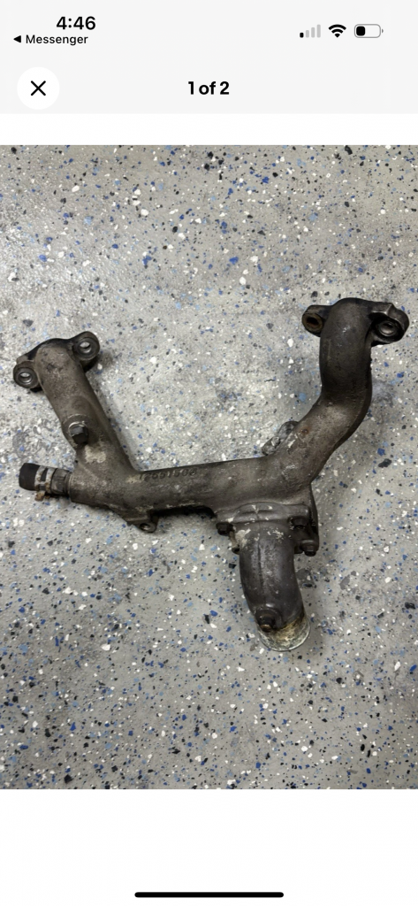

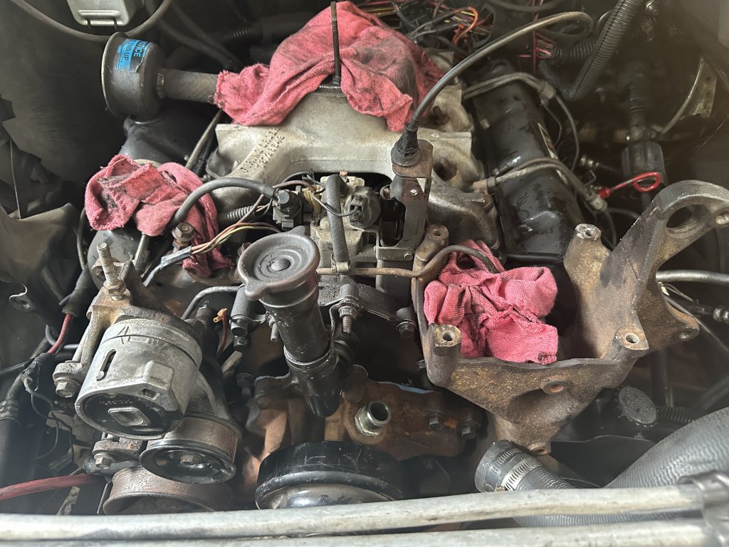

Bringing back this old thread.
Im so glad i found this because i thought i was the only one doing it.
Im doing the same EXACT thing right now.
I have a 6.5 in my 88 suburban that was swapped but they kept the original v belts and brackets from the 6.2.
Squealed and belt dust everywhere. I bought a kit from a 99 and everything was going well until that damn crossover tube.
I found one off a P30 motorhome that MAY work without alterations. I have the mechanical injection pump and had the Cruise control mounted to that. It was in the way of the new compressor location, so it had to go.
I live in florida so want a modern ac compressor, and everything was routed to have it on Drivers side and Alt on passenger.
Heres a pic of the crossover tube that hopefully will work with minimal fabrication. Will update when i receive it and installed.

Did you change the water pump?
capnsquarebody
Aug 3, 2025
St Augustine, Florida
Justin
R2500 Suburban
6.5

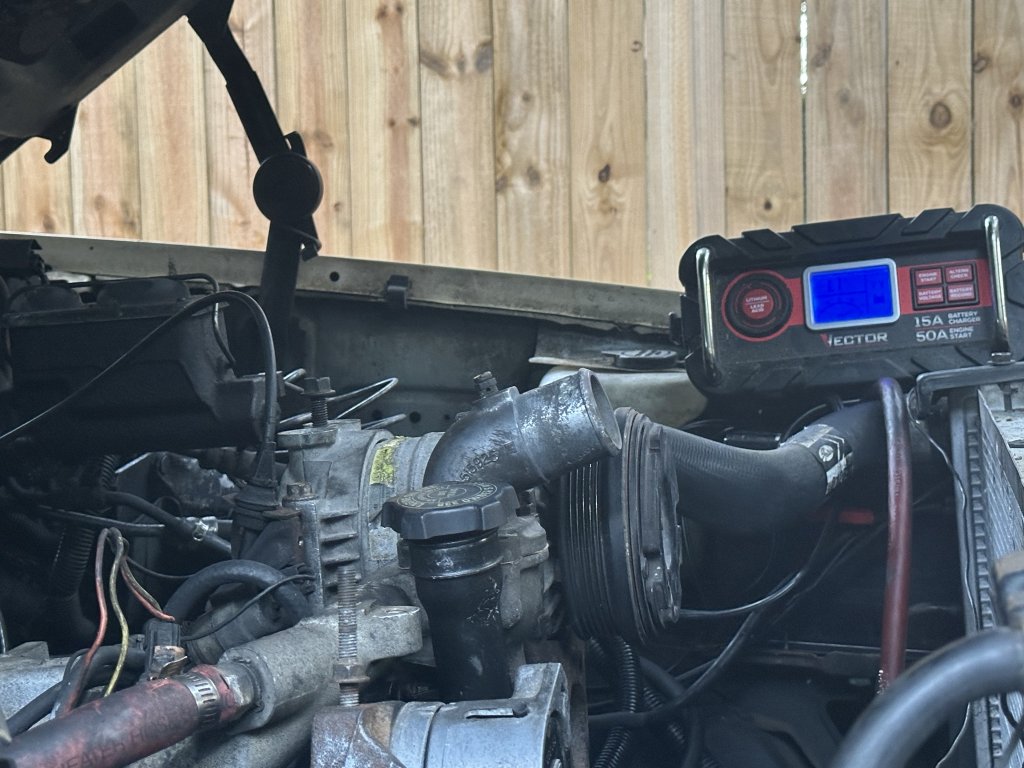

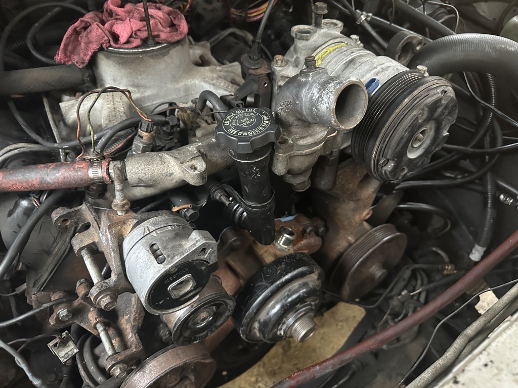

Yes I did.
The guy that sent me everything included the pump. Its the higher flow reverse rotation with pressed on pulley.
His truck was a ‘99.
I had to order the reverse flow backing plate though. In hindsight I wish i bought a new pump because of how entailed it is to install but this one seemed fine and weep hole showed no signs of leaking.. (this projects getting pricey so im needing to save where i can)
I got the crossover tube installed and the thing fits exactly as it should. I was really pleased that it came out fitting perfectly with the only mod needed was re routing the steel fuel return hose a bit.
The thermostat inlet does angle up a bit and im concerned itll chafe or rub on the hood when closed. But seems to shut fine. Ill probably have to make a custom upper radiator hose.. no biggie.
Heres a pic of the crossover installed.
