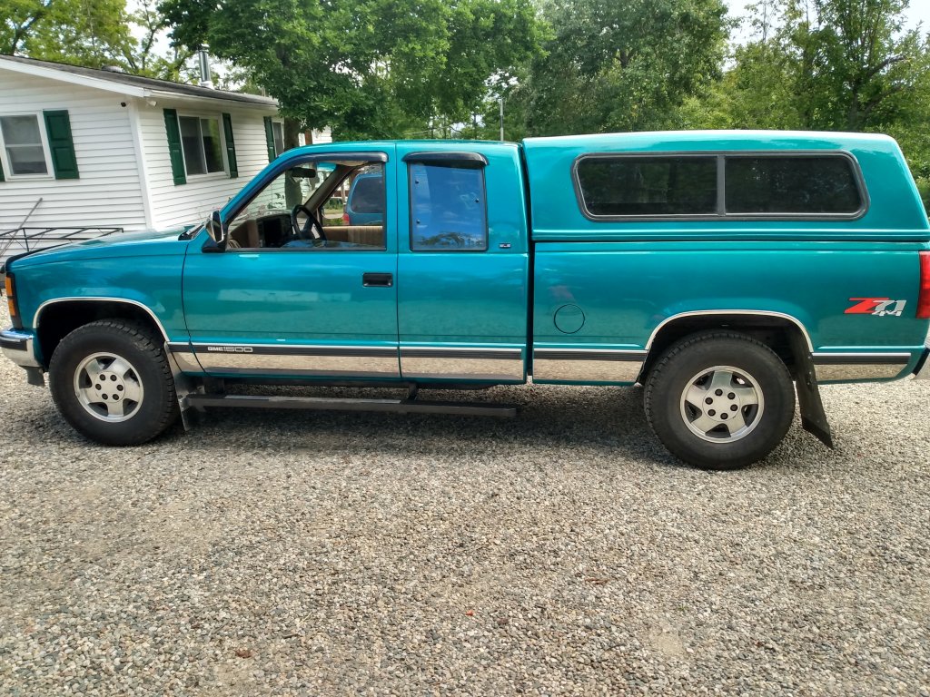

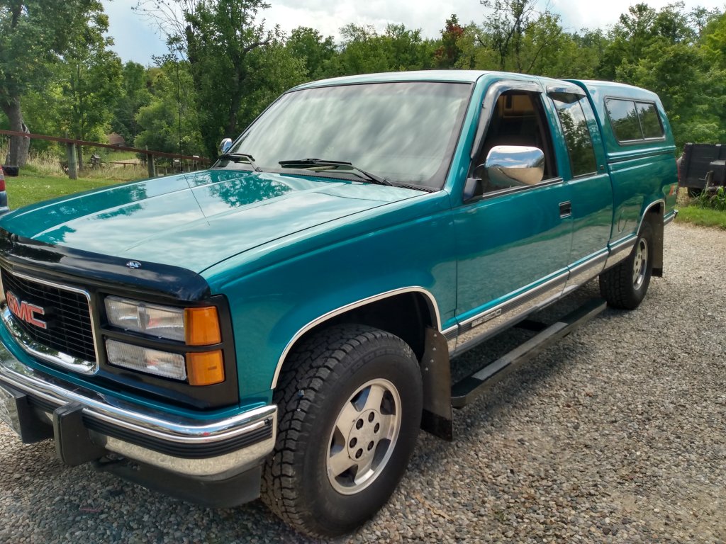

Hello, well I got 94 GMC with 5.7 and only 155,000 miles,,truck is like brand new,,I change oil every 3000 miles,only use good synthetic oil. Let it warm up in winter,, I take good care of my truck. Other day heard noise???? Stopped open hood sounded like someone in engine with big hammer. I dont understand why this happend? Any ideas??
Got a 4 bolt main with roller cam going in it now with long tube headers,, should be good to go??
