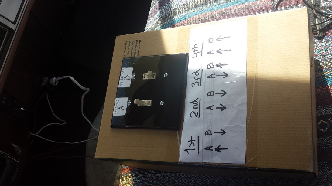

i have wired up toggle switches and undone the modified harness connections i quoted previously. 12v (+) to pin E and solenoids are grounded. STILL STUCK IN LIMP MODE. Did i do something wrong? :shrug::whymewhyme:

A Sol A (1-2) Switched GND (plug---toggle switch---ground)
B Sol B (2-3) Switched GND (plug---toggle switch---ground)
C Pressure Control Solenoid +12V
D Pressure Control Solenoid Switched GND
E +12 Power (plug---switched 12v)
L Temperature Sensor Signal
M Temperature Sensor GND
N Pressure Switch A
R Pressure Switch B
P Pressure Switch C
S TCC Solenoid Switched GND
in RED is what i have wired

Here is a table for solenoids(copied from one of 4l80e sites)
Shift Pattern Sol A (1-2) Sol B (2-3)
Park ON OFF
Reverse ON OFF
Neutral ON OFF
1st ON OFF
2nd. OFF OFF
3rd OFF ON
4th ON ON

*UPDATE* started checking wires and had no power to switched 12v wire. So i rerouted to the (+) junction block and wallah! solenoids finally started clicking. took her for a test drive all 4 gears are available at the flip of a switch. thanx again:cheers::party36::party36:

So is this using the shfiter and switch method, or just the shifter?
Column shifter in "D" and toggle switches.
