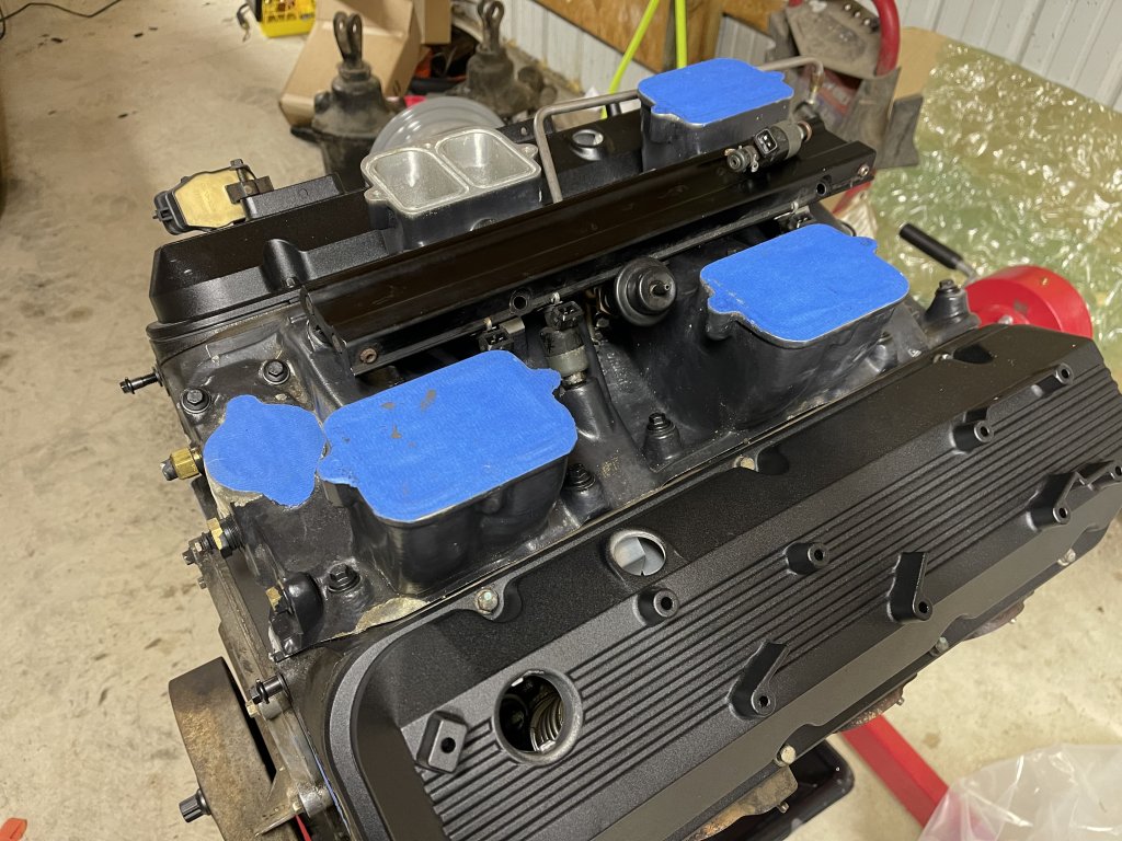

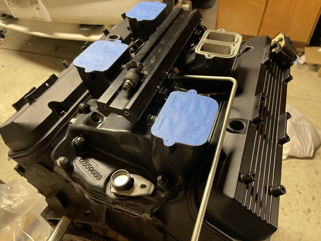

I got a lot of interest in my engine for my 78 crew cab. Here is a photo dump.
What it is
Gen6 long block

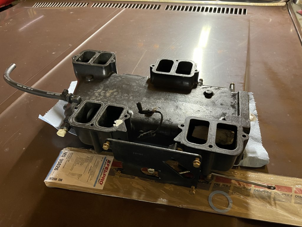

Volvo Penta 7.4 boat oval port intake
L29 valve covers for coil near plug
GM Big-Block Crank Trigger Ignition Conversion Kit

Following..... I've seen a few marine motor builds.... but when it's a big block marine motor, I'm excited

That is an interesting intake choice.
What made you choose that one for your truck engine?
I have a 1997 L-29 for my truck as well for when I need to refresh the one in my truck.
I went the simple pedestrian carb'd Edelbrock RPM for it though.
I will keep an eye on this one for sure.

I like it! It's basically Tuned Port Injection for a big block, by the looks of it.

Pretty cool looking. How’s the tuning for bigger cams?
