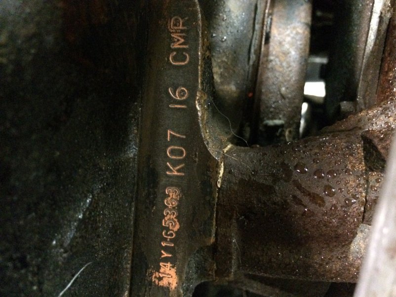

@chengny. I have a 350 block that's fully assembled and that port that's above the timing chain is not there. How else could I tell if it's a 2 or 4 bolt block without pulling the pan?
72chevy2door
Mar 19, 2014
193
26
Florida
Jeff
1500 Sierra Classic suburban
here is the stamping on the front pad. It also has 882 cast iron cylinder heads

I think it is a '74 and if so it came with a 2bbl and an auto trans.
Casting code on the rear of the block tells us more , but nothing will tell you for sure if it is 4 bolt mains without looking.

It's a CMR suffix
So it is! Well then that means the bore needs to be measured out because CMR refers to a 305 not a 350.

There is a 1974 350 and a 1978 350 with CMR also.
145 hp and 220 hp. The '78 is a vette listing - don't know if that helps the chance of being a 4bolt !
Man is my brain not working this morning LOL. :yawn:
I would say or hope that this is more the LG4 version of the engine rather than the L82 but who knows.
