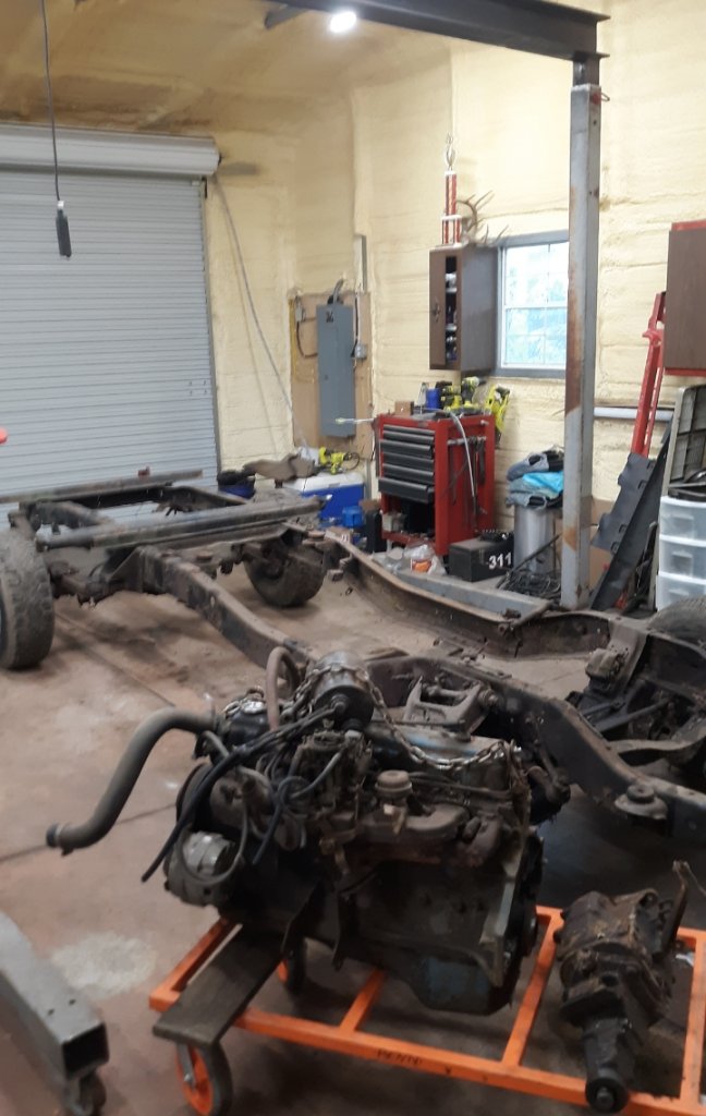

This is mostly to see what opinions are out there. I am doing a frame up resto on a 78 GMC c15. I already have a 427 pushing 555hp. I want to keep the 3 on the tree because, I'm weird, I guess. Dearborn, M13 seems to be the only valid option. I do not yet know what rear gears I am going to run yet but, I am going to fab a 4-link rear. I am not racing the truck but, I am definitely going to play.
I'm going to pay for asking this but, what do you all think?

Even the Dearborn would not hold up for this project. I have tugged on a lot of threads and keep coming up with the same answers. I was considering the SM465 but that granny gear has me on the fence. This is not a 4x4. I could just run 2nd - 4th but can't make up my mind. It would definitely work! Th400 is easy to find and can easily be made to work for this build. An uncle suggested a 2 speed Powerglide but, I hear about them being grenades.
You see these awesome hot rods and see the shows but, until you're into one, you don't realize just what goes into it.
12,125
19,430
You don't use granny gear unless you're working the truck. Otherwise it's just a 3 speed, a strong 3 speed that will handle the engine, and would be minimal swapping since you already have the three pedals, etc.
