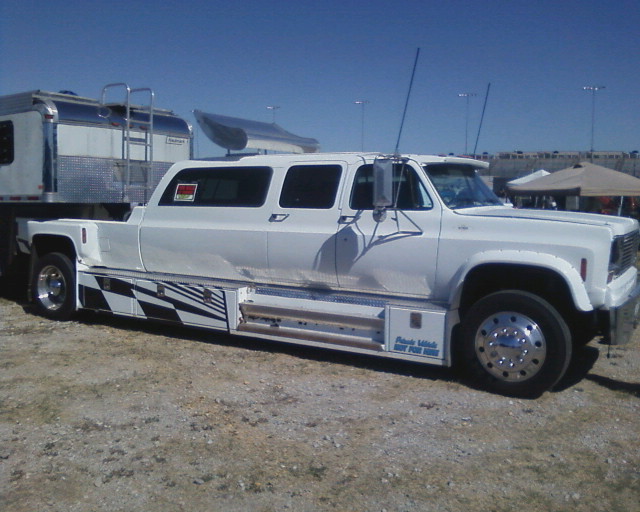

sounds like you should get a c 60 truck and put a sub body on it I think that would be far less work than making a half or 3/4 ton sub do what you want
a c60 is a 2 ton truck
you can get a c60 with a 2 speed rear axle

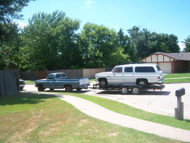

Am I understanding, all these questions are based on you wanting to tow 2700 pounds? As in 1 ton + 700 pounds? That's actually fairly easy to do with a standard as is OEM 3/4 ton Suburban. I've towed a 3/4 ton Suburban on a trailer that weighed at least 1000, so you might just call that 4000lbs for the Burb and a 1000lbs for the trailer, that's 5000lbs and I don't suggest this, but that was even without the trailer brakes set up. Yes, I was very careful cuz it didn't stop real well. Towing truck was a 3/4 ton C6P truck with an OEM bone stock 454, Turbo 400 and 3.21 rear gear.
I'd say be more concerned about having trailer brakes working properly and your weight balanced properly on the trailer so it's not all tongue weight. Let the trailer carry some weight, that's what it's for.
3.73 or 4.10 rear gears should pull 2700lbs just fine. Of course 4.10's would be better but 3.73 would work OK. I had ***** wagon 3.21's towing this load. I was wishing I had 3.73's or 4.10's though. A slight grade and the motor started bogging and feeling the weight.
