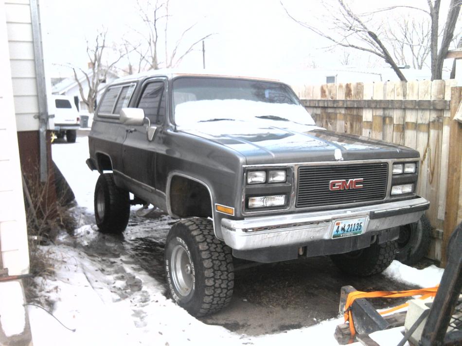

I have a 4x4 jimmy I plan to convert to a 2 wheel drive soon. how did you line up the front x member

i have some factory rear spring hangars as well as springs,that i was waiting to put on till i got some more feedback/advice.as far as lining up the front crossmember,it was quite easy,just basically removed all the 4wd stuff and set the whole front ends side by side(as i cut the entire front of the 80 2wd from the firewall forward)for comparasion,then removed all the nessasary bolt heads/rivets from the 2wd xmember,placed a jack under the 2wd xmember, lifted it into place on the 4wd frame,measured 10 TIMES,then marked and went through a **** load of drill bits!!! i also had four extra hands to help:) so do you recommend i use the 2wd hangars/springs with the 10 bolt/5lug(im going to be removing the lower helper spring and lower most leaf and making a perch with them for a 2.5 drop)as im looking for the lowest i can go? thats a NICE jimmy you have there im running the same clip on my 86 but with c1500 composite headlights.

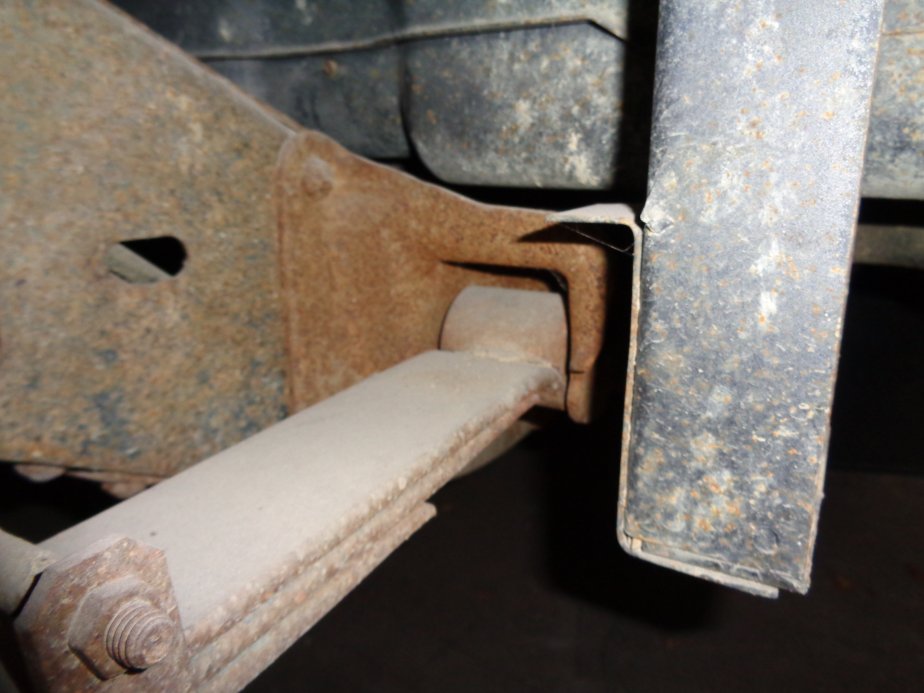

do you have 2 wheel drive blazer spring hangers they are even different than 2 wheel drive truck hangers.
the 2 wheel drive blazer hangers are like the drop hangers for a 2 wheel drive truck.
I will try to get pics of them

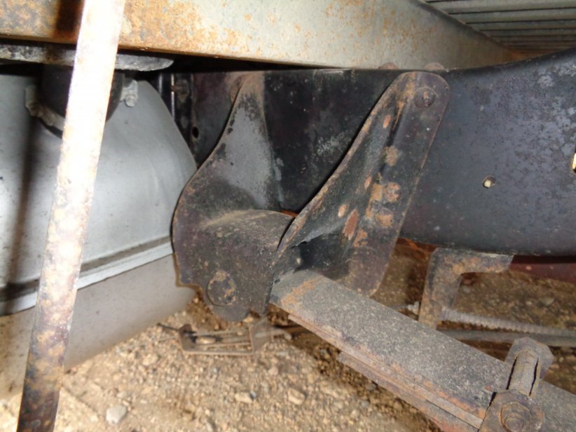

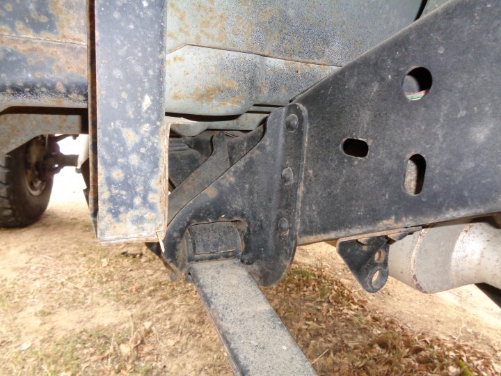

just went out and got some pics
first pic factory 2 wheel drive blazer hanger
second pic 4x4 jimmy hanger
third pic 2 wheel drive truck hanger

the two wheel drive blazer hangers are almost the same as the c10 drop hangers.

The blazer hangers also mount the spring a little tighter to the frame than a pickup hanger. Only the newer ones though, the '77 and older K5's used regular pickup hangers.
