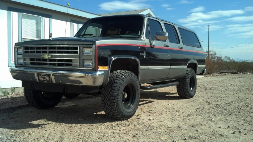

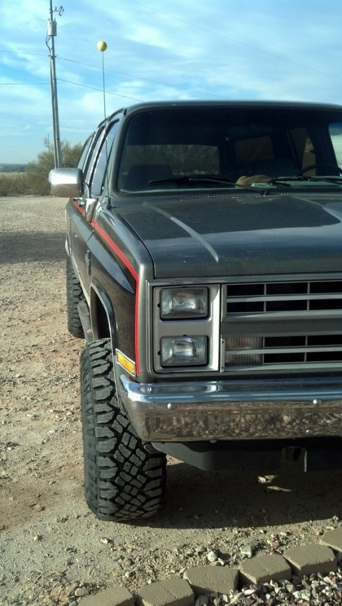

Here's my 88' Suburban with RC 2" lift. Front springs and rear blocks. The blocks are slightly tapered to give the rear driveshaft a little angle.
33x12.50x15 on 10" wide wheels.
The Rough Country springs ride a little stiffer than the factory sagged ones but I also put 4 new shocks up front so that will stiffen it up a little too. I'm happy with it.
I ended up 2.5-3"" higher than before so with the factory sag I'd say it's an accurate 2" lift. But yes I've heard the 4" is at least a 4" lift. But absolutely no drive shaft problems until you go to a 6". Especially if you get the transfer case drop spacers.
