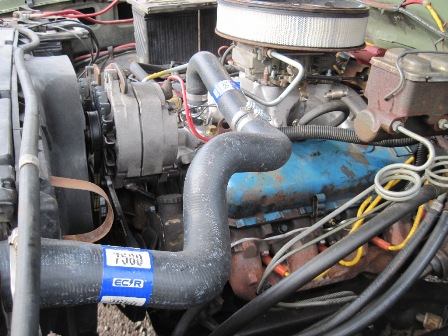

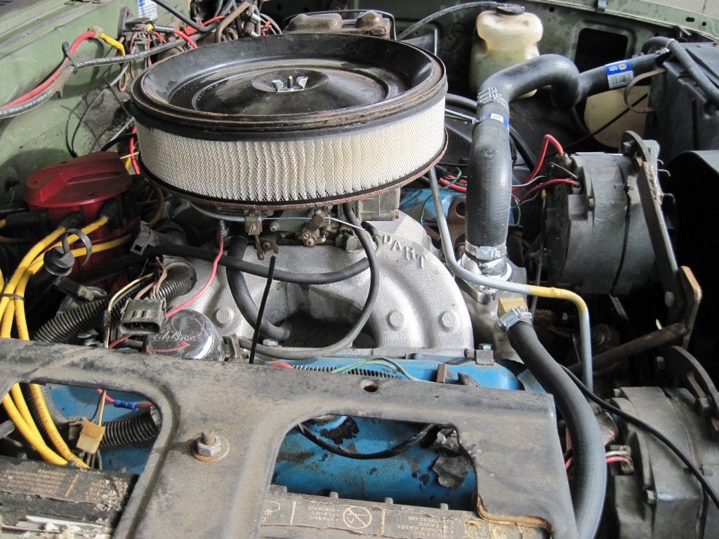

It has a hydroboost brake/power steering, and matching power steering pump, but bracket is going to be fun to fine.
Im going to leave the stock intake. Seems to be fine, and low enough. Also already had a long shaft HEI that works fine.
Intake is square bore already, so ill just run my AFB and my stubby short eddy air cleaner. Looks like itll work.
Did you have any clearancing issues at the pan? You put yours in a 2wd or a 4wd?
Also did you use a stock intake on either of your builds?
Both trucks were 30 Series 4X4 with a T400 transmissions.
The only tall deck I used a Dart because the stock one was a double thermostat version and was huge.It allowed me to use a standard water pump.
Since I was changing it I decided to use the short shaft to take the extra room at the rear of the engine.
