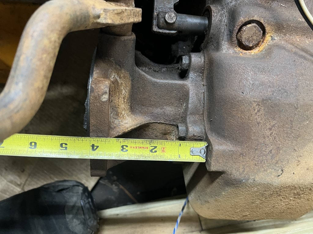

I could be wrong but my understanding is that you could switch out the input shaft with the one you need and if someone has a figure 8 trans adapter to measure I could measure mine and we could verify.
My 80 3500 400/205 is 4”

I also have a figure 8 i could measure if needed, mine was attatched to an sm465.
i too have this, in a 77 and 80 the only difference is the height of the adapter off the crossmemeber, the 77 is taller the 80 was shorter but the 80 has a slip yoke and 1 piece shaft vs 77 is still a fixed output and 2 piece so the height may be for the driveshaft idk.

alright I finally measured the adapter it is 4”. I have it behind a 2wd 4l80e with a spacer. I trimmed the input and output shaft to make it fit.
