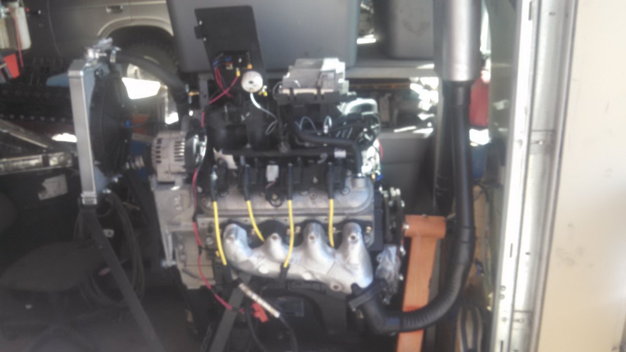

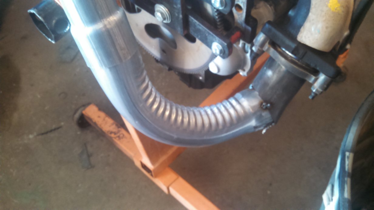

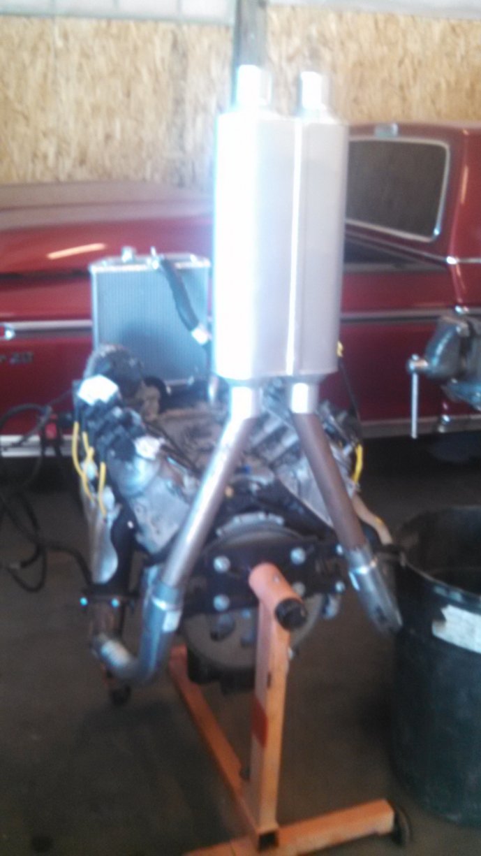

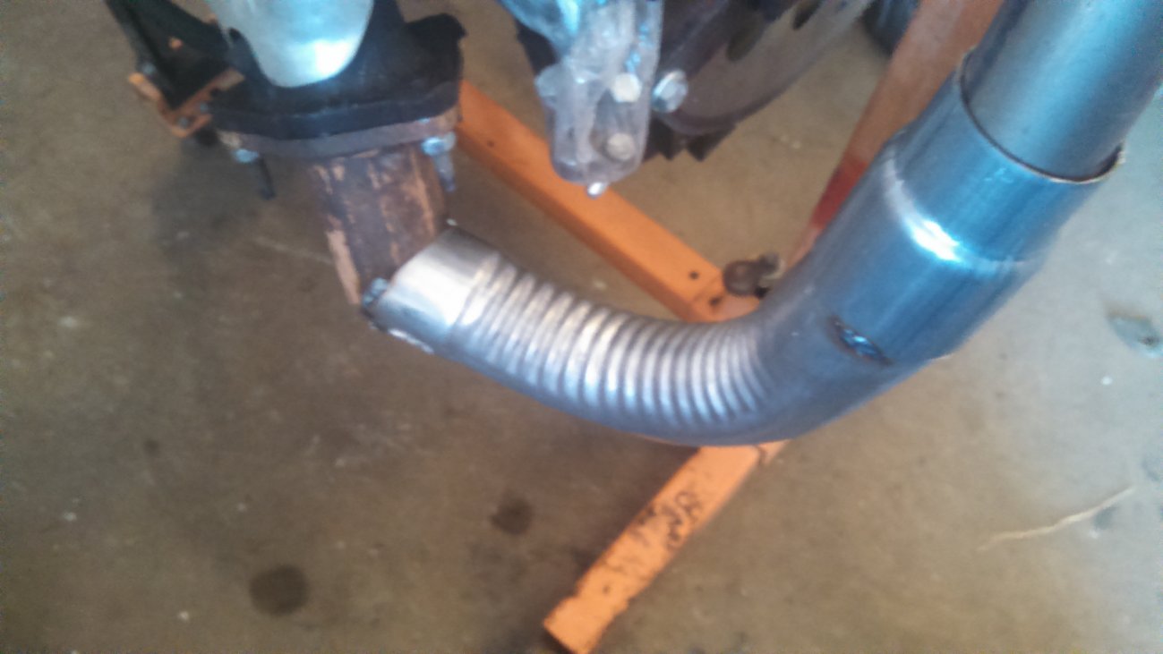

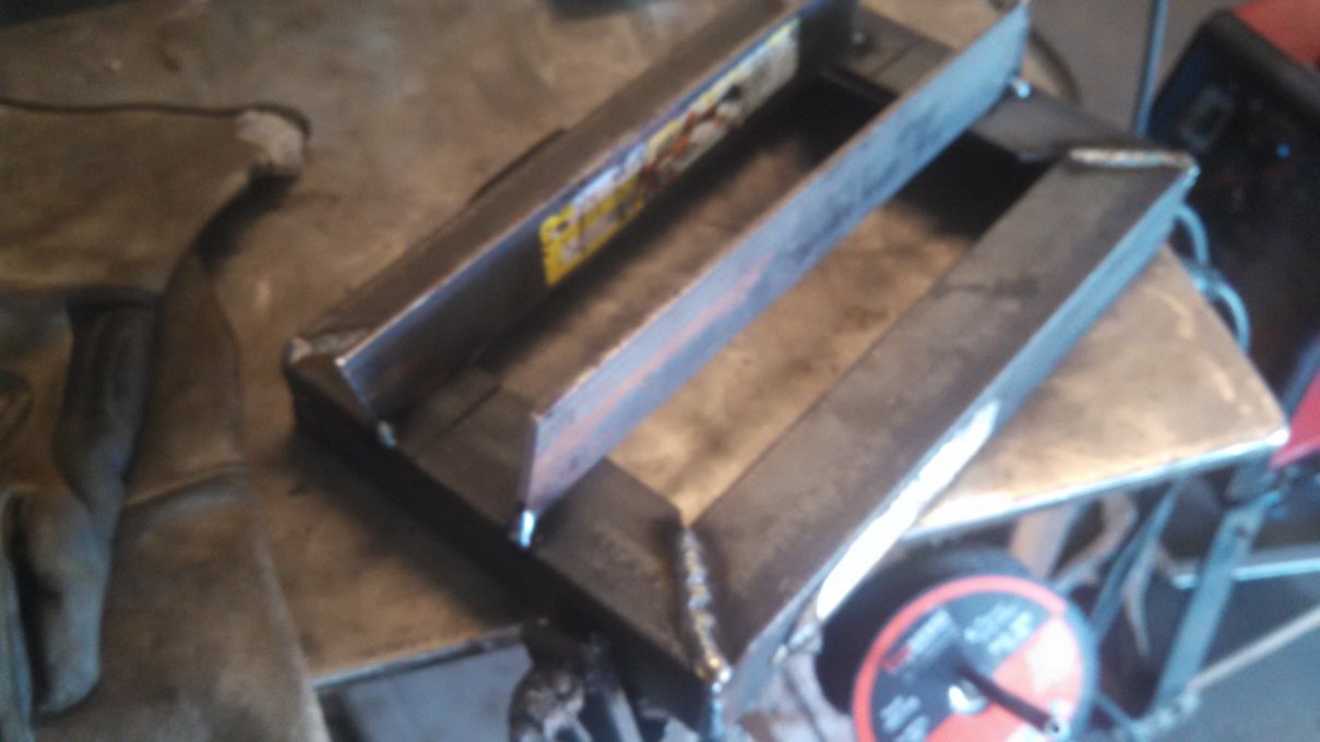

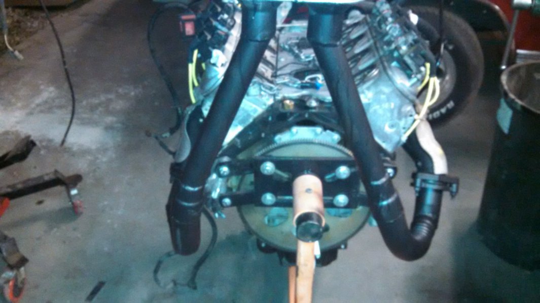

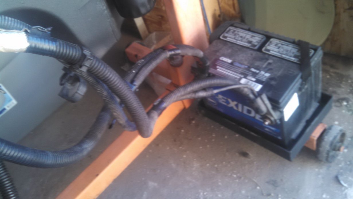

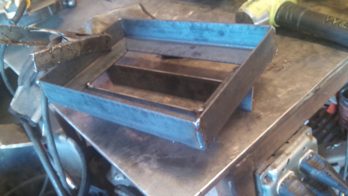

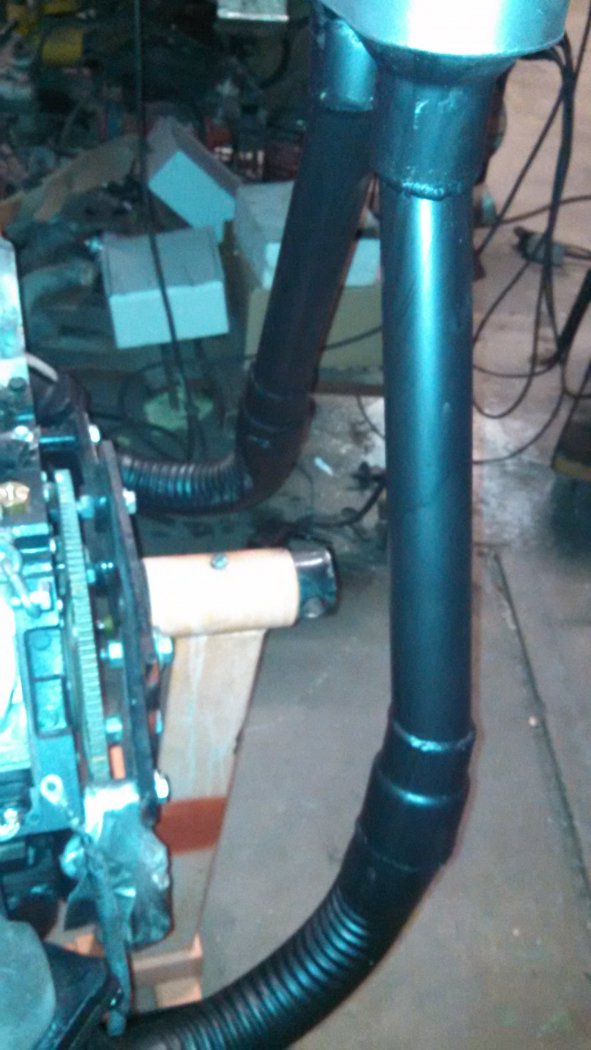

On saturday I fab'd parts of the exhaust and today Jake did some welding and tack welded things together. Will finish a full weld job shortly
The goal of the exhaust system here is to be quiet and not efficient at high RPMs since there will be no high RPMs.

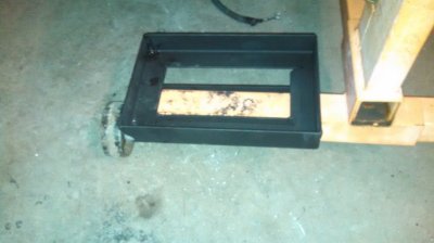

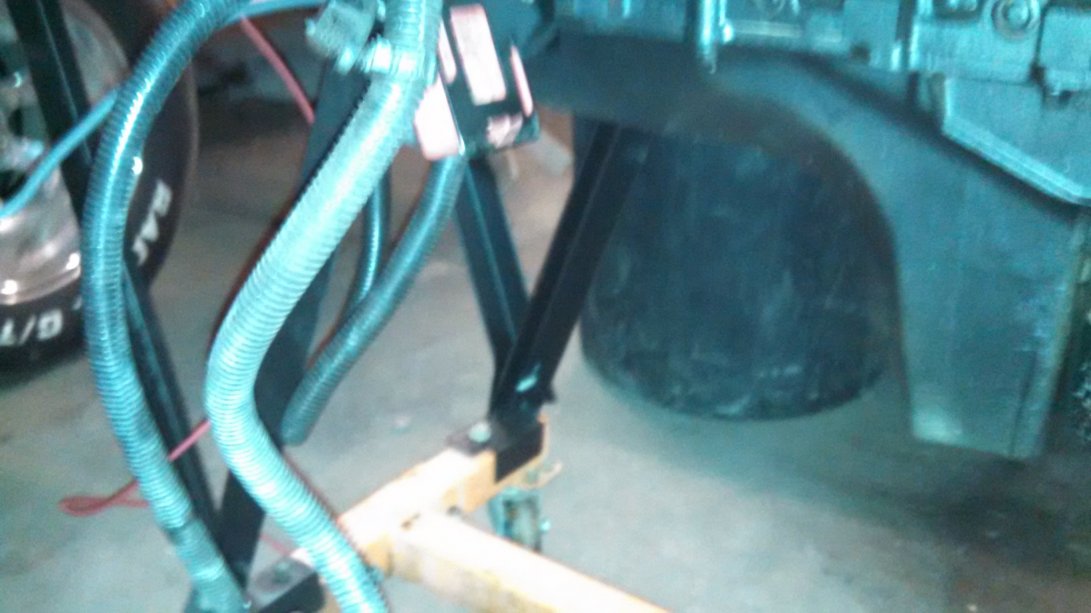

While the battery tray is to be placed on the rear cross arm of the stand and hold the battery so one can move the stand without effort of the battery tagging along. All ideas for this came from AGearHead4Life

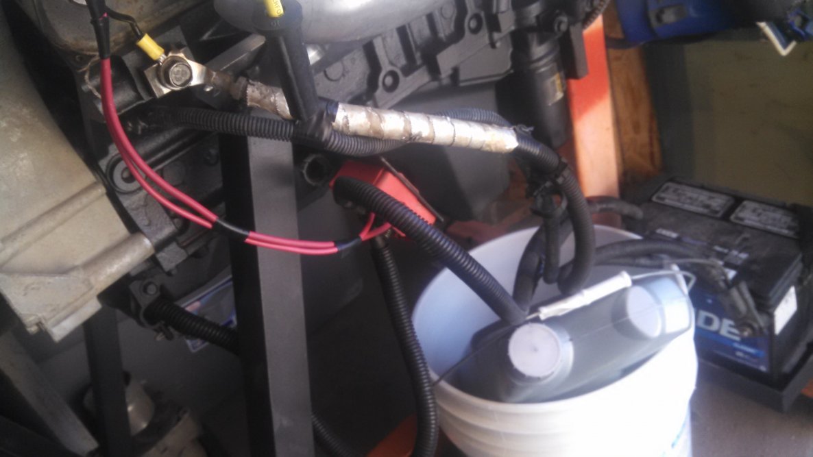

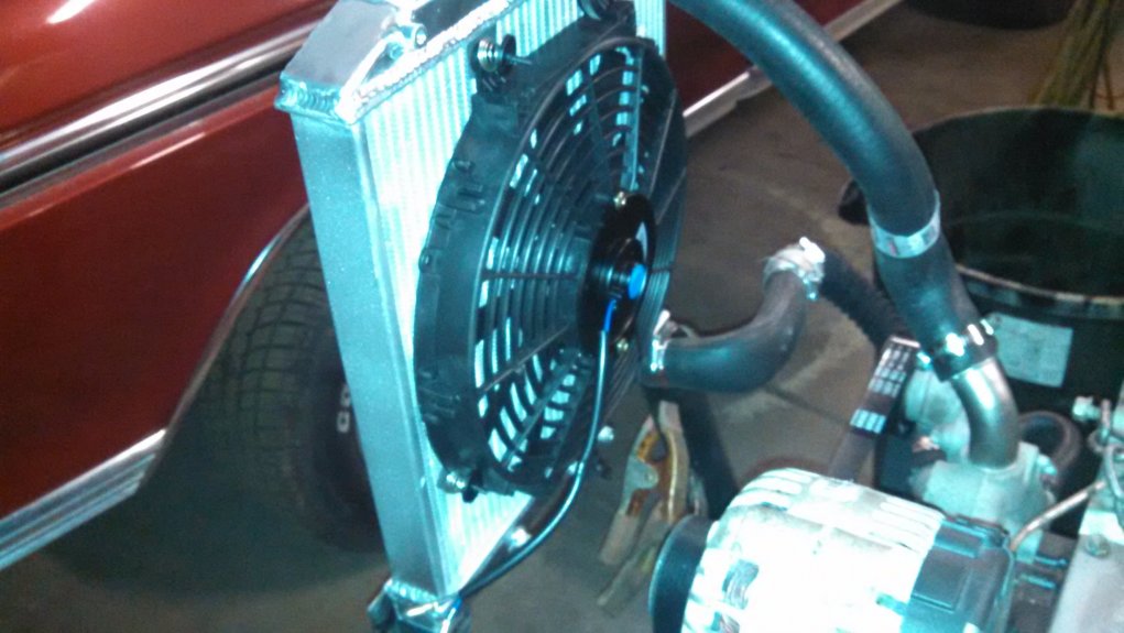

Had to go to work early this morning so I got home and worked on the engine this evening.
Installed the fan onto the radiator
Jake finished welding the exhaust pipes to the muffler, so I painted it with high heat paint
painted the battery tray last night and this morning (early) and mounted it tonight
adjusted the + and - battery cables so they will now reach the battery.
took the harness to the car wash and WASHED IT - it was dirty, much cleaner and easier to work with now
sent the ECU to www.lt1swap.com to modify VIN and update the OS to a 2002 Silverado version. Cost $75. Sure I could have done it myself, but it would have cost $100 to get a license for the 2001 Tahoe it WAS.
Left to do:
1) Harness
2) Control panel
3) Examine the ECU image via HPTuners after it gets back
4) electrical

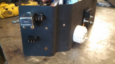

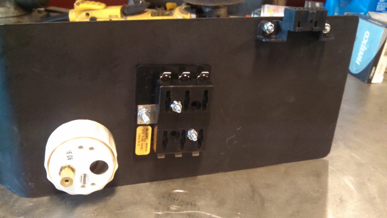

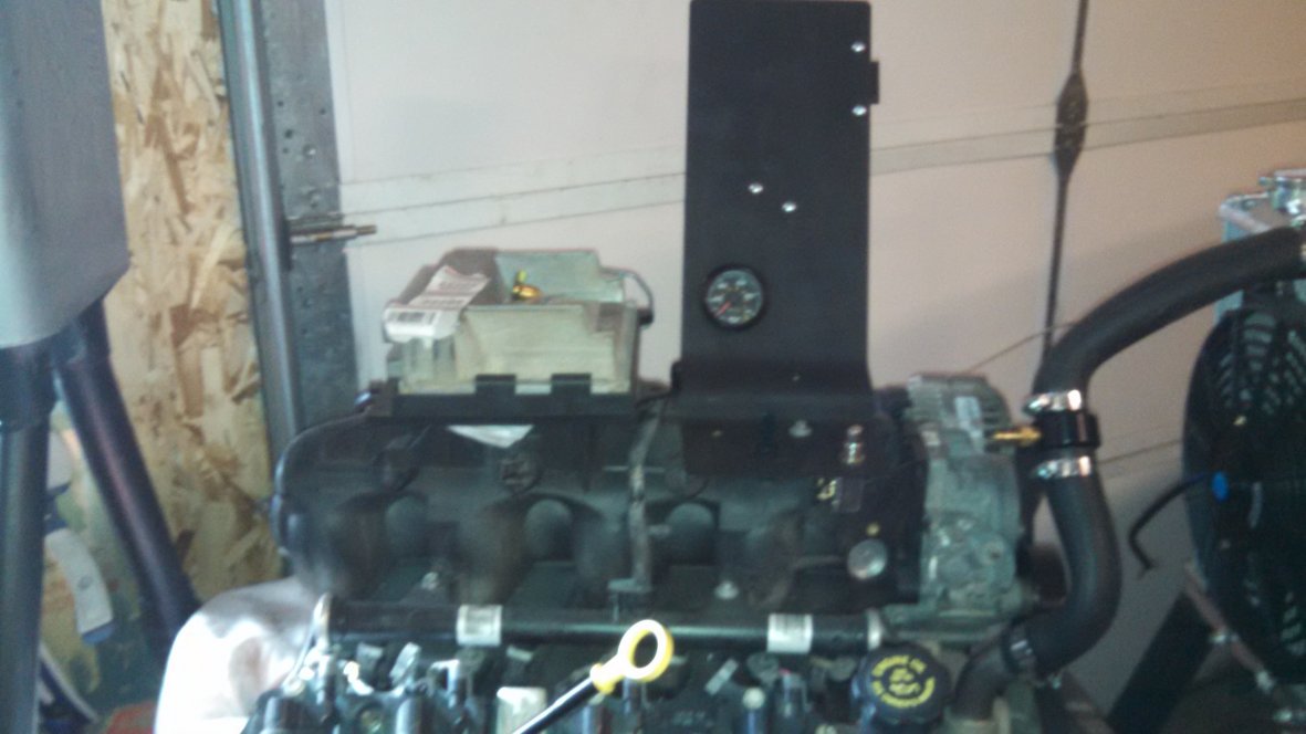

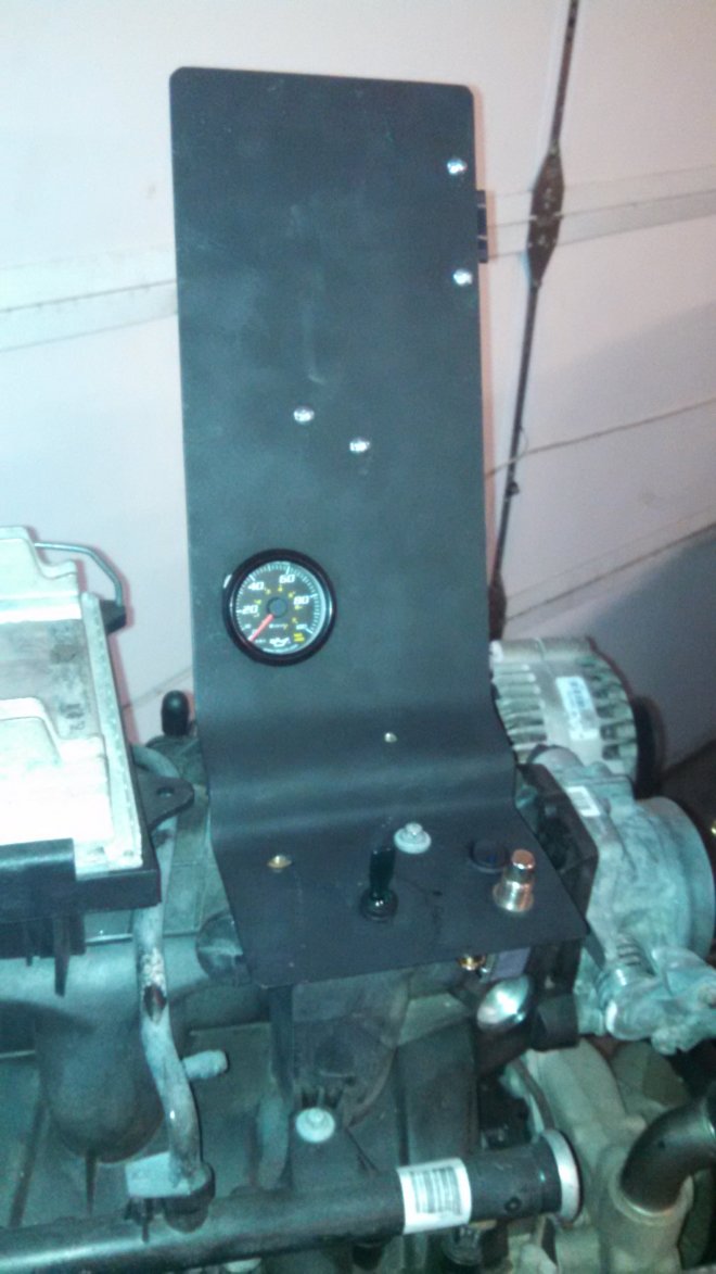

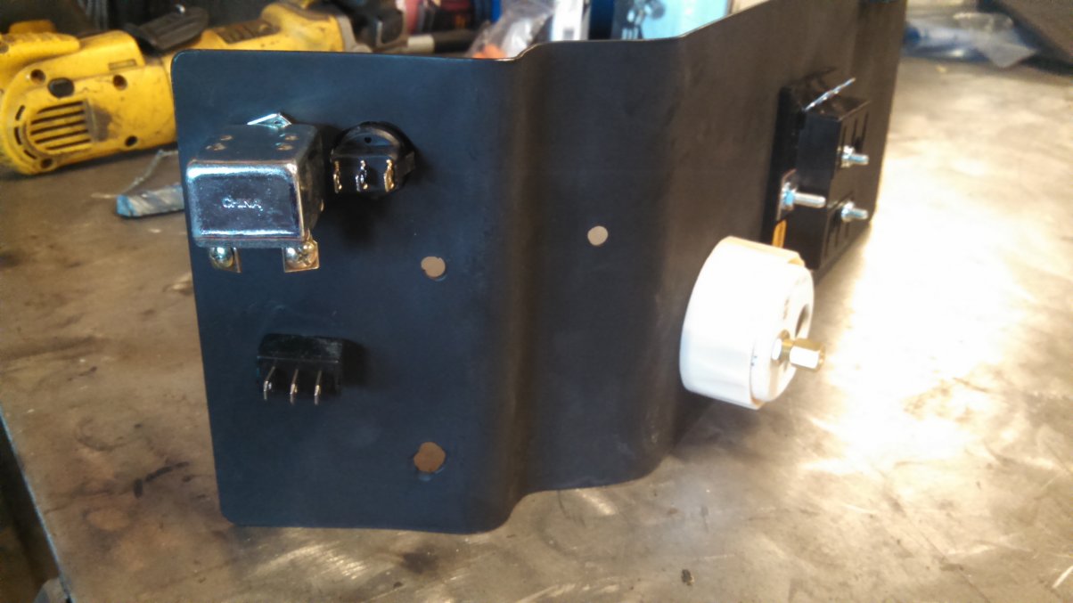

made a "gauge and control" panel out of 16g steel, formed it to fit on top of intake and painted it black.
Then:
Installed mech oil gauge
ignition switch
starter switch
fan switch
space for:
ODB port
fuse panel
old android phone to use bluetooth to communicate with the ODB dongle
Installed a new ALT power line (with rubber boot) down to battery junction connection.
bought a new battery
removed most of the loom off of the wiring harness
found a better lower rad hose that is 1.5" by 1.25" and it fits great
As for the harness mod, I will follow the instructions I used from www.lt1swap.com on my PU and do the same here. Remove all useless wires, then place on the engine to allow for wire length measuring. Will then shorten most wires for proper fit.

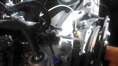

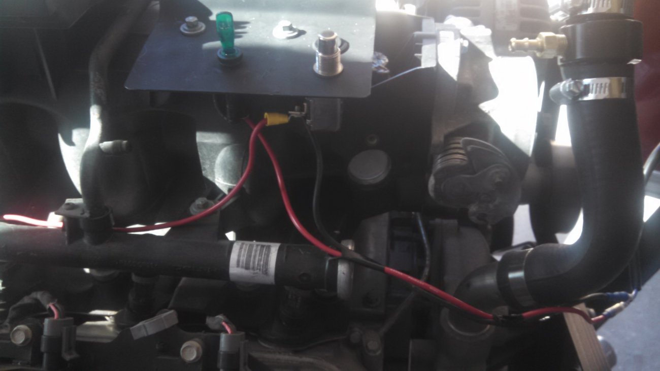

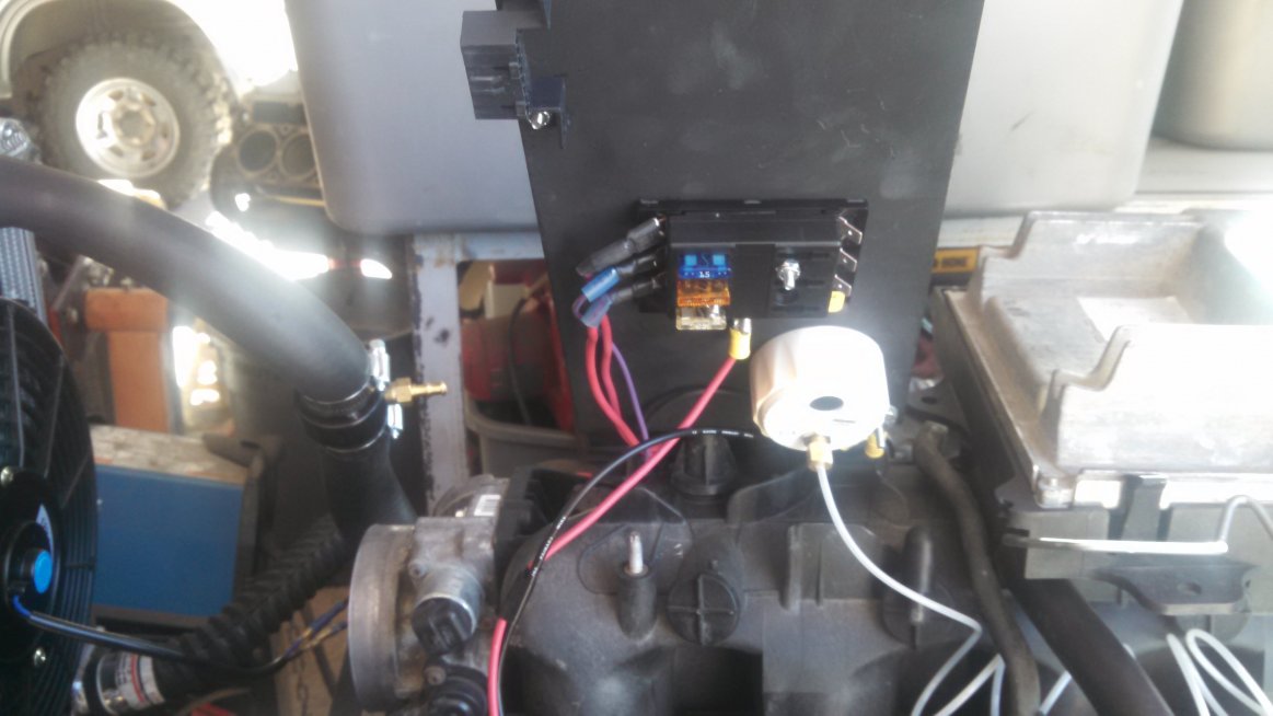

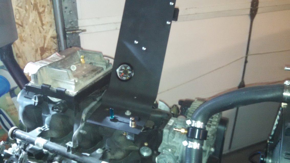

Gauge and control panel pics
I have all the controls, now to make the wires to do the interconnections
1st pic: left top are starter switch, and then ignition switch, bottom fan switch
2nd pic: mechanical oil pressure, fuse panel and then the ODB connector on the upper right
3rd pic shot of the panel mounted
4th and 5th, different angles of panel
in the last pic is a shot of the upper hose coupler, which has a 1/4" NPT position for a drain, which I re-purposed for the steam vent ingress into the radiator.

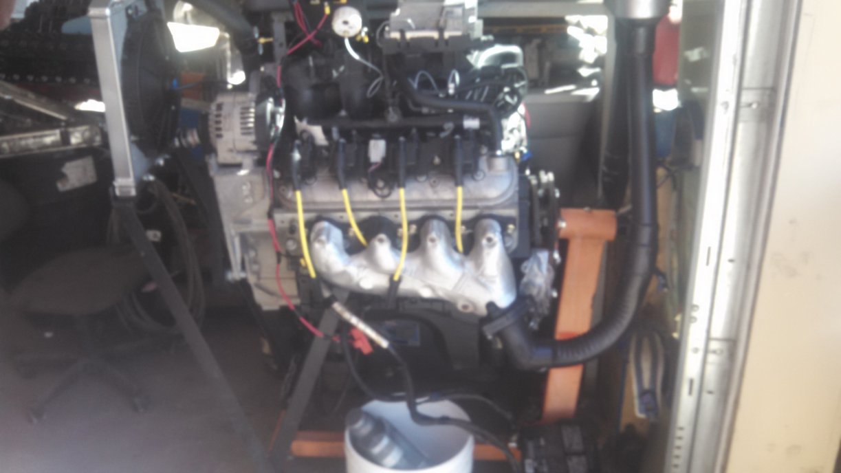

147,000 miles on this engine
got the controls all wired up now, and the oil pressure tube installed
cranked the engine and eventually got 25 psi pressure just with the starter spinning, no spark plugs installed.
Got the radiator fan working correctly (pulling not pushing)
Also took cylinder pressure readings, quite a spread

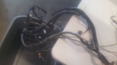

Tonight I begin modifying the harness, which will remove unneeded connectors and SHORTEN almost all leads to fit nicely on the manifold

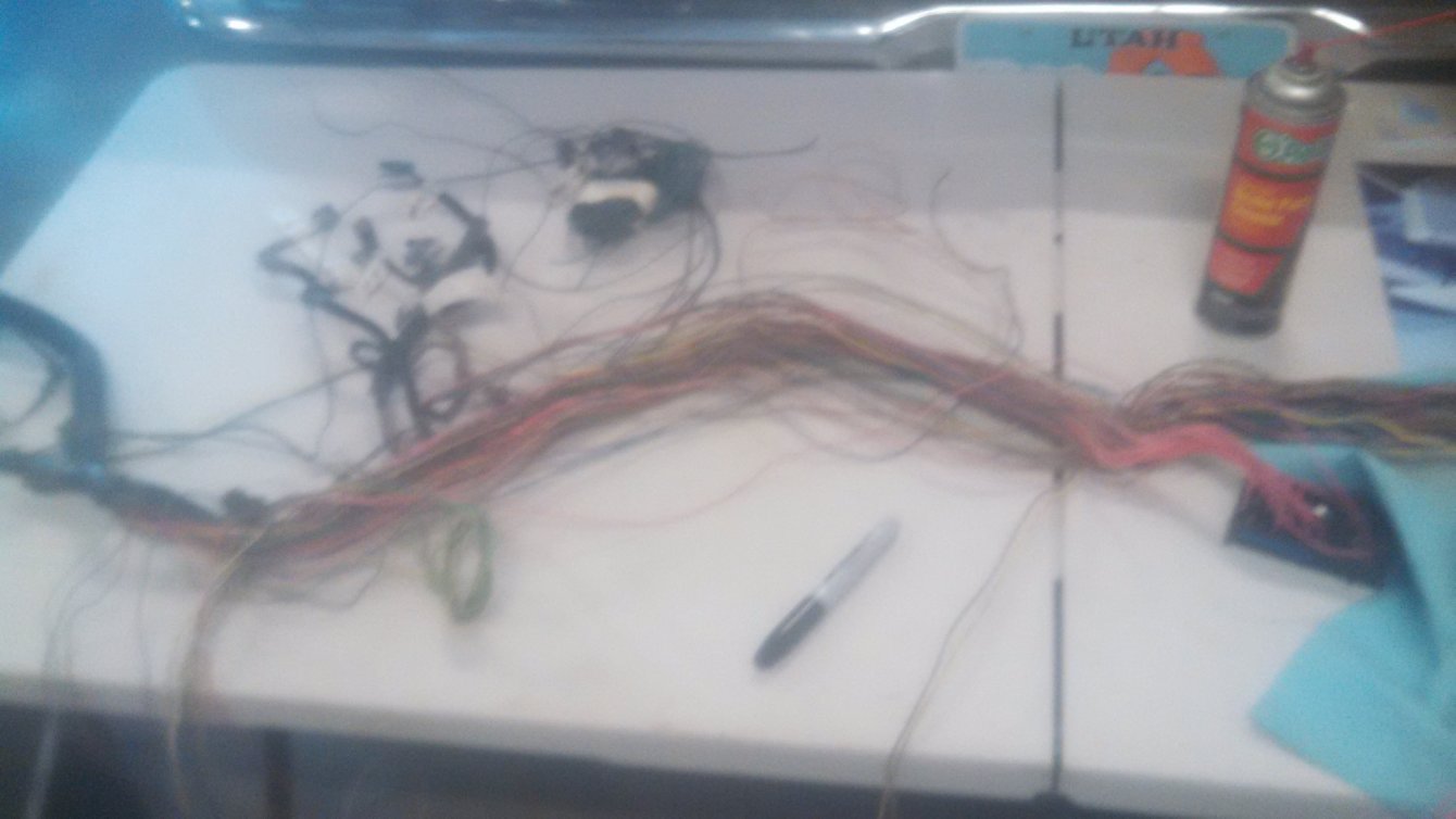

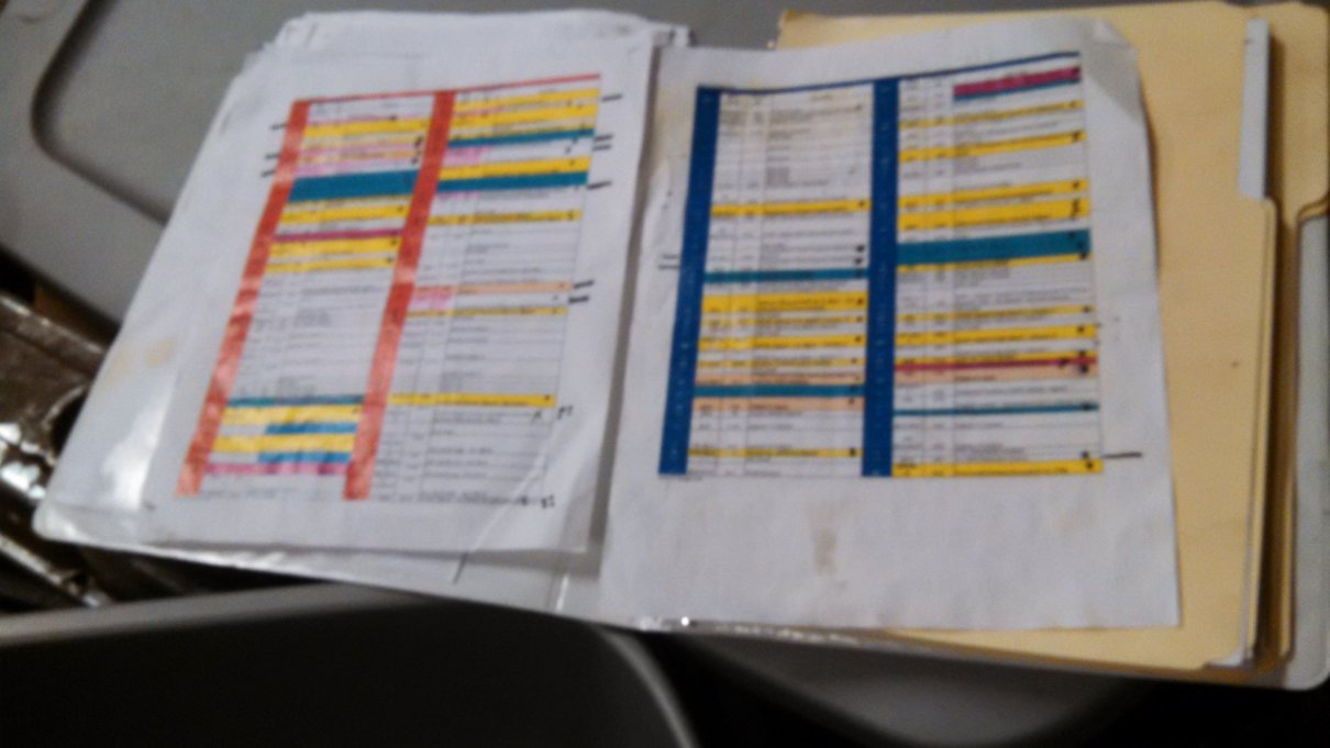

5.3L - 2002 Silverado, rebuilt top end, long tube headers

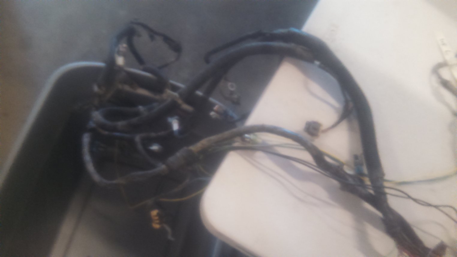

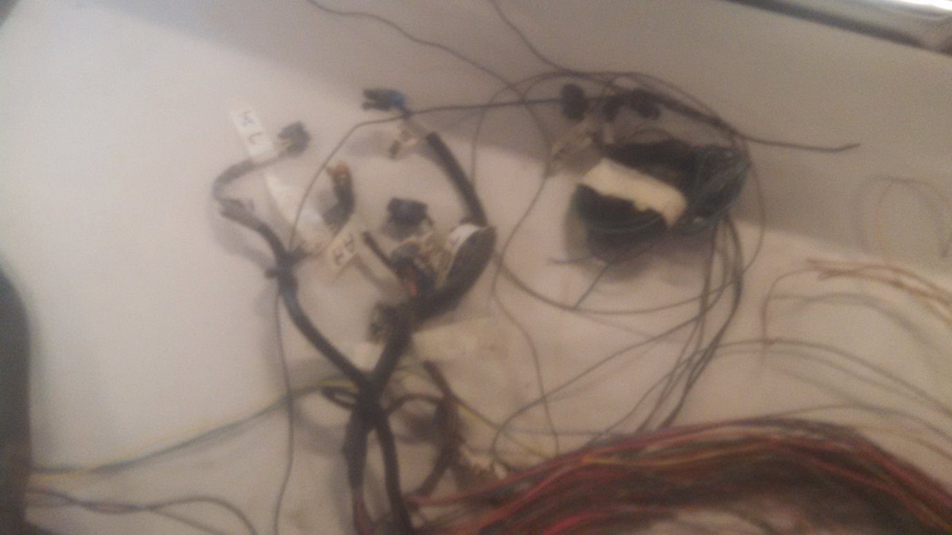

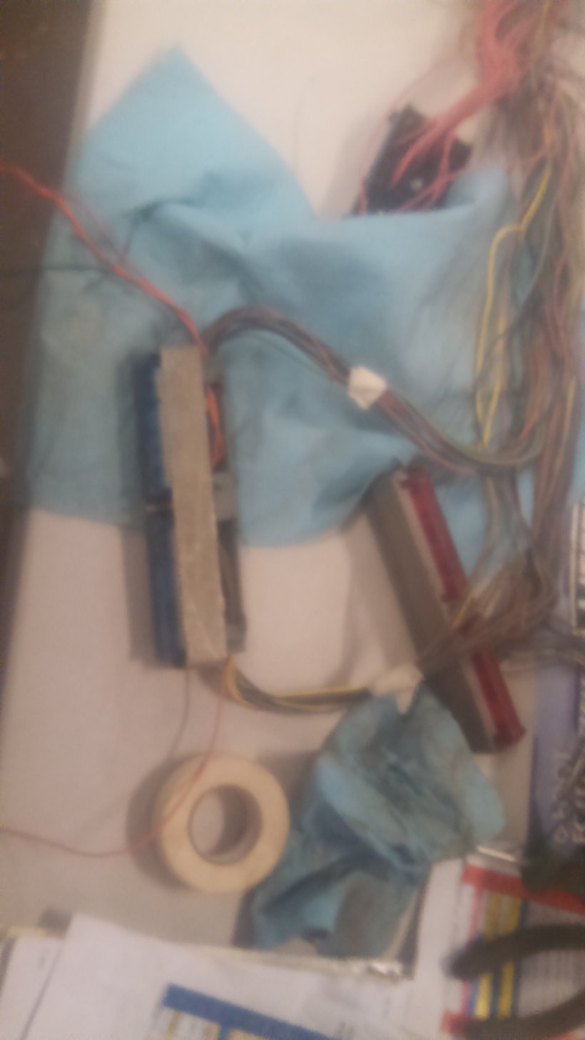

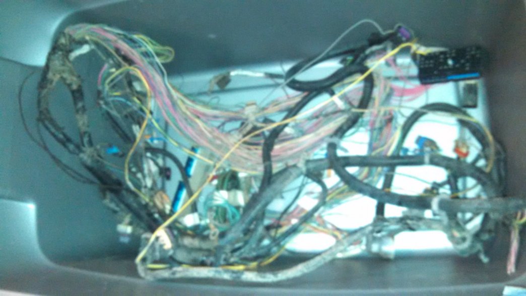

First pic is the really nice reference sheets for the blue and red connectors and which wires stay and which wires go. from www.lt1swap.com
second pic is after I put things away after working on the harness and was about to go home, then remembered I needed to take a pic.
Removed the loom, and the black plastic tape AND lots of mud and grease from the harness for about 1/2 the way back. will use some cleaner and wipe the wires down to get the mud off.
SO began the steps of mod'ing the harness as per the instructions

Worked on harness this morning as well. Picked the blue connector clean of all the wires not needed on this stand harness - not even O2 sensors
harness definitely needs wire by wire cleaning. Brake cleaner and a shop towel works great. As this is my second harness, things are progressing faster and I actually understand more fully what I am doing, lol
