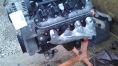

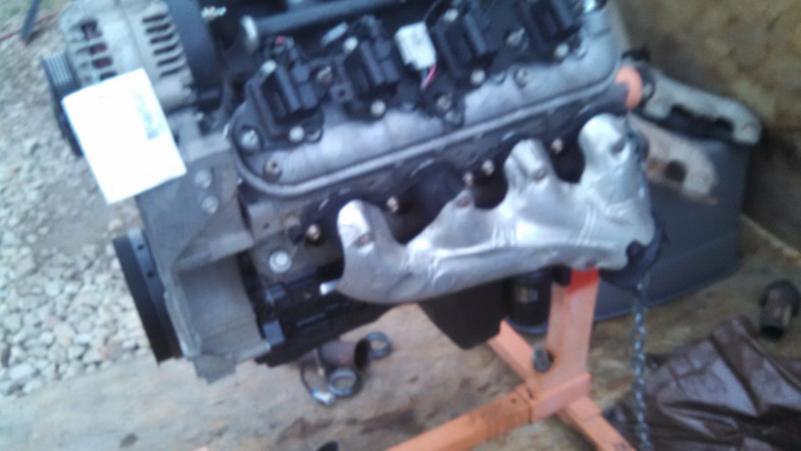

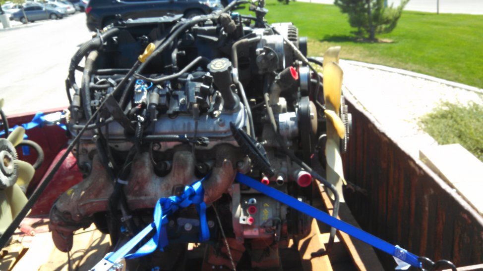

I picked up a 2002 Silverado 4.8L (LR4) with 147k miles on it from a local (salt lake city) salvage yard for $400 (down from $465 when they could not find the MAF sensor). Can't have too many engines.
Don't have a vehicle in mind yet to put it into (maybe a 1987 suburban), BUT I have some thoughts on what mods I want to do this engine in the name of fun. I could leave it as a 4.8L but I want some practice on building a High output engine, so at least I am going to convert the block to 5.3L. This entails swapping the crankshaft, new con-rods and new pistons. And instead of pressed fit wrist pins I want floating wrist pins
Yes, I could just go buy a 5.3L for $700 to $1000 here now, but my desire is to practice (like I said) on engine modifications on the LS.
I have a 2004 5.3L crankshaft I picked up for $60. I have floating wrist pin Gen IV connecting rods (new OEM $200) for the build (.945 dia wrist pins) and now I have the engine. Pistons are yet to come, depending on which bore out I do.
This engine has 862 heads, but I have a pair of 862 heads I am in the process of porting and installing 2" intake valves and spring, etc upgrades. So I will use my heads.
Sure the 5.3L could have power, but am now ready to build a 5.7 iron LS engine, NA and generate some power I never have had before and learn in the process. With the HPTuners package I look forward to learning how to tune it or blow it up in my mistakes.

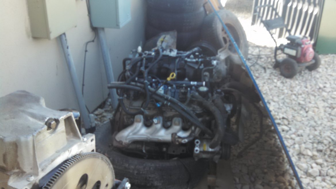

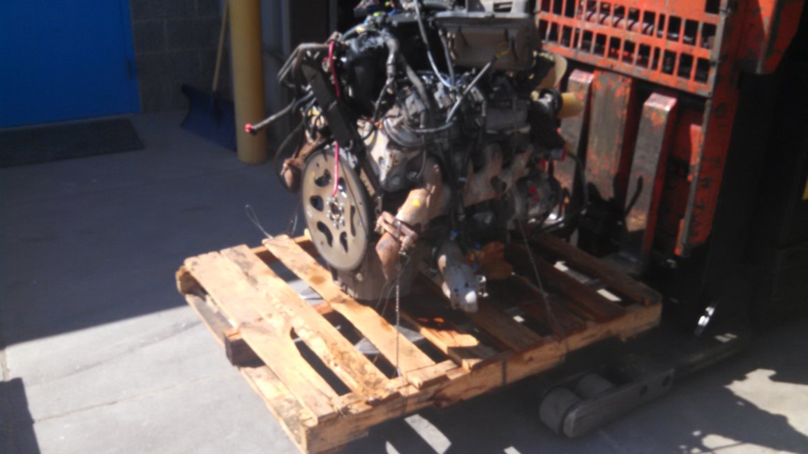

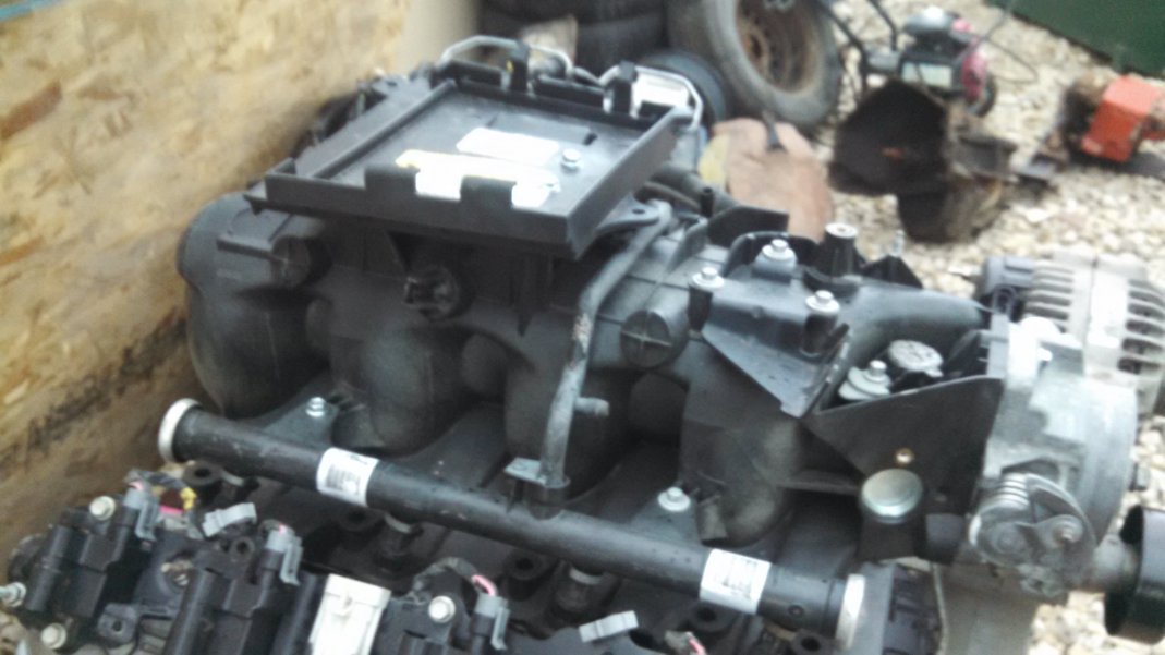

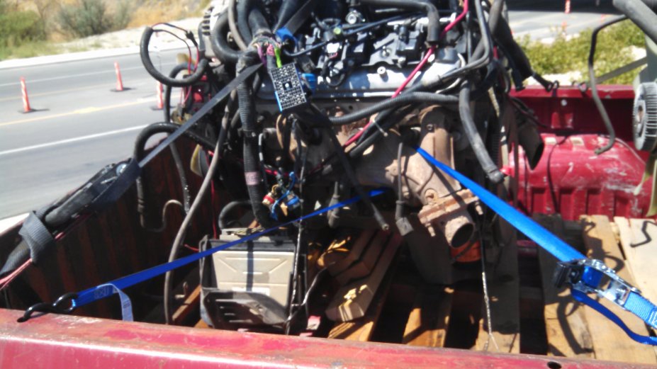

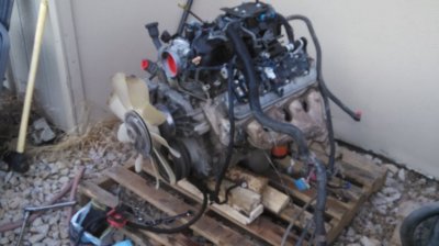

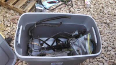

Pics at yard pickup and taking the accessories off. Next step will be to clean the outside. As per Mark Burch (aka AGearHead4Life on youtube and facebook) I will use Purple Power and a Hi-pressure washer to clean the outside. I have released all the valves by loosening the rockers thus closing all valves and protecting the cylinders from water then putting the covers back on. I will plug the various holes/vents and clean it on a engine stand.
If this is interesting to others I will continue on it over time - which will be many months

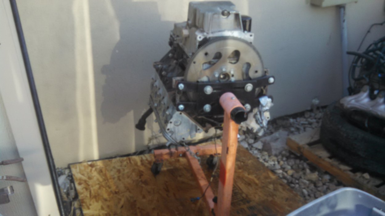

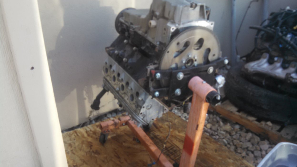

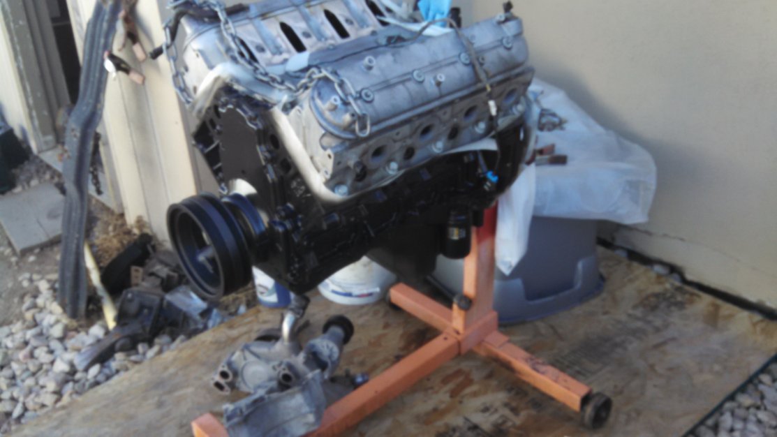

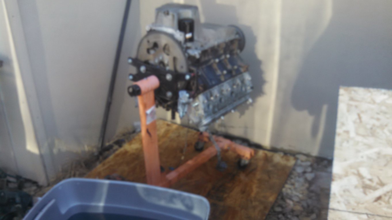

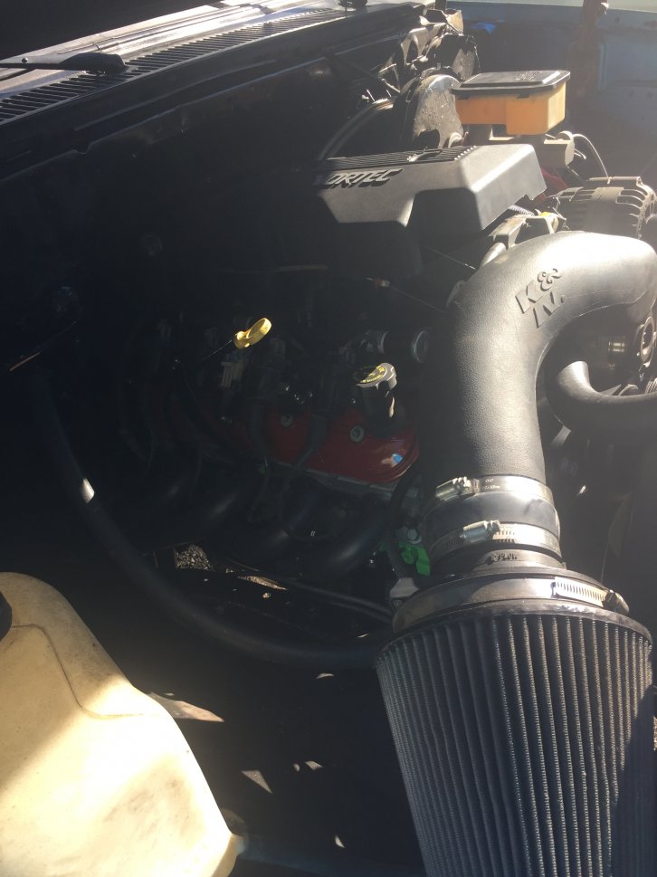

Over the weekend I cleaned the outside of the 4.8L engine, this morning I did another coat of degreaser, Purple Power. I am going to buy some Zep 505 industrial cleaner from Home Depot and see if that will attack some harder dirt sections.
Here are pics as of this morning (I do this in the morning before going to work and then work into the evening at work with AC and not fight the heat outside) - seems the pics are not as clear and they usually are.
The last pic is Jake's 4.8L I picked up at the same time as mine. It is at jake's shop and parking where my rigs are at.
Here is the link to Mark Burch's method of cleaning: https://www.facebook.com/AGearHead4Life/photos/?tab=album&album_id=901268526593443&hc_location=ufi
NOTE: In taking all the outer stuff of the engine, I found 3 broken coils. Darn.
last pic is of Jake's 4.8L - its his place I am working on this and the truck

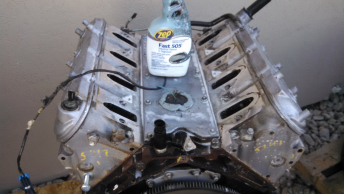

This first pic is after cleaning with purple power cleaner, but before using the Zep Fast 505 cleaner and before attacking the engine with the power washer (before it quit). All those black marks on the face of the head intake runners are now gone. Should have taken a pic after.
After it is cleaned and painted, I will clean the intake, and other outer parts and re-assemble. THEN will build the starting stand frame and finally start the critter up.

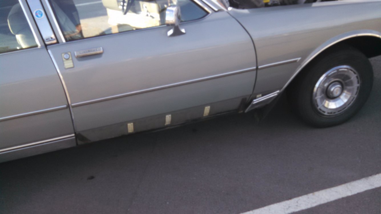

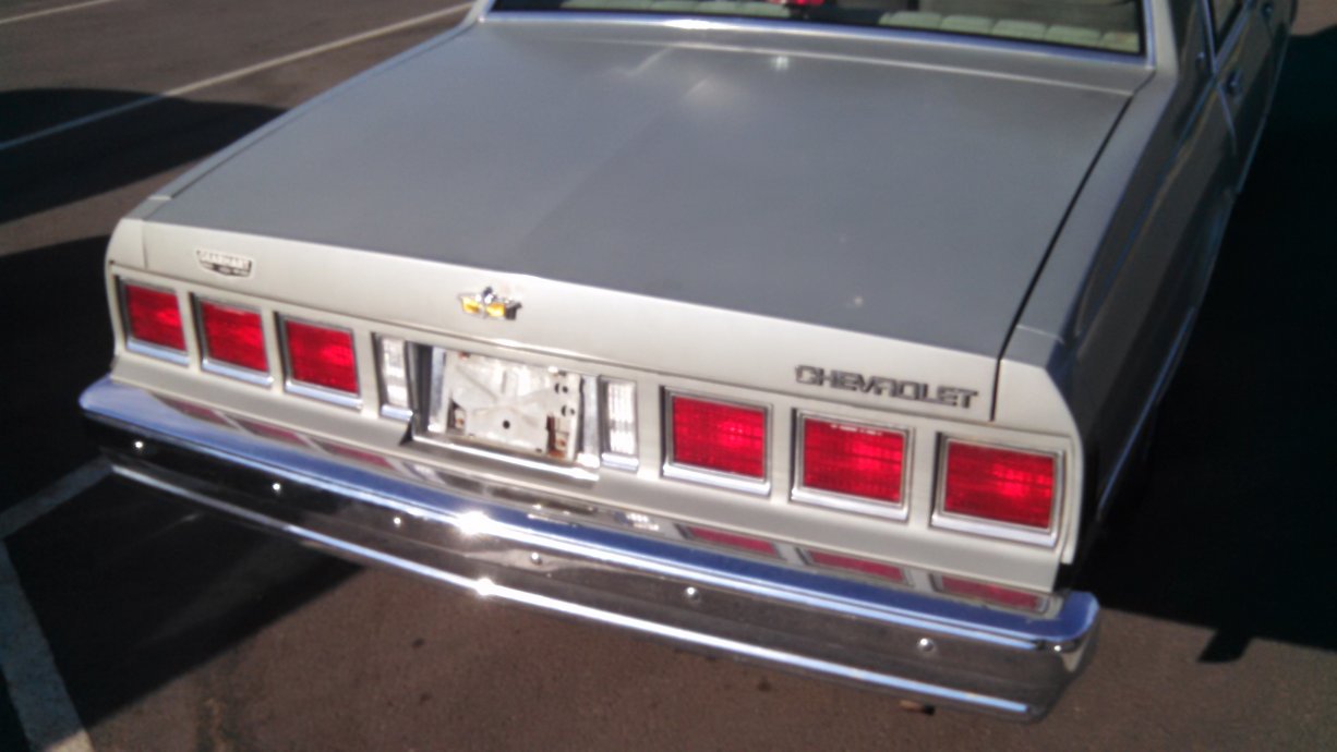

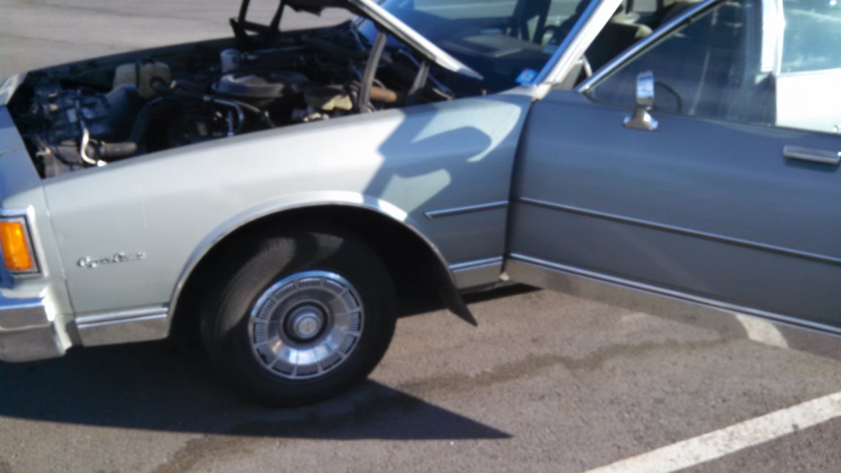

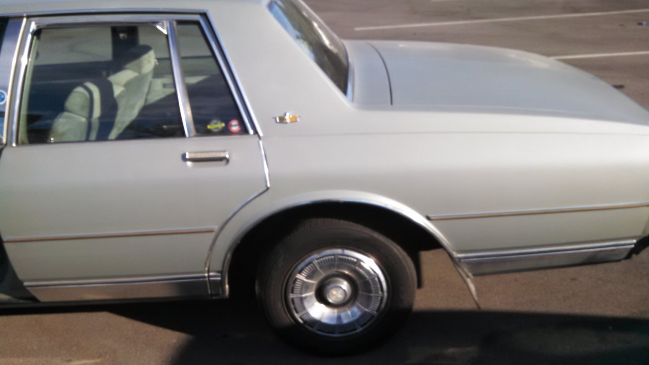

I will now show the car I aim to put this engine into: a 1983 Caprice Classic with 101kmiles on it (with a 700r4 transmission) and it cost $450.
Very clean body especially considering it came from New Jersey. 84 yo man was on a trip from NJ to California. Had repairs done in Denver (new fuel tank, partial new exhaust, new water pump, new AC compressor, some hoses). Then on the return trip to NJ while approaching Salt Lake City blew a head gasket. Radiator had been leaking (and it is plugged with deposits). So the guy sold it to a Goodyear repair station who advertised it after getting the title and that day I saw it, I bought it.
Plan is to repair the head gasket(s) and replace the radiator and run it as is until the engine is done (after the winter). Goal is a high horsepower engine to put in this beauty of a car as a sleeper. I know its not a truck, but it is of that era. The guy MUST have had it in the garage most of the time. Image 3,000 miles a year, and clean (well bottom inside of doors have issues, but I can put Chassis saver on those). The car could not handle the long trip because of lack of preventative maintenance. The passenger door is missing a chrome piece, but other than that, nice looking. Interior is awesome
Anyway, this thread will deal mostly with the 4.8 enhancement. Just wanted to share where the engine is going to end up in.

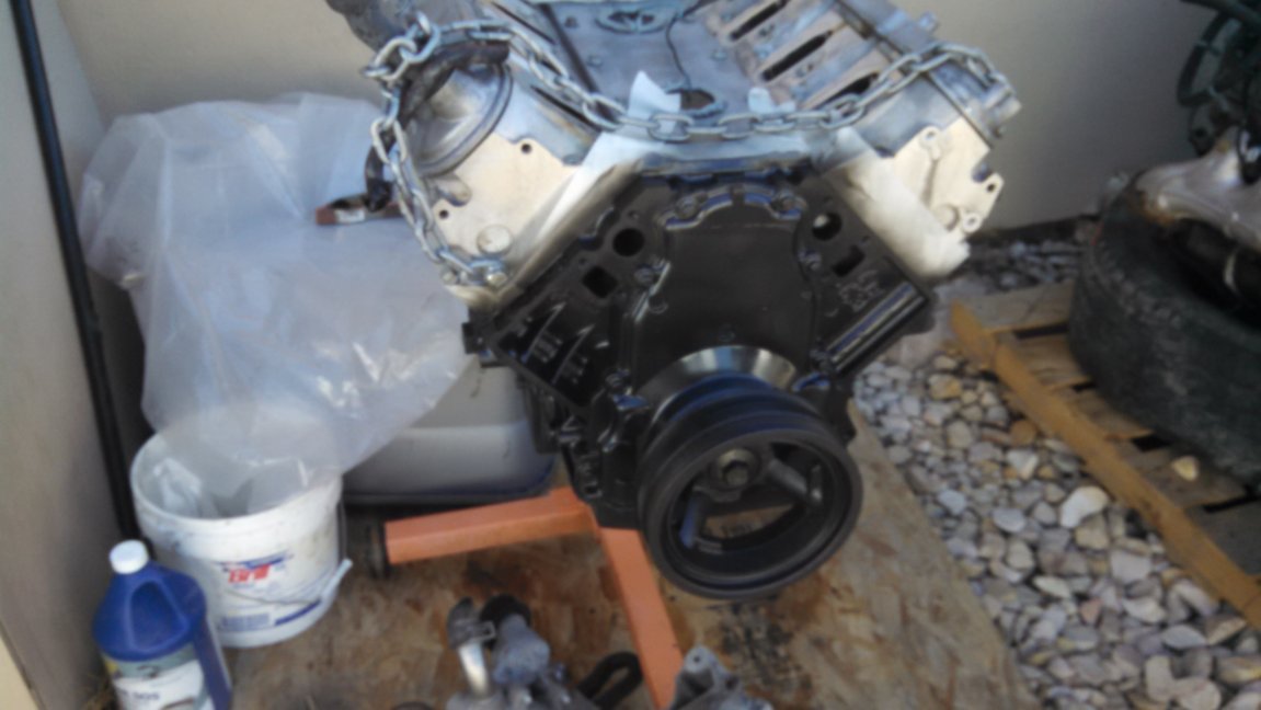

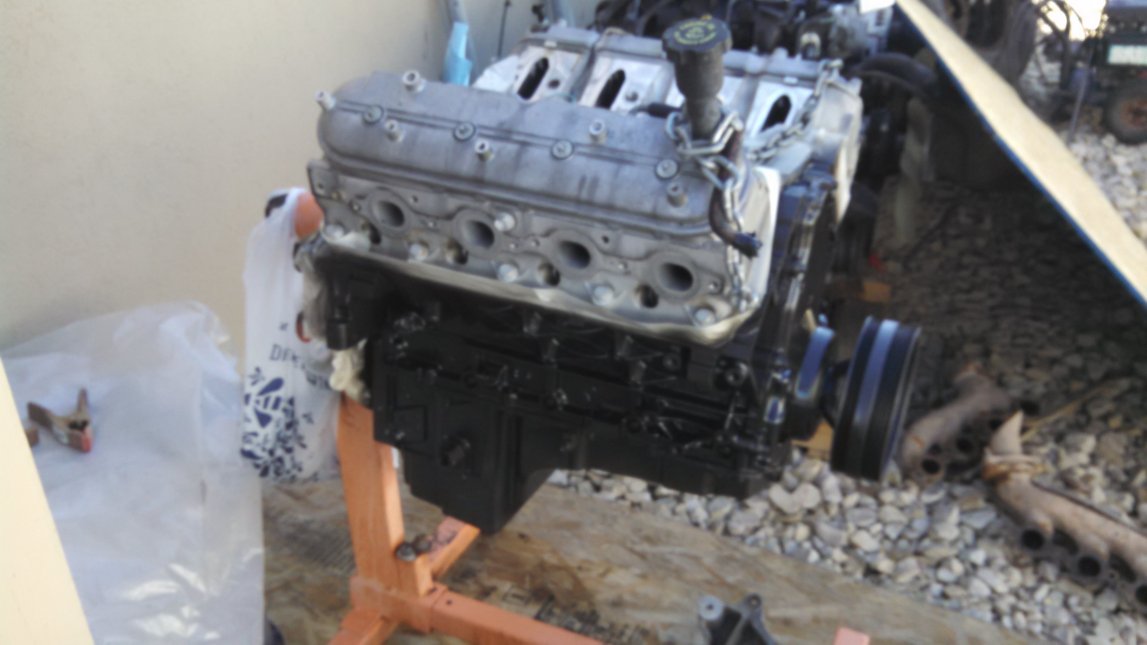

Engine cleaned up and then painted this morning with a 1st coat

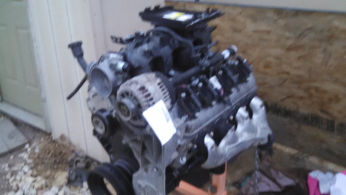

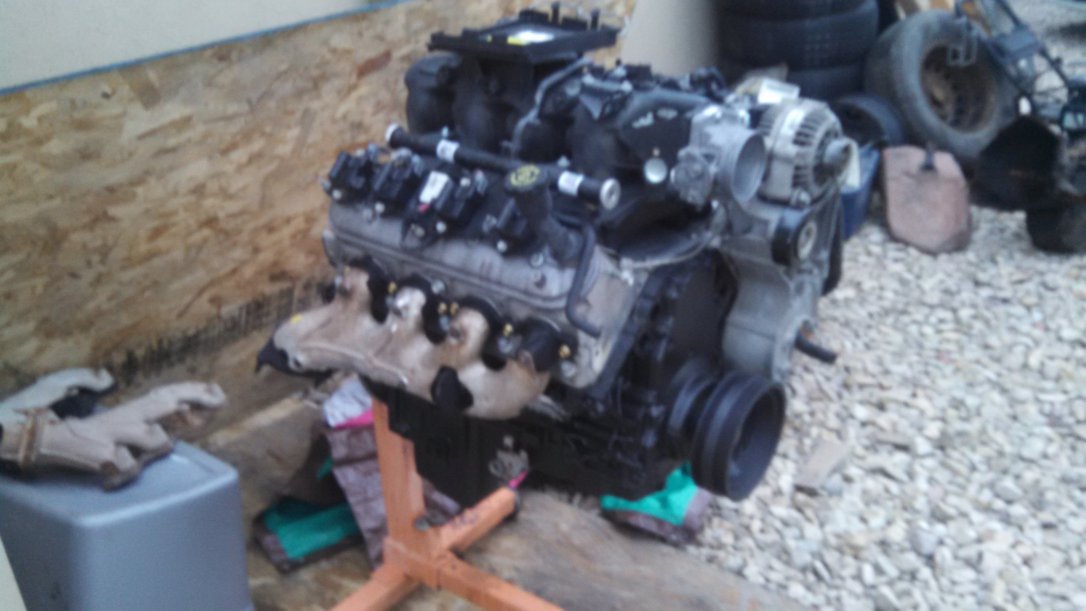

Re-Assembling the cleaned parts and new items for the start stand demo
I am not a photographer. I held the camera steady but still get blurry pics
Yes, the ECU will fit on TOP of the intake for the Start Stand
