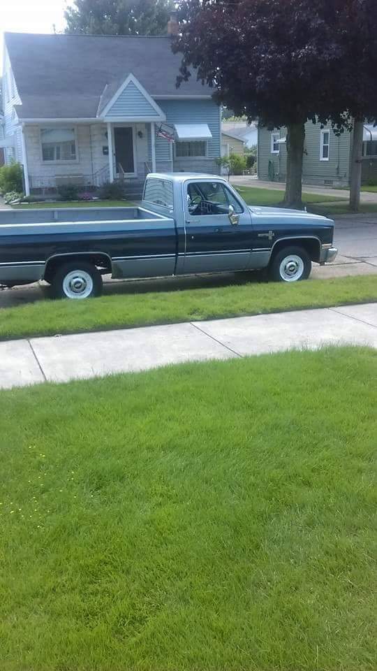

I have a 1984 Chevy scottsdale c10 2 WD I'm looking for around a two inch lift I heard to put coil springs up front 3/4 kind then in the back add a leafs and air bags then I heard body lifts I'm not into a body lift I need your guys help also wondering what size tires would look right on it I was thinking 265/75/15 and I'm new to this group

Maybe you guys can help then here's the thing I actually want it stock but right now I have a hot water take and some scrap steel in the bed if I push the bumper it will go all crazy but the thing is is its original shocks and I need this truck to tow a landscaping trailer a small boat a truck bed camper how can I get my suspension stronger. But same ride height

My front shocks are coplasped when I did a oil change the front shocks went smaller and oils coming ouagain original shocks so what you guys think start with new shocks I was thinking air shocks in the back when I load it I can put air to leaval it out and then step up to a 265/75/15 tire
