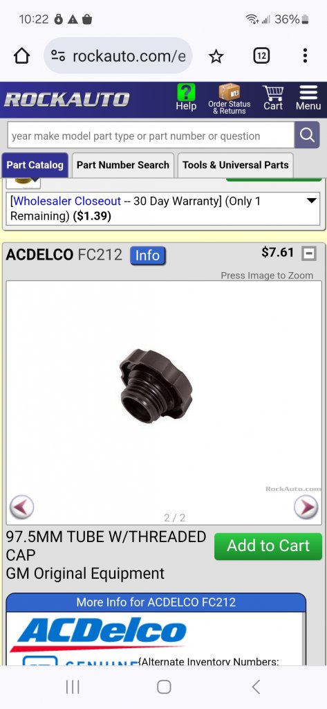

Bloodhound1981
Nov 15, 2016
157
288
MA
Rusty
C-10
Here's what I got. These are Vortec heads fyi.
