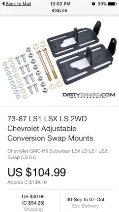

Let me look for a pic....i found these on Ebay for $100.

Isnt that what these mounts i boyght are for? I thought the 4.8 mounts stayed where they were on the engine then these went from the mounts to the frame?

The mounts you bought bolt to the frame stands. The V6 and V8 frame stands are different, so you will need V8 frame stands to bolt up the dirty dingo mounts.

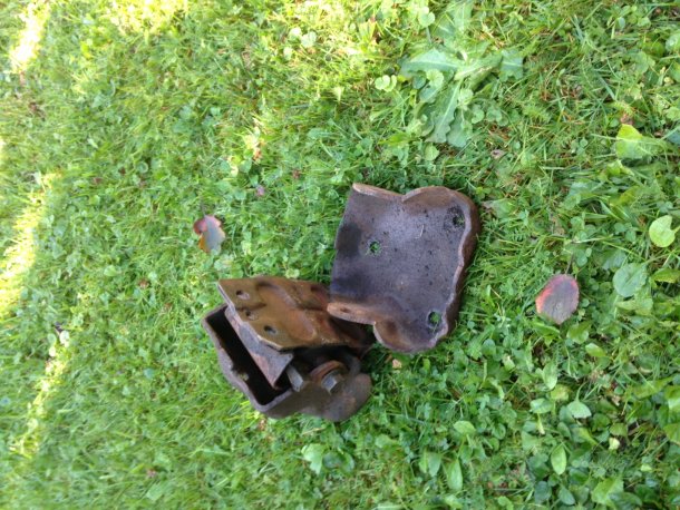

r10
4.3 tbi
Was just out digging through the shed... Thought i might of had a set off a 79 k5 blazer i had for parts... Could only find the motor mounts, just looking at the v6 and v8 mounts they look identical from what i could see, you sure they wont bolt up? Oh yeah.. And a few pics

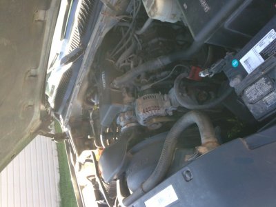

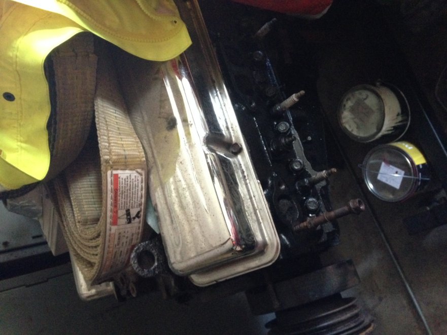

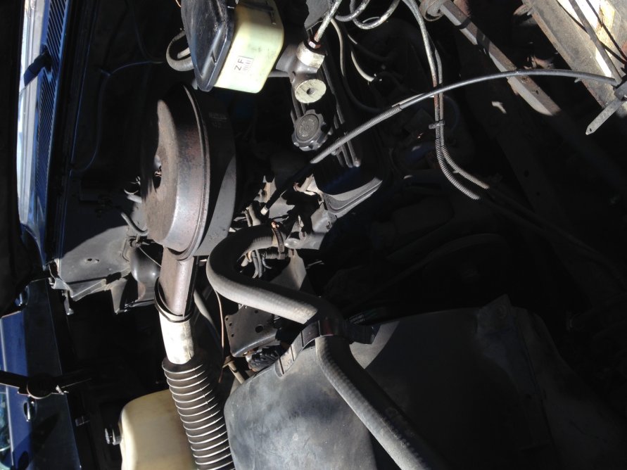

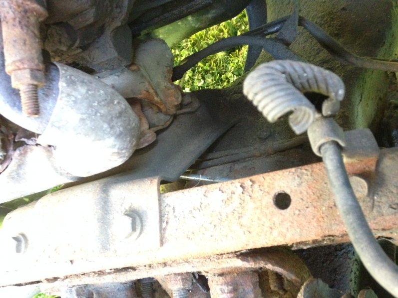

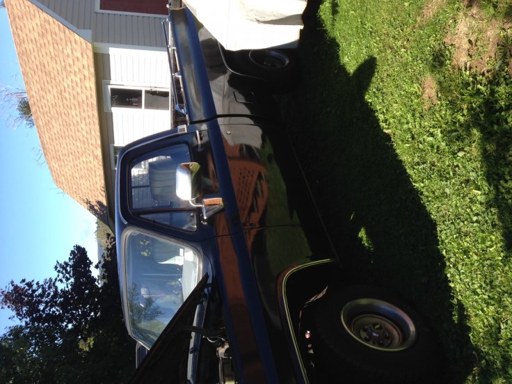

r10
4.3 tbi

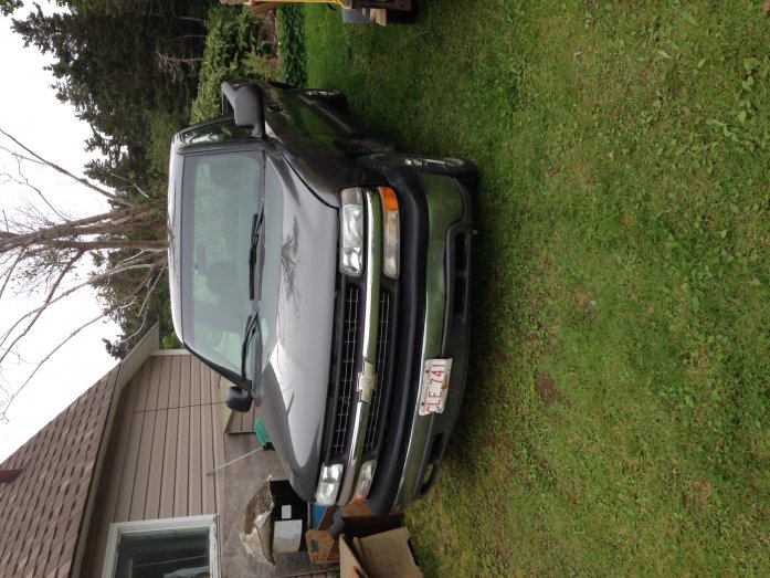

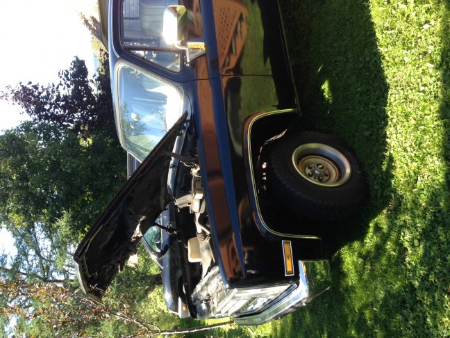

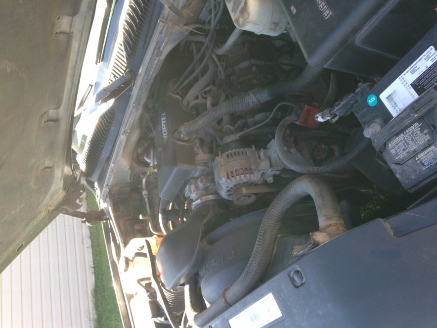

pics of the 87 chevy r10 SWB with 4.3 tbi , the 350 4bolt main i had planned to convert to tbi but lost interest, my 2000 chevy silverado 1500 4.8 vortec i have for a donor truck(74k miles), the interior of the 87- leather buckets seats that were in the garage.. not sure what they came out of.. the motor mounts for the 79 350, which are a 3 bolt design which looks very close to those on the 4.3
sorry about the pics being sideways... not sure why, when i open them on my computer they are straight
They may work, it's worth a shot. I think they may be bolted to a different location on the crossmember though.
