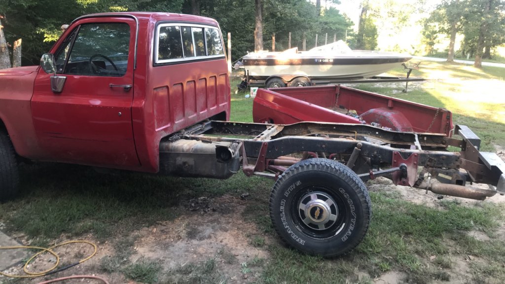

I was going to take the truck for a drive today to see how it rode but there’s a clunk in my steering, I don’t know if something is in a bind or if I just finished off my drag link. The clunk makes the entire front axle move. That’s what makes me think something is in a bind, but the drag link piece is completely blown the boot on each end and it moves easily by hand.
9,434
17,293
Your last round of pics, I "might" look like the drivers side frame is tweaked up a bit? Honestly, as long as you can align it and it drives straight, probably noone but you (and all of us!) will know.
IMO, the only way to diagnose steering issues is to have someone who can turn the steering wheel for you, as many times as you need to stare at it and figure out which pieces are loose or worn or binding up.

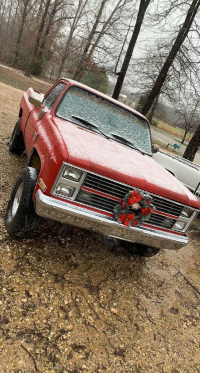

I know nothing lines up lol, my drivers side door hits the fender and the top is in and bottom is out and I fixed it but the door seals were flat so it was windy beyond reason so I pushed the top back in. I don’t know exactly how the fenders and stuff move around, but I know the hood on drivers side is either up or the fender and stuff is down because there’s always a gap and meeting a semi on a windy day is scary not gonna lie lol. Hood wobbles a bit. I don’t know how much dad removed from the frame when he put it all back together but he said he painted the frame when he had it all torn apart, cab and all I don’t know. I know bed bumpers fenders and hood were off at one point but I don’t know about cab, I know I’ve had the bed off and it is slightly off too I can’t remember which side but I kinda wanna say it’s sitting out the passenger side too but I can’t remember. I’ll try and show a pic with the bed off. It’s really not a bad looking frame lol. And the second photo is where you can see the bed is slightly off. Maybe the cab is actually off center? Is that a possibility? Maybe the bumper and axle are center but the cab and fenders are off center?
That was my thought
9,434
17,293
^ That's a real possibility. Straight chassis, tweaked body. But one of those pics I looked at looked like the bumper aligned well side to side with the fenders, maybe not.
Either way, even with the bumps n bruises, it's a good looking truck. But for the love of all that is right in the world, don't put 12" wide wheels on it! LOL

I mentioned it to dad and he said we need to set up a string line and make measurements and see what’s actually off but now that you mention it the Frame is bolted to the bumper or well other way around but, and the axle is in a set position as well, but the fender are adjustable. I may checkout all of my body bushings and stuff and look into replacing them and see if that’s the issue. Do the fenders have bushings of any sort? I’ve never done body work to this extent so I honestly don’t know what all goes into removing the fenders

Edit: no the bumper is off to passenger side some, it sucks when waxing the truck because I can’t fit my hand between the drivers side fender and the bumper but on passenger side I can fit my hand with wiggle room.
