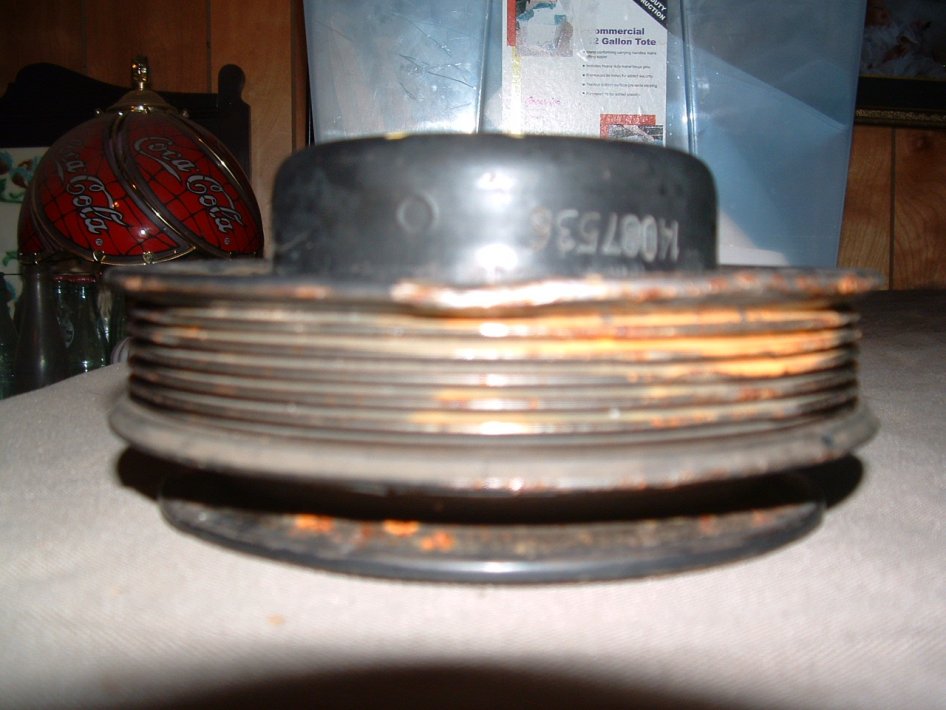

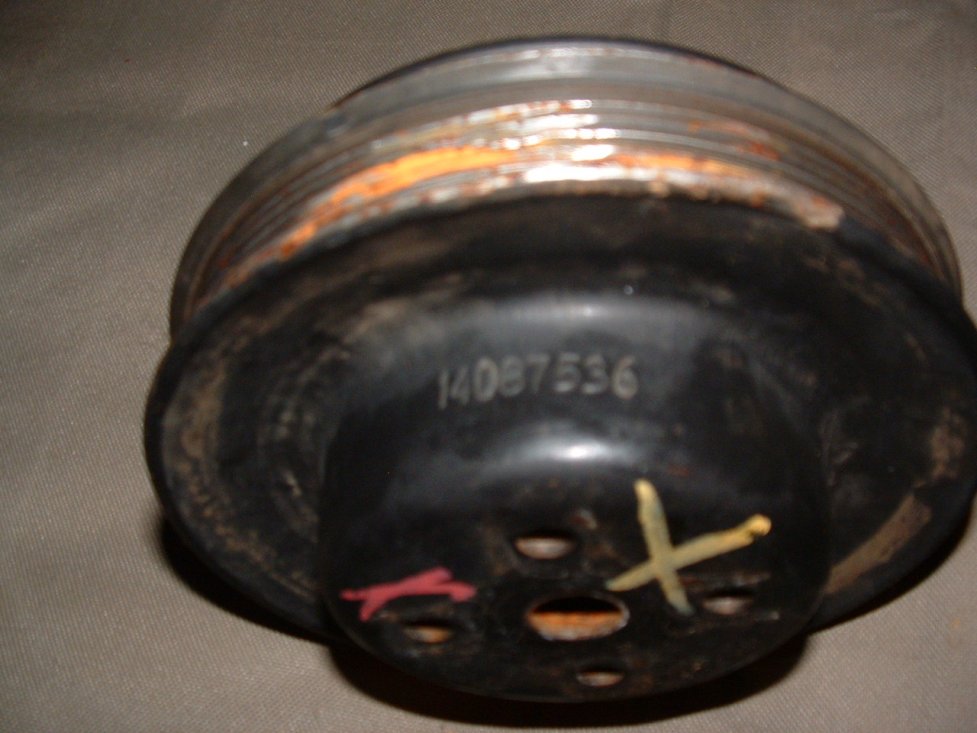

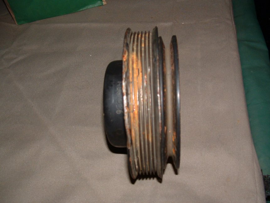

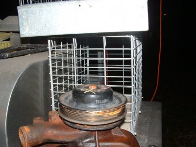

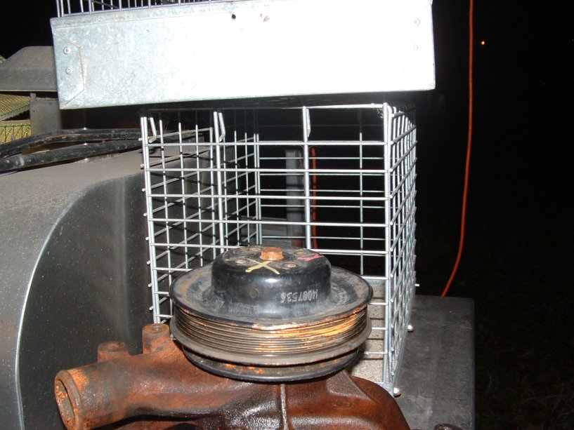

Pictures of water pump pulley I'm looking for. Contact me if you have a good one to sell and what the price is.

Yes I did, and it worked fine. I had so much trouble finding a replacement pulley, and some people had asked for pictures.
When I finally got around to posting the pictures, I thought I would let people know that I was still looking to buy this pulley because it never hurts to have a spare. I have been looking for almost half a year for that thing.
