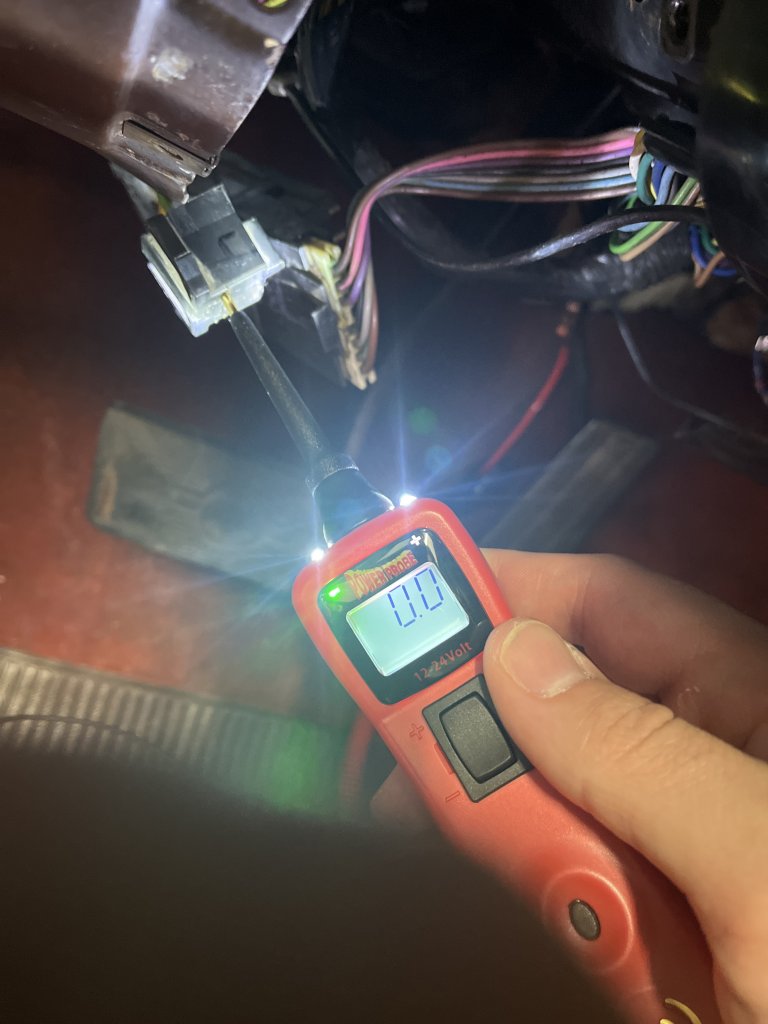

Update for anyone following along or that might have this same issue down the road.
I used a power probe.
I’m getting 12 to H/L switch
If I send 12v from the H/L switch pigtail it will turn on either high or low beams depending on which color wire.
The kicker though- my power probe is telling me that without 12v applied, both the green and tan wire are connected to ground. Is this accurate? Or is this reflecting a short-to-ground? If it's a short- I'm surprised that it's both wires. Any ideas on where to start looking?

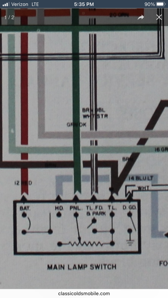

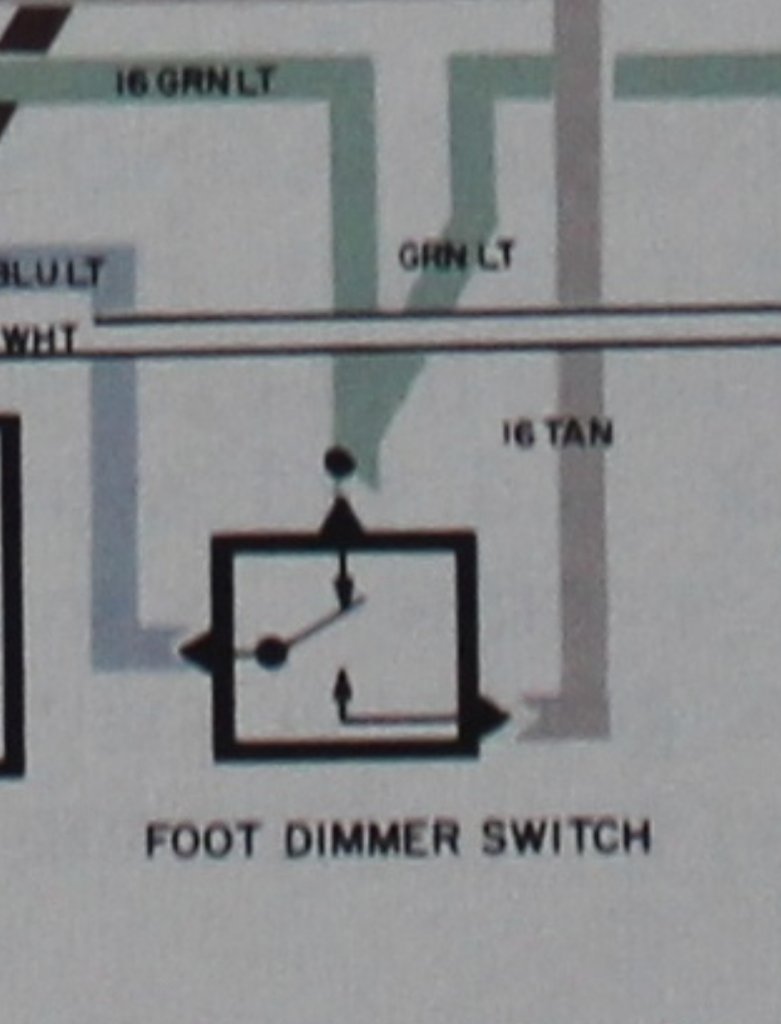

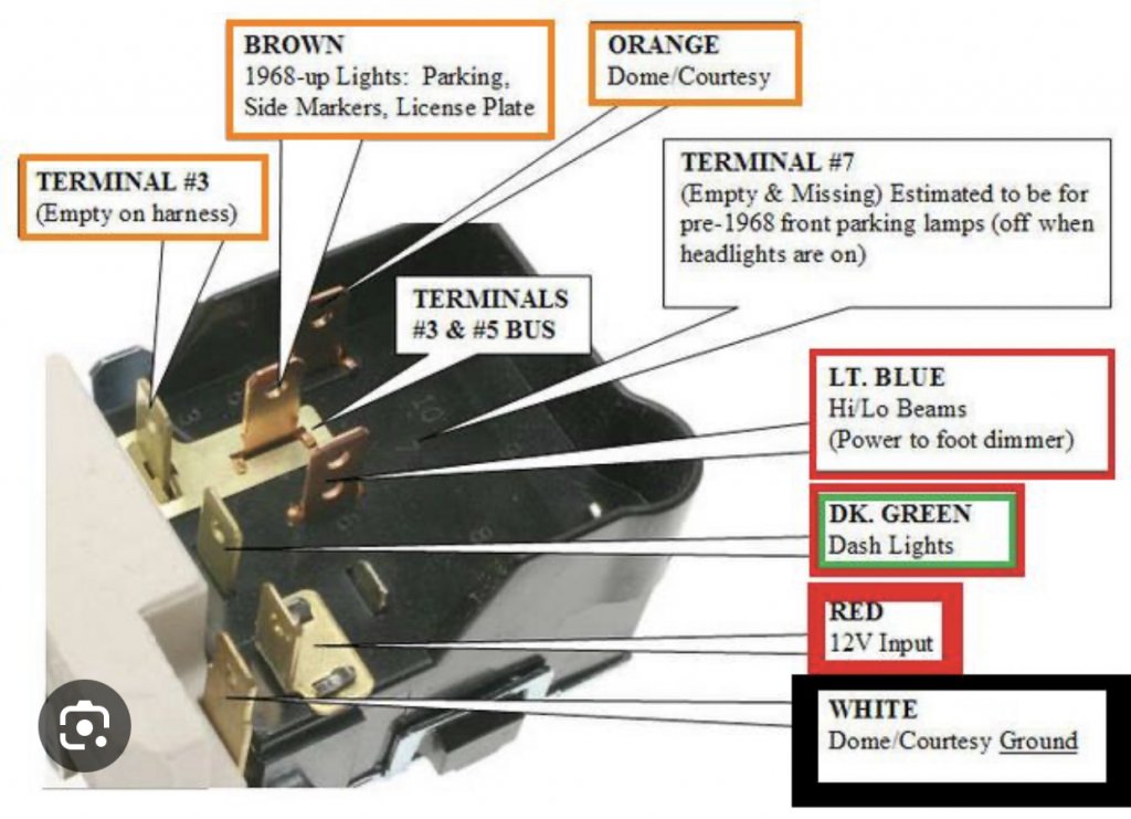

I assume you mean you have power on the large red wire at the headlight switch?
If you study the diagram, power comes in on the large red wire. With the park lamps on, you should have power at the brown wire (parking lamp feed) the green wire is dash lamp power, it goes to the dash lamp fuse and comes out as a gray wire. In this diagram, headlight power is blue, on a squarebody truck of your vintage im almost positive it’s a yellow wire. It comes out of the dimmer switch as either tan or light green. White is courtesy lamp ground.
For testing purposes, take a FUSED jumper wire (10 amps would be enough I would think) and jumper the red to yellow wire. See if the headlights work. If so, replace the headlight switch. If not, jumper the red wire to either the tan or green wire at the dimmer switch. Either the high or low beams should light.
