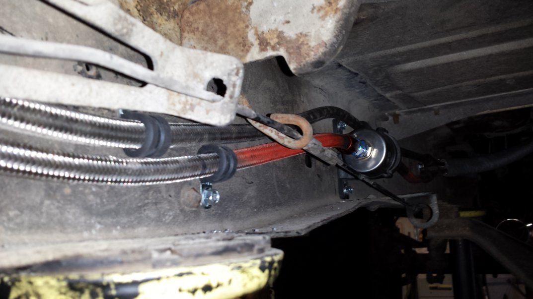

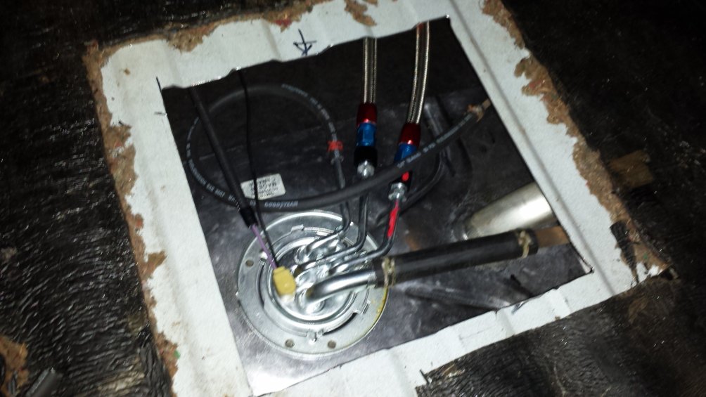

Fuel system upgrade

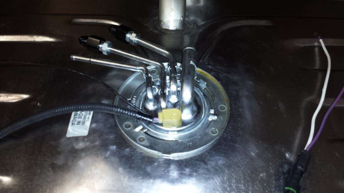

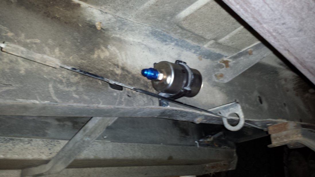

Got the fuel tank dropped out. Bought a new 31 gallon tank for a '87-'91 k5 as it's baffled and dropped in a new fuel sender for the '87-'91 k5 and an AC Delco ep381 In tank electric fuel pump. Also got the fuel filter mounted to the frame rail, OEM filter for my engine (2000 Silverado). I'm also going to be using 6an stainless braided fuel lines for the supply and return lines.

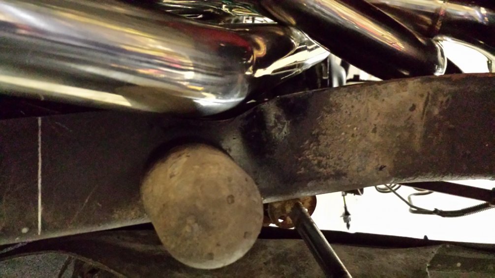

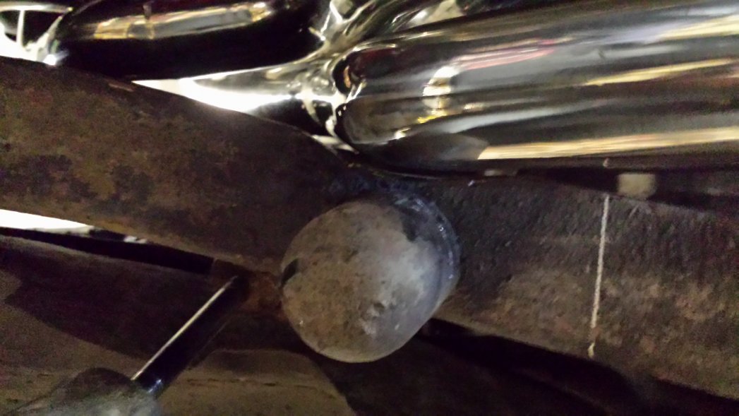

Headers
What headers are you using?

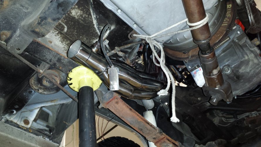

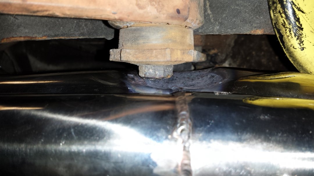

I bought a set of eBay headers for a 2010 camaro after seeing a guy had fairly good luck with fitment. I did have to do some work to both frame rails, removed a 1/4 or so right by the bump stops and also the top of the frame on the passenger side. I also had to heat and hammer in a spot on the drivers side header as it was hitting the rear shackle bolt, picture below. The passenger side I had to weld in a new o2 bung as the sensor was going to hit the drive shaft.

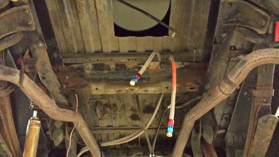

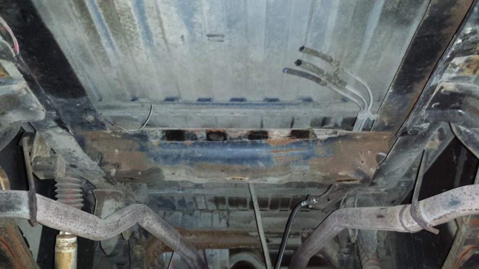

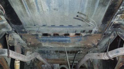

Fuel system is in
I got the fuel system completed today and tested for leaks, luckily there aren't any. I also cut out an access panel in the back in order to get to the fuel pump easier in case of any issues down the road.

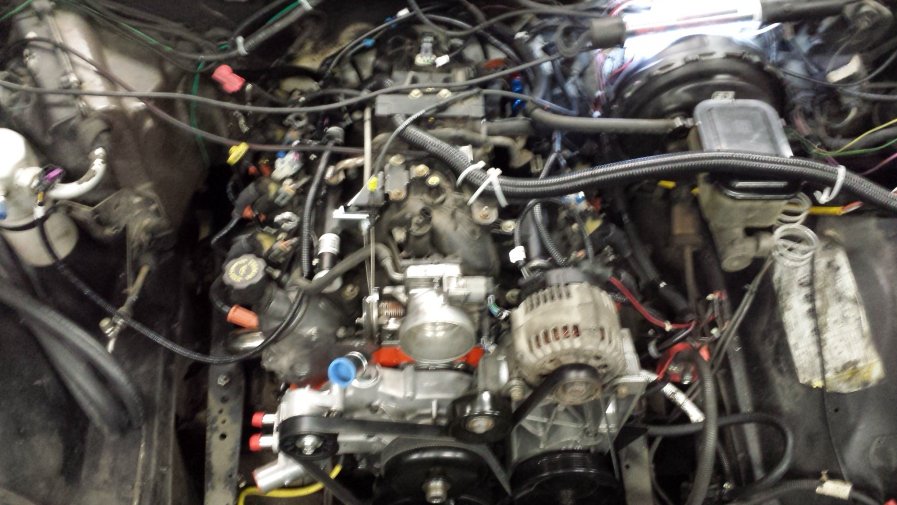

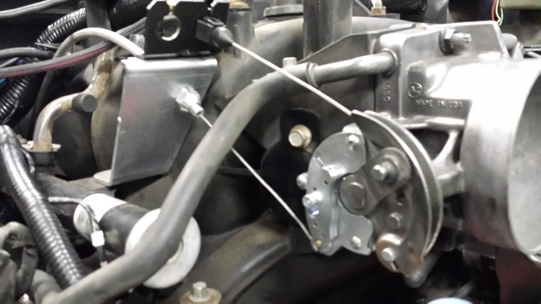

Harness is in place

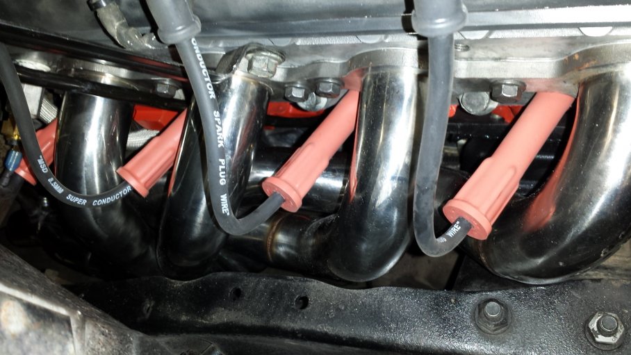

I also got the harness plugged in along with the coil packs and spark plug wires. Still need to tie in a few of the wires before I'm ready to fire it for the first time. I also have posted below a few photos of the bowtie TV cable setup and headers showing where the frame had to be grinded down.

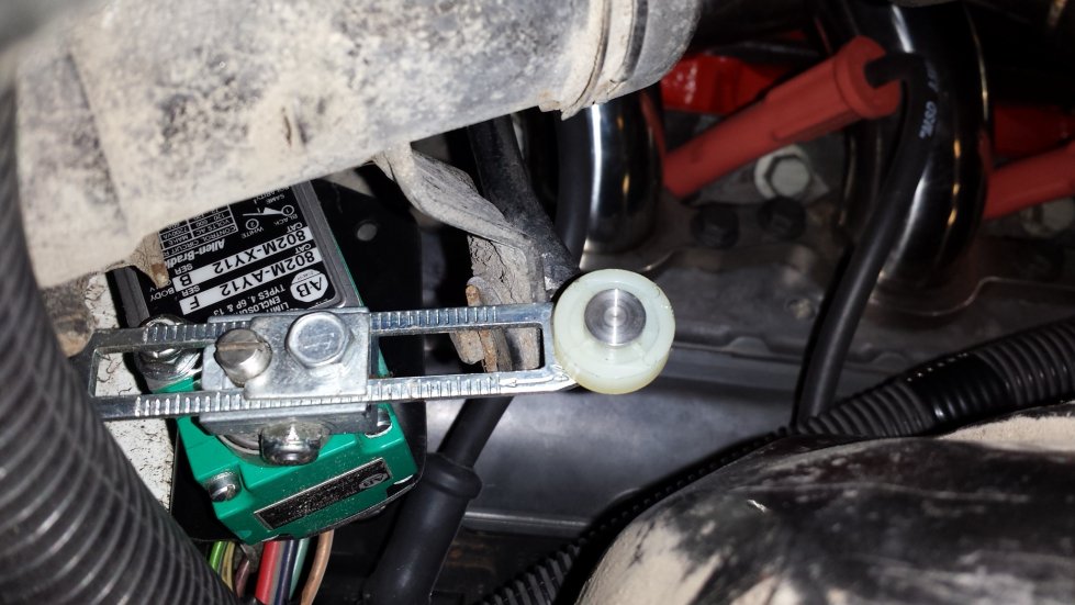

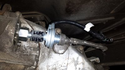

This is a photo of a switch I put in for the PNP signal wire (sorry the photo is upside down). This was tricky but I wanted to run it so the ecm at least knows I'm in either park or drive. I'm not worried about neutral as I will never be starting it in neutral. I got a heavy duty waterproof commercial switch and made a mount for it and attached it to the firewall. The lever on the switch hits the gear selector lever on the column when in park. Also a photo below of the Dakota digital vss generator attached to the transfer case in line the the mechanical speedo cable.
